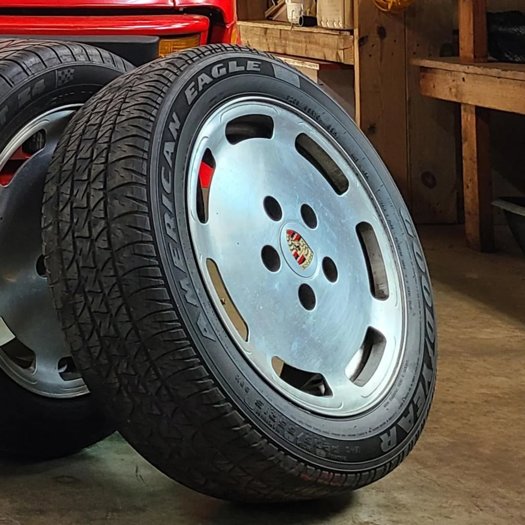

Need to replace the old Aluminum lugs on my 944, a some survived but probably 10 of the 20 on the car will not be seeing the road again. 8 of the survivors are very corroded. I've got the 928 sewer lids on my car which are aluminum. I'm thinking of replacing it with steel but I wanna make sure the steel lugs don't corrode-weld themselves to the wheels. Any recommendations on a reasonably priced set of lug nuts and/or locking lug nuts?

A decade-plus ago I had a set of VG S4+ manhole wheels re-anodized at a place on SoCal to restore the surface to new. I'd carefully stored the original wheels for my car with the original tires, and clinic visitor noted how his own wheels looked so much different. His had been cleaned with a mild-acid wheel cleaner, then treated to a mild abrasive polish to try and resolve the damage from the wheel cleaner. It looks like the wheel you picture has enjoyed some similar polishing/cleaning sometime in its past. So his were restored to new appearance. If your quest includes originality, there are places that can do it for you. The result is a satin gray finish that won't tolerate anything. The original recommendation from Porsche was to coat the anodized face with a film of Vaseline. Very practical...
