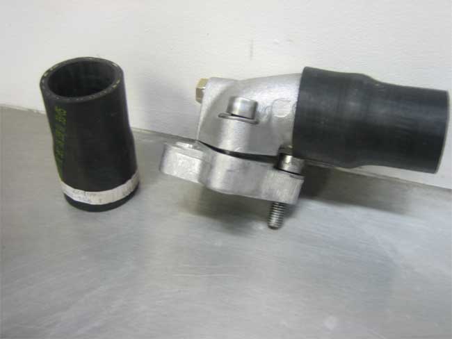

ooks like a nice clean job! Congrats! I'd just be on the look out for any signs of a head gasket failure, just to make sure yours sealed ok. Some head gaskets need to be re-torqued after the initial heat cycle. I don't know if that applies to the gasket you used, however. I saw your other comment about the water neck, and wanted to share this picture showing one possible reason. The factory originally spec'd a low-profile head for one of the bolts, to prevent the neck from getting hung up on the bolt head and not sealing. See pic below. You can just grind a regular Allen-head bolt if that's the issue....

The water neck is all good now…Thanks again!
