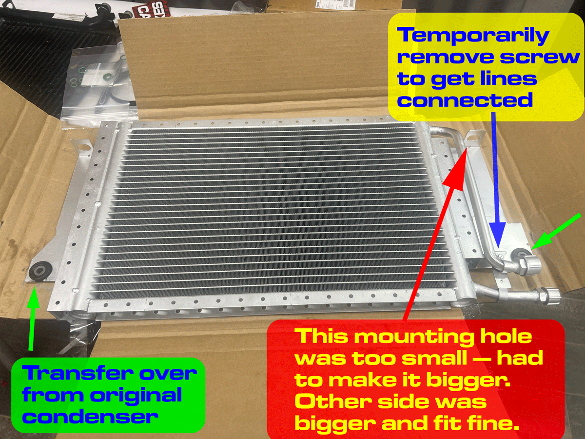

Happy to report I got my a/c system running again. I ended up installing the parallel flow condenser from Cooler Classics on eBay. Temps are as cold as ever it seems. There was only one minor fitment issue. For reasons I can't quite imagine, the mounting hole on one side was smaller than the other side, making it too small to slide over the rubber mounting nub on top. I took a Dremel to it so it matched the other side, and that fixed the issue. Only other thing I had to do was temporarily remove a screw holding the pipes to the side of the condenser (via a very flimsy bracket) in order to get the fittings attached. Maybe I was just being impatient, but I could not get the threads to line up with the screw in place, but once the hoses were all connected I was able to replace the screw. Overall, a pretty good, but not perfect, fit right out of the box. Although I'd say exactly the same about the Griffiths version. The Griffiths version 'seemed' higher quality, but mine failed pretty badly, so not really sure thicker brackets and pipes actually translate into a better condenser. Time will tell, but today I'm happy.

Good info. I may still order new ones, but these are just a few years old iirc. I replaced them out of necessity with I installed the now-failed condenser just a few years ago -- or at least that's how I'm choosing to remember it.dr bob wrote: Fri Aug 02, 2024 1:16 pm FWIW --
In my extensive collection of 'lessons learned the hard way' is the reminder that heat exchangers like the condenser, radiator, oil coolers of various flavors and intercoolers must sit in floating mountings. They suffer and fail when they can't grow and shrink in normal service, and also when body/chassis flex tries to distort them. Old, hardened rubber bits are barely better than bolts. New rubber mounting bits are way cheaper than most replacement exchangers, it turned out for me. Might still be true.
Edit: ah, I see in the picture I say to transfer over from original condenser. What I should have said was 'these don't come with the condenser...."
