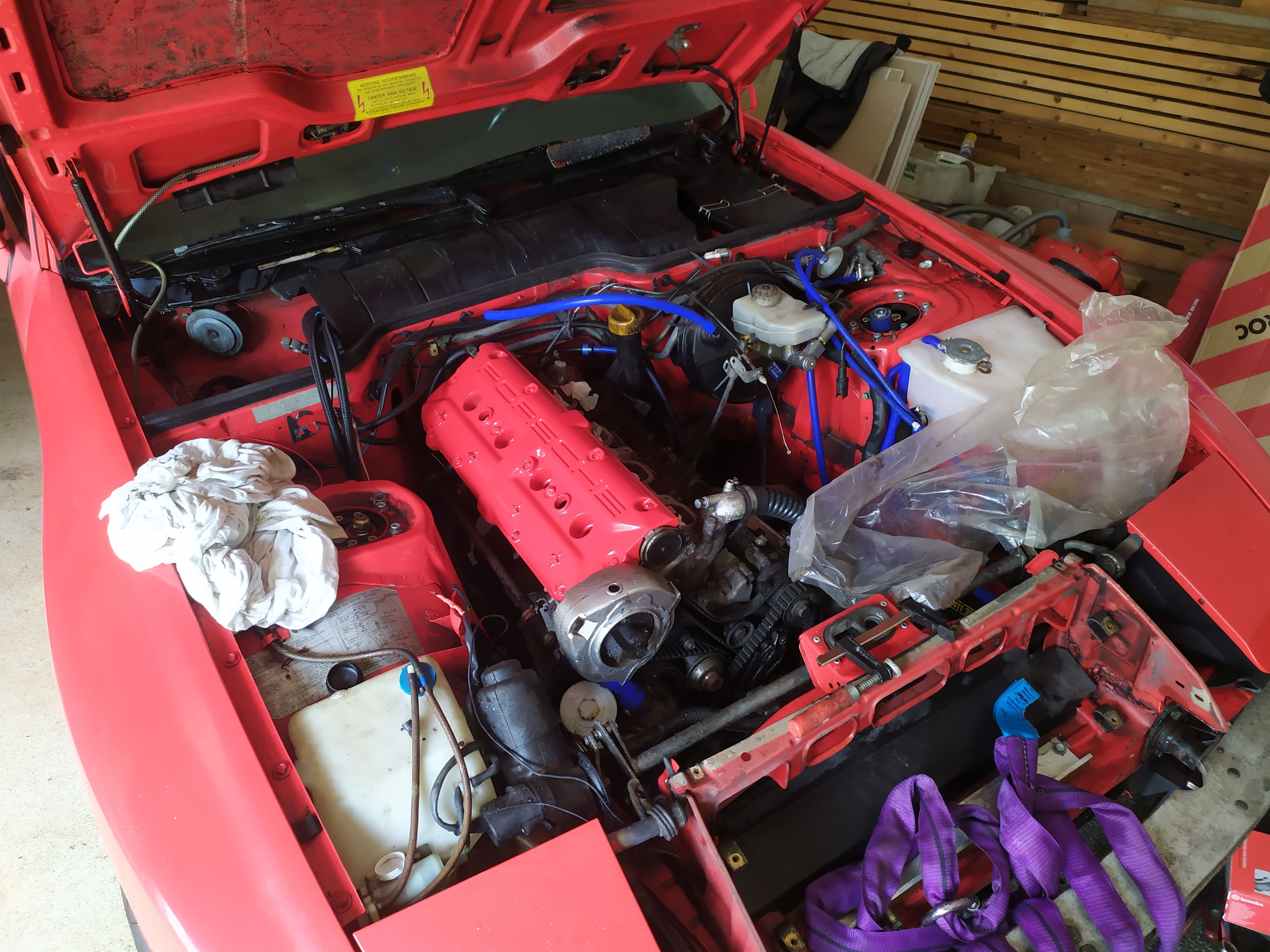

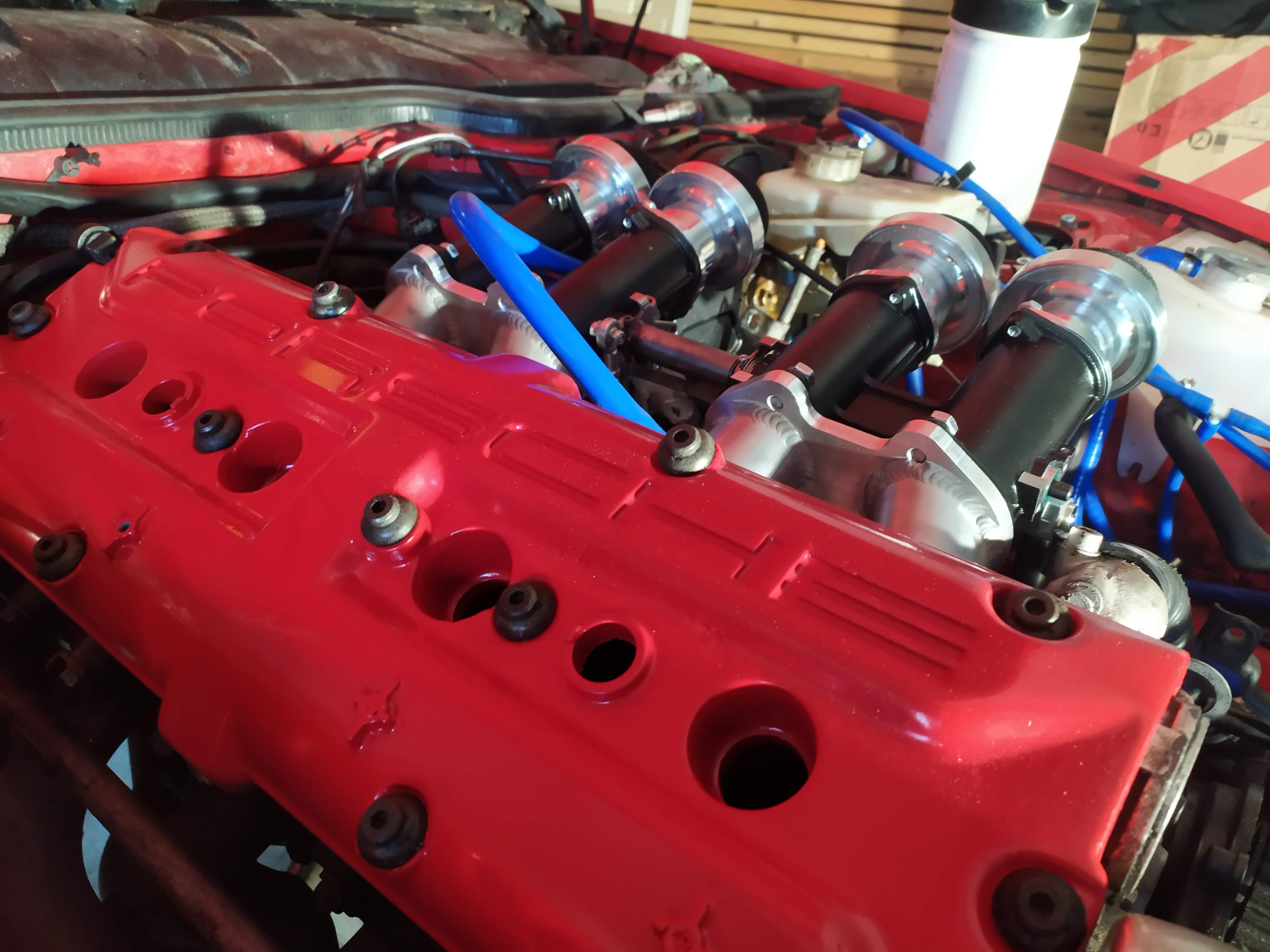

Stock 2.5l 16v engine with New seals\bearings and crank scraper -Fresh head with new guides and seats\ nothing out of the ordinary .
Danst Engineering 50mm itbs
Motorsports electronics me221 ecu with wasted spark ignition.
Now that ECU is on order i am planning the next step in this project and that is to see how good the stock 944s head can breath with some more aggressive cams .
Plan is to run the car in June and tune the current engine setup. Then add improvements in the winter
Low rpm drivability or low end torque is not the priority with this build. This will be a high strung fun engine .
I do not want regrinds but do want 2 exhaust style cams for a dual camgear setup. I may eventually upgrade the head with 968 intake valves and push rpms together with a drysump system.
