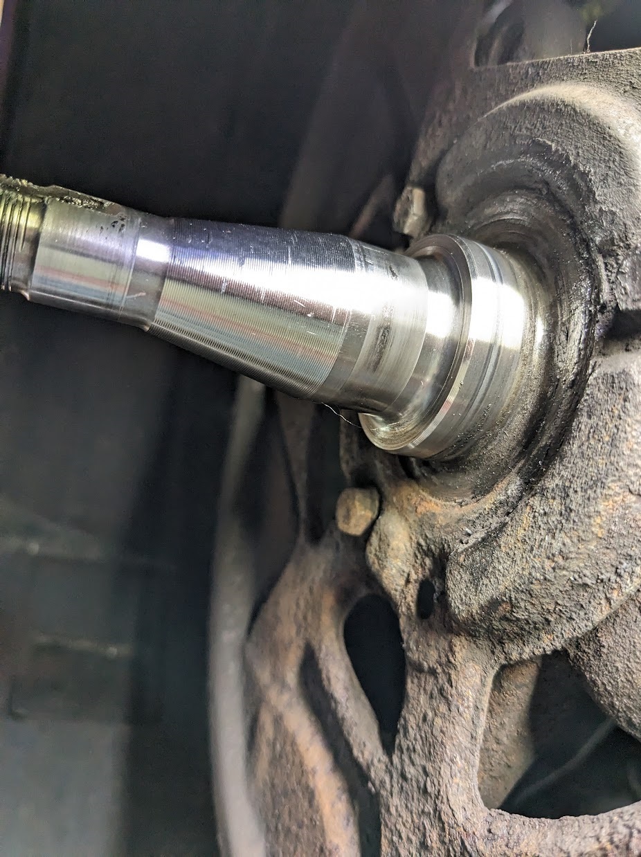

Old-skuul tapered spindle bearings --NEED- to have a small amount of clearance/play, to allow the formation and maintenance of a film of grease between the rollers and the races. Too tight, no clearance, no lubrication, and you have overheating, negative clearance from thermal expansion, and failure follows quickly.
Suggestion: The normal wear on the spindle is on the bottom, where most folks don't see it. The finish on the spindle itself leaves what looks like coarse grooves that the bearing races slide over. Inspect the bottom of the spindle where the inner bearing sits, looking for a polished (read: worn) section. You can use a micrometer to verify that the spindle is worn out of round, but the visual tells you plenty. You can manually fit the inner race thee and see if it can be rocked at all on its own; it should sit square with no rocking available at all. There's no easy recovery short of replacing the spindle, unfortunately. If the spindle is discolored from heat, another reason for replacement. Use care buying used replacements as they too are subject to the same wear and lack of inspection while on the car.

The classic "rock the wheels looking for play" is a broad-brushed look for worn pieces like ball joints and tie rods, as well as a handy way to identify bearings that might have worn or failed. And for a worn spindle. Once the worn pieces are replaced with new, there's no rock-the-wheels test for adjusting the bearings. The procedure for checking for spindle thrust-washer movement is the only bearing clearance adjustment. Got more 'rock' clearance than you think is right after adjusting the inspected and packed bearings? Especially if there's a difference between 6/12 and 3/9 o'clock positions, it's not the bearing itself.
More fun thoughts -- Too Tight on the bearing clearance contributes to the inner races walking around the spindle, causing more wear on the weight-loaded face of the spindle where the bearing sits.
So take a hard look at the bottom of the spindle for evidence of wear and discoloring. My nickel says you'll find your cause there. If I'm wrong, send a SASE to me and I'll drop the nickel in there for you.

I think you are right, no nickel for me
The wear pattern on the bottom side of the spindle is quite different from the top side, much more matte on the bottom side and I could also feel a small edge with my nail. I've attached a not-so-good picture.
I've found a set of supposedly good used spindles so hopefully that solves the play. Will let you know after I've received and installed them.

You have nothing to solve; the play you describe is normal and necessary
