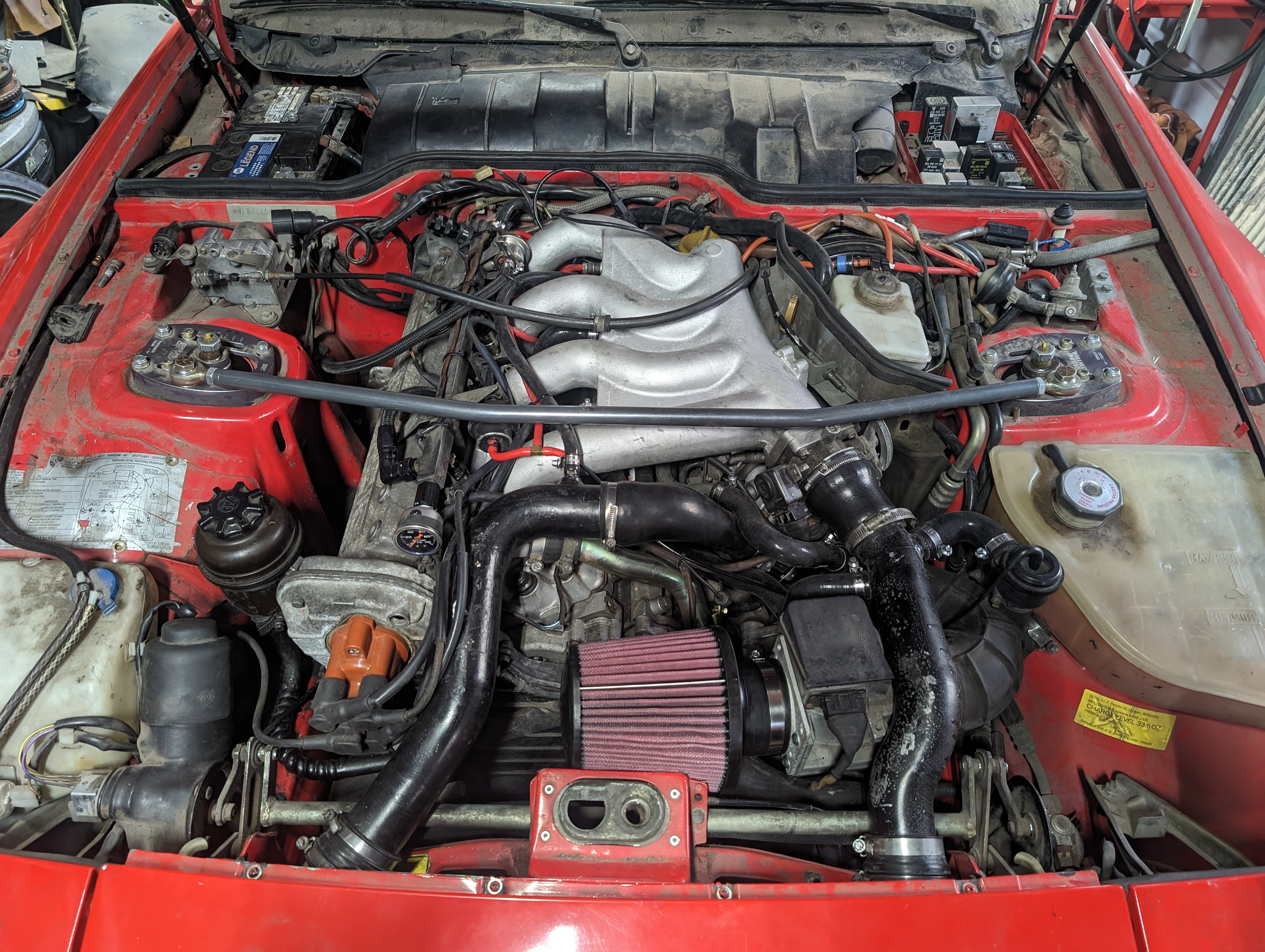

So I'm at the tail end of a long rebuild and install of an '86 turbo motor into my '85.5 NA. I'm using as many stock parts from the donor car as possible, harness, ECUs, sensors, intercooler and plumbing, etc...
I'm running into a trademark no start "no tach bounce" scenario at this point as it's finally ready for first start. I've done a thorough troubleshooting workflow to isolate sensors and wiring issues. I have fresh Bosch reference and speed sensors and a new-ish replacement LR reference sensor harness I've used since the factory one was beyond crusty. The oscilloscope readings of the sensors are good and they're producing good consistent peak to peak voltage numbers. Good ft9 solid state DME relay, though I've tested with a jumper as well with no results. After a few days of troubleshooting it's looking likely that I have a bad DME, the one I'm using came with the donor motor, has been opened up, and obviously is nearly 40 years old. I opened it up again last night and naturally the ignition driver solder joints have cracks in them, seem to have good continuity but I'll reflow them for good measure this morning and see if has any effect.
Having a late model car, it's seemed like most of the harness/electrical stuff has been very straightforward, more or less plug and play. Is there anything obvious that I could've missed in regard to using this motor in my NA chassis? I did have to revert a change I had made at the 14 pin connector for the ignition signal to accommodate the 16v motor I had in this car last- that connector is now as it came with the original 8v motor and as far as I know I shouldn't need to make any changes there for the new turbo motor.

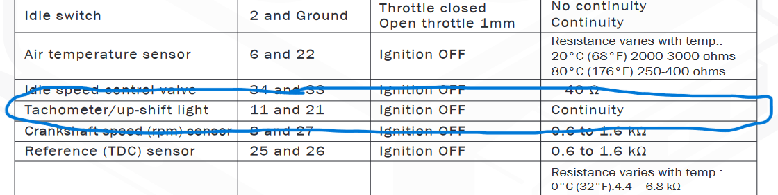

Anything sticking out to you guys? All sensors and checks on the standard one page DME wiring test sheet pass, other than the tach/upshift wiring at pins 11 and 21 on the DME connector, which is supposed to have continuity and does not. I realize the 951 never utilized the upshift light (neither did my car in the first place for what it's worth....), and I'm too dumb to know whether A. it's normal or B. even if it's not if it could result in a no start issue.
Screenshot 2024-01-29 at 11-16-33 DME-Diagnose-Follow-up-Forms - DME-Diagnose-Follow-up-Forms.pdf.png
Screenshot 2024-01-29 at 11-16-33 DME-Diagnose-Follow-up-Forms - DME-Diagnose-Follow-up-Forms.pdf.png (96.36 KiB) Viewed 1368 times

Hi, see my post in your other 'saga' thread. I'm wondering if you hooked up the tach? It's not an obvious thing to do when installing a turbo motor in a non-turbo chassis, so if you didn't put some effort into sorting out that wiring, I'm guessing your tach isn't working. Now that would not explain the no-start, but best to start with a working tach so the no-bounce doesn't throw you off. If you have an o-scope, you can also check the signal on dme pin21 when cranking. That's the signal the drives the tach (green/black). It should pulse to ground in time with the revs. If you see those pulses, and the tach is not bouncing, then the DME is working (in that regard) and the tach is not for whatever reason (probably wiring per my other post).

Thanks Tom! This is exactly the type of information I'm on the hunt for. Both the car side and the motor side of the harness have the matching red 4 pin connector that goes right together, my assumption is that the wiring is the same inside the plug but that obviously could be completely wrong. I'll try to track down the diagram for that plug.
I'll have some time this afternoon to mess with it hopefully, I'll go ahead and scope that pin 21 signal- that may actually be the nail in the coffin in regard to confirming whether or not the DME is good or not. I think If I'm not seeing tach output signal there and have since confirmed the ref/speed sensor inputs are good (they are), it may indicate something else internal to the ECU has gone south.

Ok, quick update on this: we have tach connectivity to DME, and we have tach bounce! Er...did.
Per Tom's suggestion I double checked the wiring from the DME harness to the tach- it appears that in fact the red 4 pin plug on my '85.5 does jive with the corresponding plug on the '86 turbo engine harness. I had continuity all the way, and was able to verify tach response by grounding that pin at the DME.
Also, that morning I spent a few minutes re-flowing cracked solder joints in my DME as a last resort, the 3 pins at the ignition driver were of course the worst though still showing good continuity with a DMM. Oddly enough that was apparently a real issue, as soon as I plugged it in and cranked a few revolutions I had tach bounce! For whatever reason literally the next crank it was gone. I'm guessing the DME is on it's last legs...
