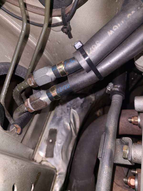

Yes, I was probably too quick to respond to this post!
Looking more closely at what Belmetric has to offer, there will be a problem obtaining an M16x1.5 and M14x1.5 female threaded DIN flare fitting for rubber fuel line. However, it is still a simple task, in my opinion, to replace your fuel lines.
I'm only going to talk about rubber, because I think polyamid hose is an abrasion protection hassle.
I re-used the original Porsche fittings off the old stock fuel lines. Begin by carefully cutting away the crimp collar with a hack saw, leaving the fitting still attached to the old rubber hose. Then carefully cut the rubber hose axially/in line with the fitting without scoring the the underlying fitting's barbs. Pull the fitting off the old hose. There's your compatible M16x1.5 DIN flare connector. There will be nothing wrong with it unless someone has previously mangled it with incorrect wrenches, etc. If that is your situation, just buy a set of used lines from Plyhammer's or another 944 dismantler; they should be pretty cheap.
Attach this to a new piece of Cohline 2240-0600 fuel line. The type of line is important, it has to be capable of handling the fuel pressure, and it has to be rated for ethanol. I used Oetiker clamps, even though with no clamps on the assembly at all, it's impossible to pull the hose off the fitting (try it!); it works very much like a push-lock fitting. Anyway, since it's technically not an actual push-lock fitting, I used the Oetiker clamps. If you're flush with cash, buy collars and a hose collar crimping tool, Belmetric has those too.
Obviously, do this for the return hose as well (the M14x1.5). If you are connecting to a stock fuel rail/regulator, do the same for that end of the hoses. If you're attaching to some other custom fuel rail, obtain whatever connectors it requires.
https://belmetric.com/m7-3x13-5-smooth- ... 2240-0600/
https://belmetric.com/yellow-zinc-high- ... P14.5YLWSS
https://belmetric.com/fittings/collars-tools/
These are the hoses I made for my car:
