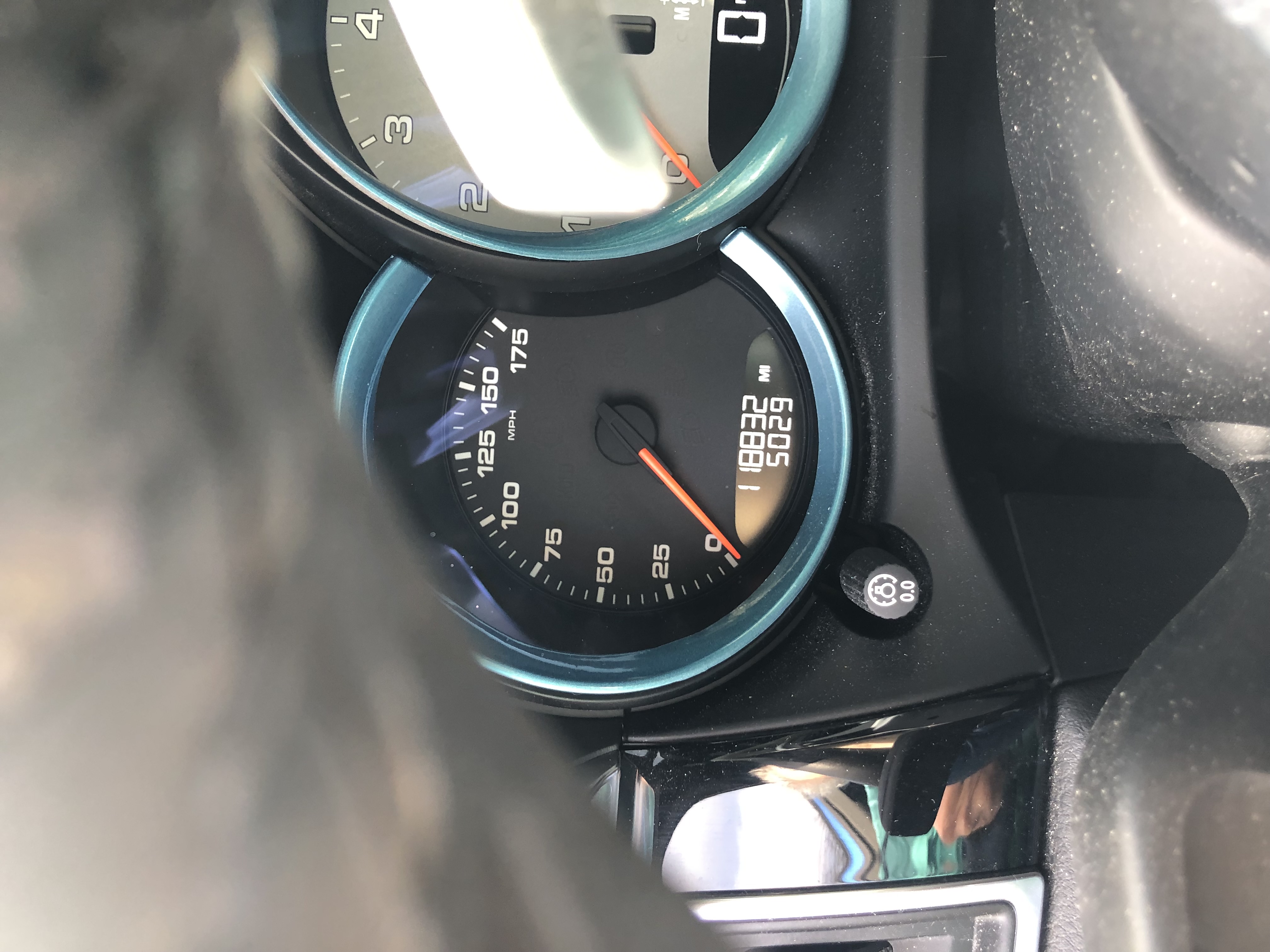

I have a 2016 Macan S with 118 k miles. It was CPO returned lease with 34k on it in 2019. Over the last few weeks it has been making an increasingly loud taping noise from the driver side of the engine. It almost sounded like a diesel.I took it to a trusted mechanic and he found significant brazing on cylinder 6 closest to firewall driver side. The rest of the inspection was good. Needless to say I’m off warranty. I called the dealer where I bought it and couldn’t get an answer as to what could be done, although in my heart of hearts I’m certain I will need a new engine. Someone posted a similar issue earlier but he was under warranty and got a new engine. I even told the dealer I have a video of the scored cylinder wall . Anyway, I’m dropping it it off on 01/30 and I will get a loaner. I will post what happens but for now I would welcome any comments. Thanks, guys.
