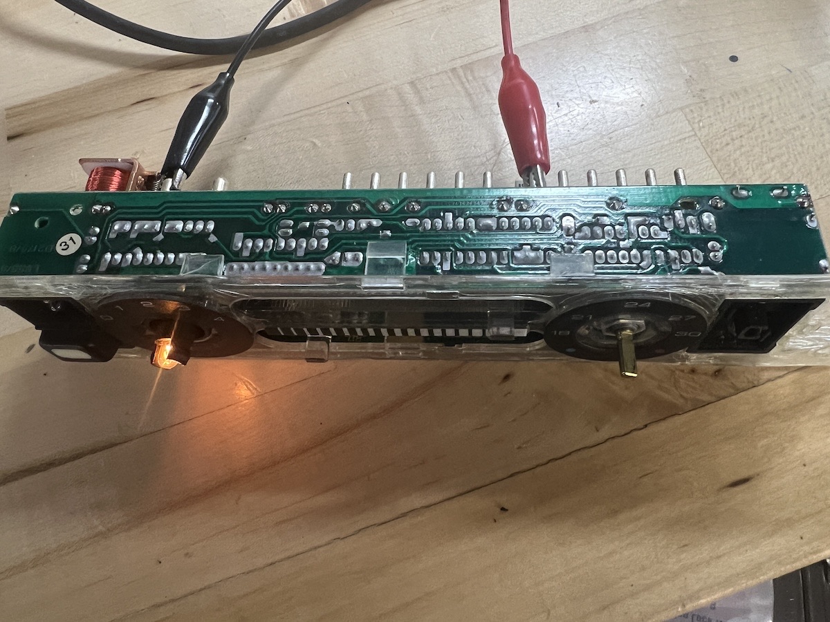

Posted: Sun Jan 21, 2024 7:17 pm
It looks like 12v+ on B1 drives the lights. This is a picture with 12v positive on B1 and ground on B5. I still can't find a dimmer input. My car is on the lift, but I'm suddenly wondering it those lights don't actually dim with the instrument cluster lights? Anyone able to check?

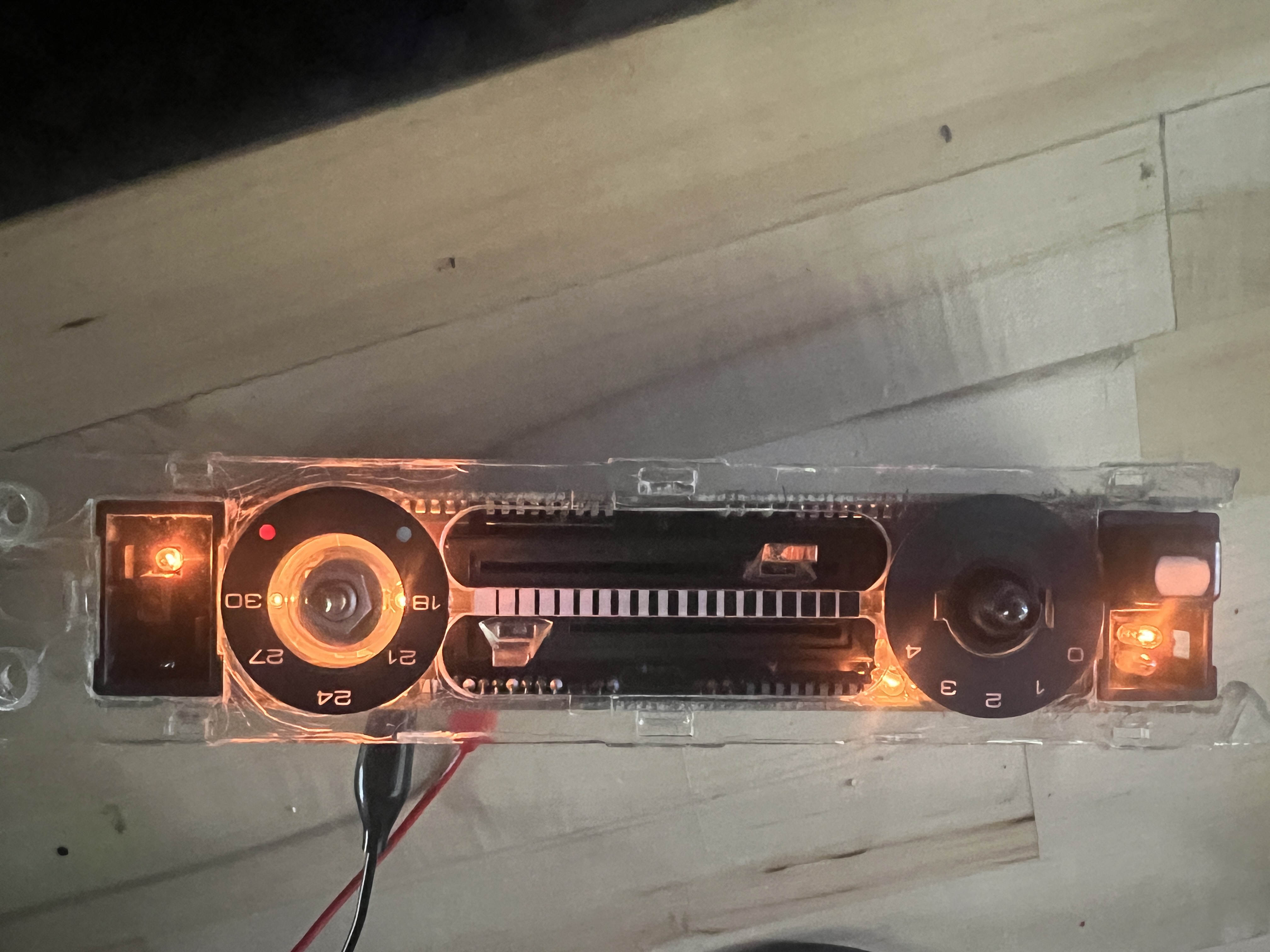

Posted: Mon Jan 22, 2024 8:24 pm
Turns out that bulb depends on a different ground. Here is it with C2 grounded...
