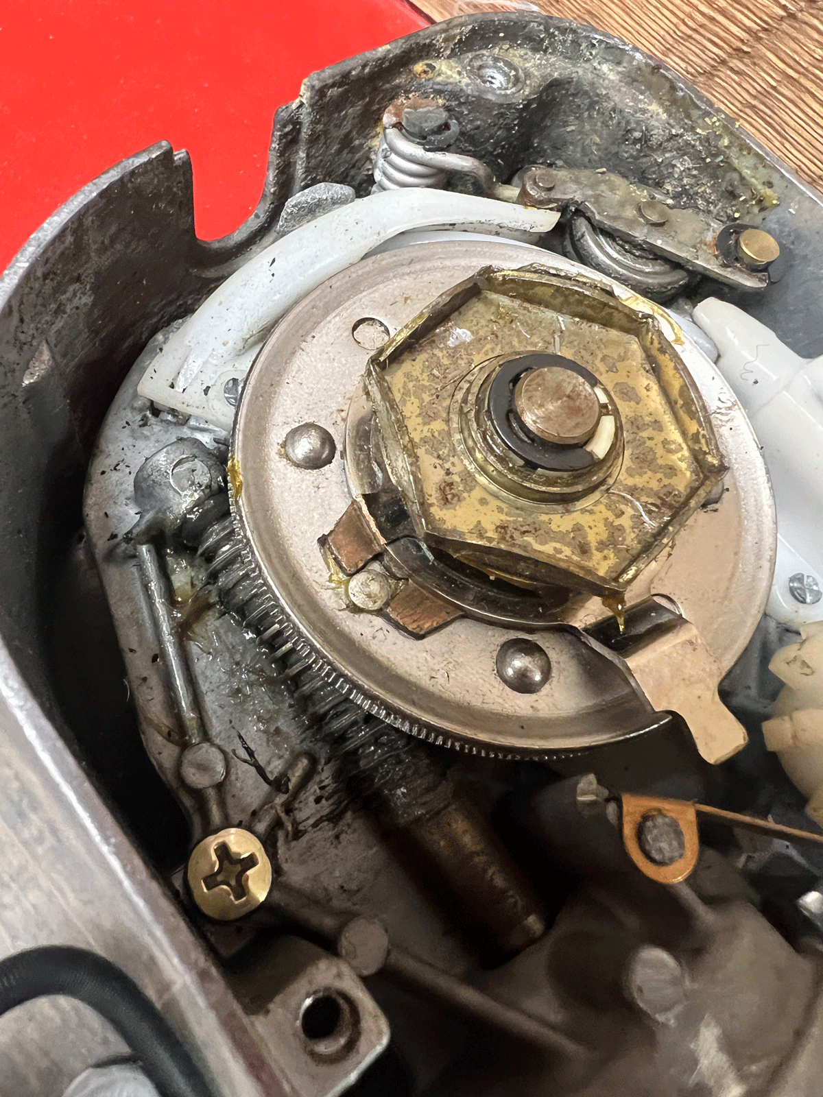

I recently bought a 'rebuilt' Hirschmann power antenna from Becker Auto Sound LLC in New Jersey. These antennas were used in the 70's and 80's with Porsches, Mercedes, and other West German cars. Becker Auto Sound makes reference to being 'authorized and certified' to repair old Becker radios, but their actual affiliation with the old Harman Becker company, if any, is a mystery to me.
The antenna is listed on their website as a rebuilt unit, with a $50 core if you return your broken original. The link takes you to their eBay store to "Buy it Now." So I bought it. When I got it, it did not work and showed no signs of being 'rebuilt.' I figured there must be a mistake -- someone must have mistakenly send me a core -- so after pestering them for a few days, they agreed to send a replacement. Just got the replacement yesterday and I'd say it's even worse (and also does not work). I had asked how to return the old one, but they never responded, so I currently have two old non-functional antennas for $300 plus $56 (!) shipping. Their communications are slow and cryptic, and when I called them previously they told me to work it out through the eBay system (pursuant to which, to date, I've received 2 messages totaling 11 words). So I'm irked at best, and thought I'd warn my Porsche brethren in case you're tempted to use their services.
Here is an excerpt from the FTC regulations defining what 'rebuilt' means in the context of auto parts, and below that are picture of the non-functional antennas these guys advertise as 'rebuilt' units. You be the judge....
16 CFR §20.3: It is unfair or deceptive to use the word “Rebuilt,” or any word of similar import, to describe an industry product which, since it was last subjected to any use, has not been dismantled and reconstructed as necessary, all of its internal and external parts cleaned and made rust and corrosion free, all impaired, defective or substantially worn parts restored to a sound condition or replaced with new, rebuilt (in accord with the provisions of this paragraph) or unimpaired used parts, all missing parts replaced with new, rebuilt or unimpaired used parts, and such rewinding or machining and other operations performed as are necessary to put the industry product in sound working condition.

Tom,Tom wrote: Thu Jan 04, 2024 6:46 pm I recently bought a 'rebuilt' Hirschmann power antenna from Becker Auto Sound LLC in New Jersey. These antennas were used in the 70's and 80's with Porsches, Mercedes, and other West German cars. Becker Auto Sound makes reference to being 'authorized and certified' to repair old Becker radios, but their actual affiliation with the old Harman Becker company, if any, is a mystery to me.

I'll start by asking Becker for a full refund, shipping and all. If they push back, I'll file for PayPal buyer protection and call my card issuer. They were so indifferent about sending a second unit, I'm kind of thinking they'll just process a return without comment, apology or return shipping label, but time will tell. In the meantime, I have two used antennas for $356, which is about what you'd pay for 2 old used ones on eBay...
- Posts: 9106
- Has thanked: 952 times
- Been thanked: 4088 times
In fairness to Becker, I was able to get the replacement to work -- or at least show enough signs of life to make me think it will work. May have been dirty connectors not supplying enough juice. Still, they are selling these things as 'rebuilt' and I think the pictures speak for themselves...

Welcome aboard and thanks for chiming in. Perhaps being local and a repeat customer provides you with a better experience? When I called, twice, I was told (in no uncertain terms) to deal with it through the eBay system and I didn't sense a hint of concern about the situation (quite the opposite actually). When I went through the eBay system to say I got a core instead of a rebuilt unit, they just sent me a second core, and didn't ask for the first one back. Neither of them worked right as delivered. I cut my losses at that point and found a 'tested-good' used one on eBay from a different seller, which is in the car now.
I totally get how difficult it can be to rebuild things when parts are not available anywhere and the cost often does not justify trying to make your own. But, it's not right to advertise something as 'rebuilt' when it obviously isn't -- no matter how many you are willing to send until finding one that works. I just checked, and they are still selling them on eBay claiming they are 'rebuilt." Maybe they've changed since I bought mine, or maybe I just had terrible luck, but If you poke around the internet, you'll see plenty of posts complaining about bad communications, etc. and, in fairness, you'll see plenty of posts like yours saying their work-product is good. So, I'm guessing both can be true depending on circumstances. My 'hunch' is that (1) they are old-school electronics junkies who are good with resistors and capacitors, but not so good with people, and (2) they treat the eBay store as an ugly step-sister without realizing the impact it has on their reputation. They lost me though. I'd never allow old used part to be sold as 'rebuilt' under my name, and it makes me not want to go back.
