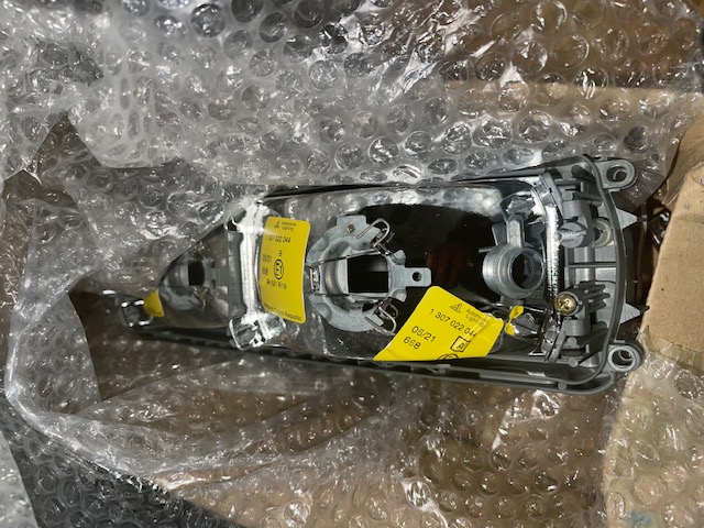

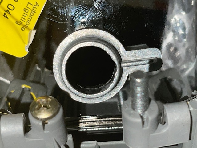

Can anyone tell me what that hole is used for am I. Missing something want to install euro fog lights on 944

It's a running light, that comes on in the 'parking light' mode
