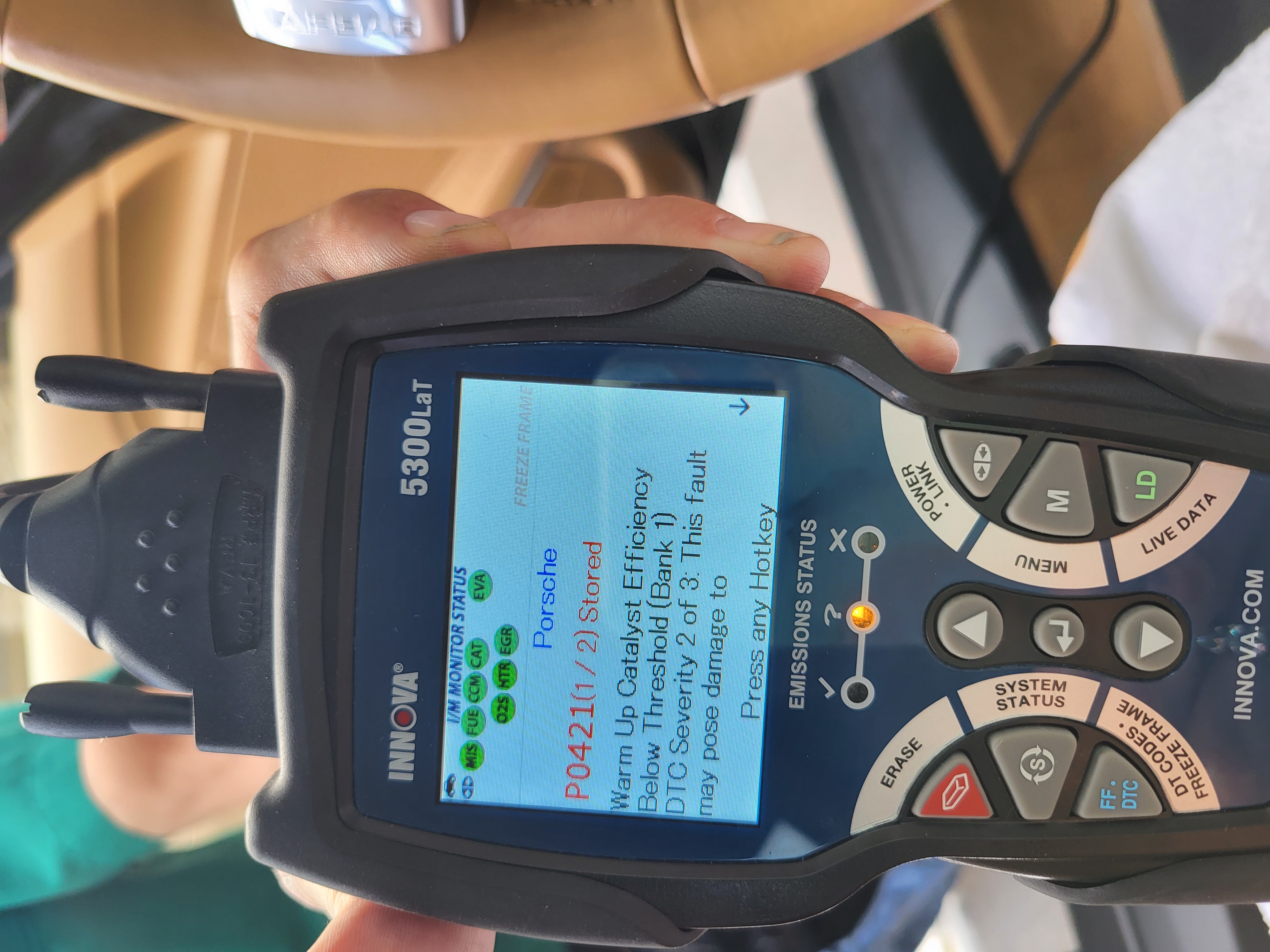

This is what the the code reader showed.
Interesting as I left O'Reillys the warning dissappeared. Went over to the dealership on another issue and they didn't have an answer as to why the warning disappeared but he did say to keep an eye on it.

Glad it went away and that you checked with the dealership. Hoping the warning stays away!bcgreen wrote: Fri Nov 24, 2023 6:09 pm This is what the the code reader showed.
In case it returns, I searched "DTC Porsche p0421" and there were several responses mostly centering around the catalytic convertor and/or the O2 sensor on that bank. One response "This code pops up when the powertrain control module detects a problem with the warm-up catalytic converter or when there’s a bad oxygen sensor that’s affecting the cat-con’s operation."
Doesn't seem too serious nor that uncommon and also probably a relatively easy fix. Maybe not too expensive either.
