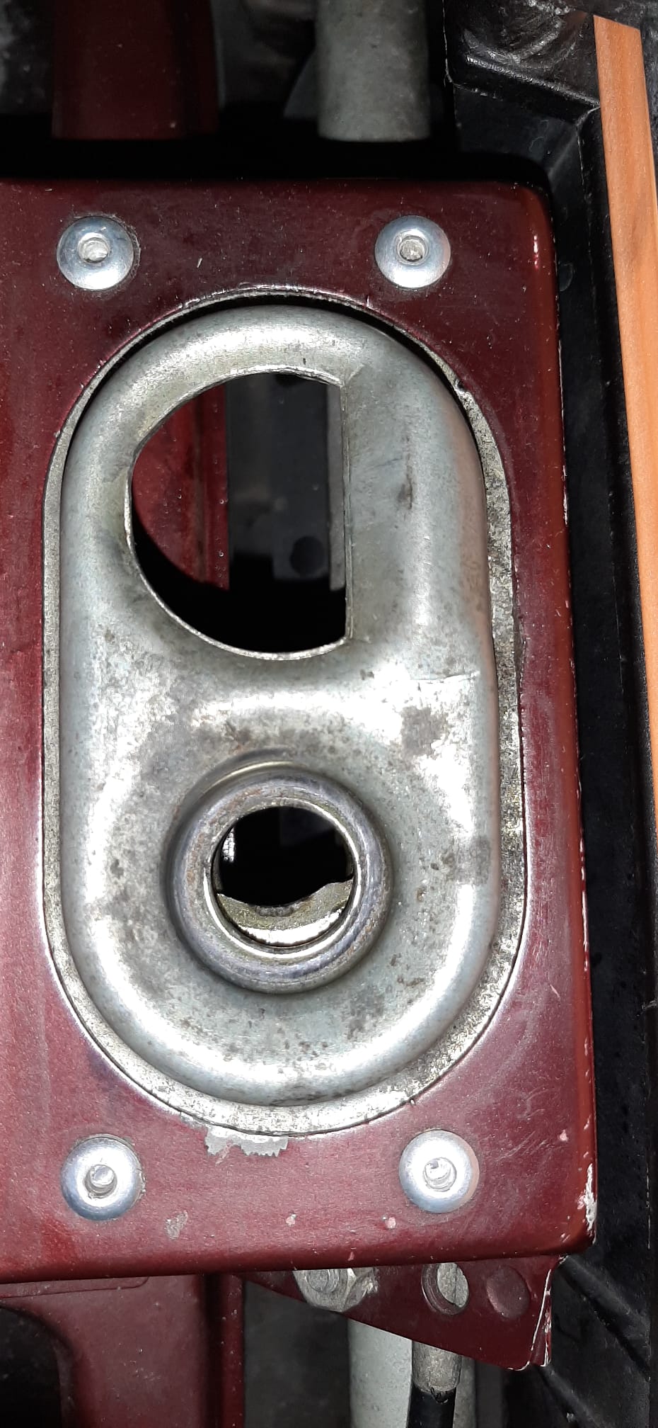

The left part (latch you use to open the hood) works fine. Right part seems to have some resistance. Moving the mechanism with a screwdriver is a bit difficult but works. Pulling on the cable attached to it works, but requires some force. I tried cleaning it with WD40 but need to do it more thoroughly. You can see what looks like a bit of damage to the internal part that moves.

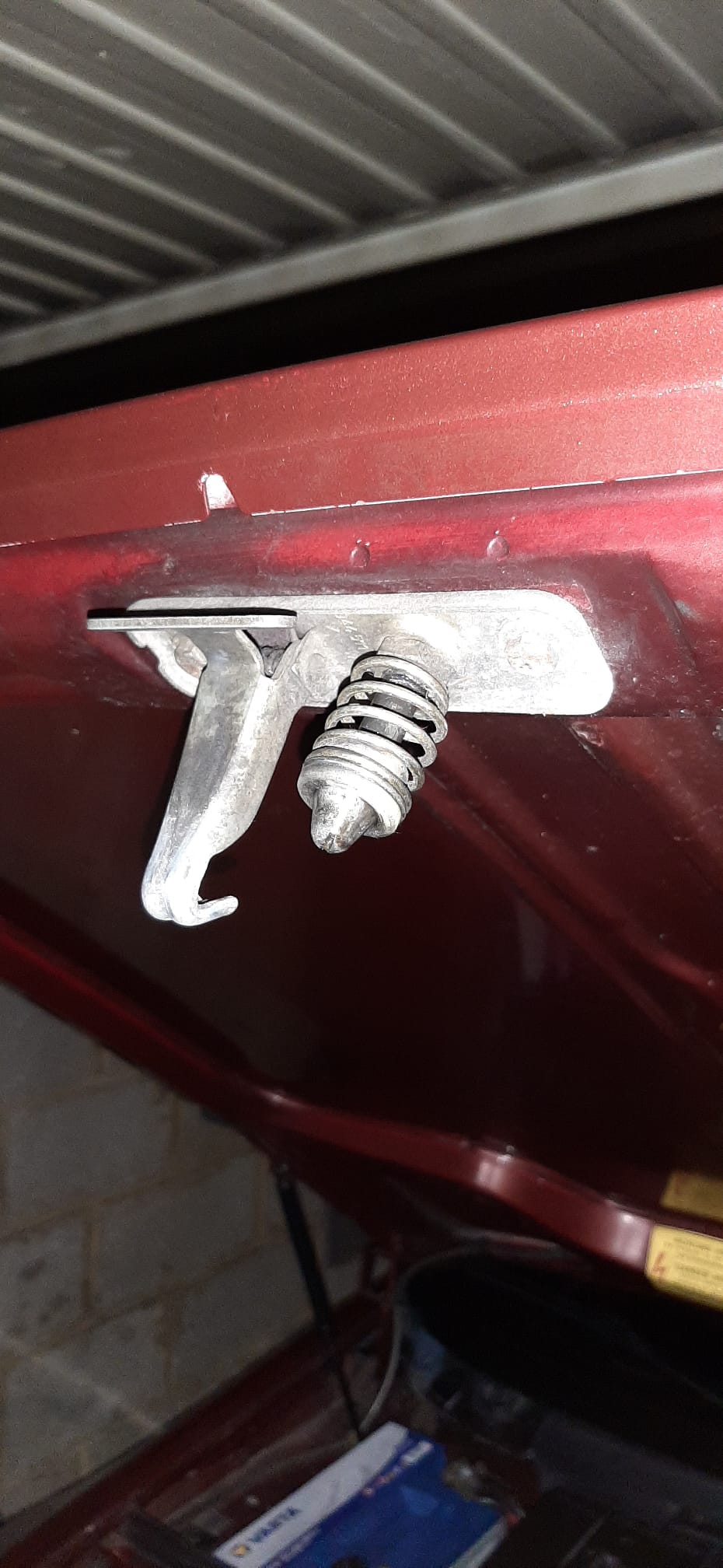

The spring seems to be very stiff, it's hard to compress this. May be normal?

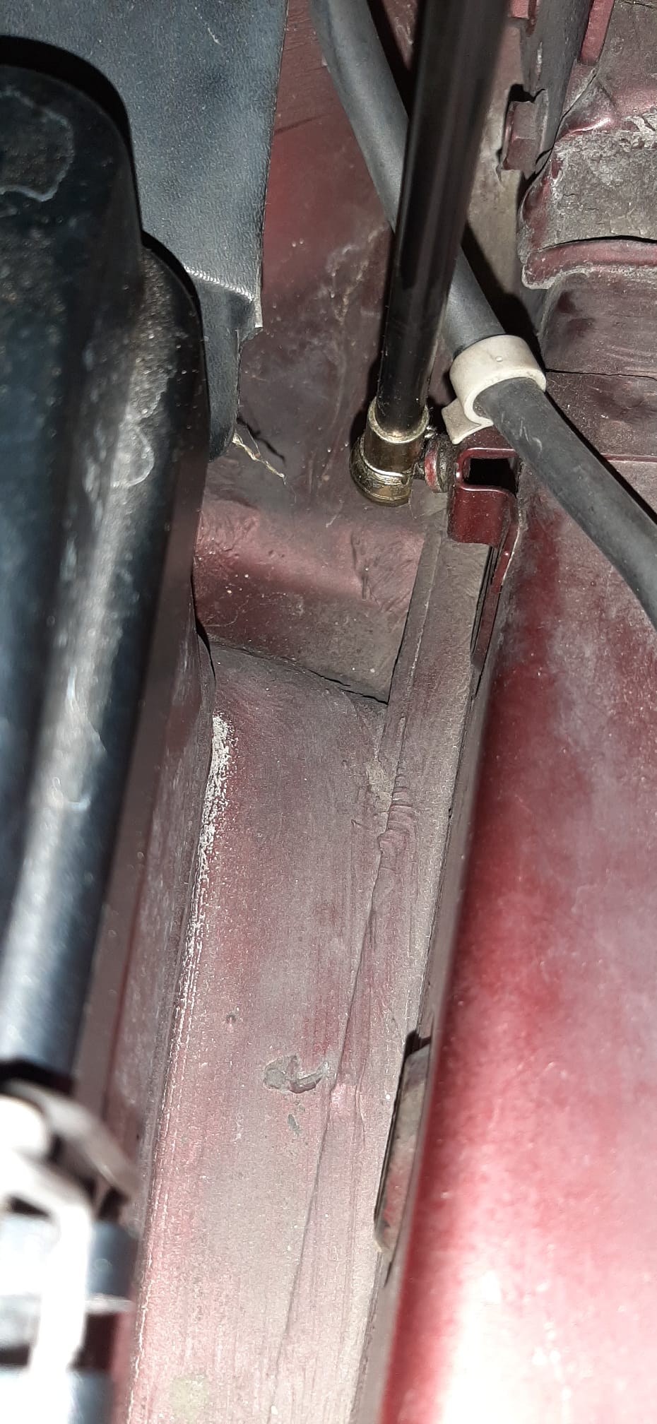

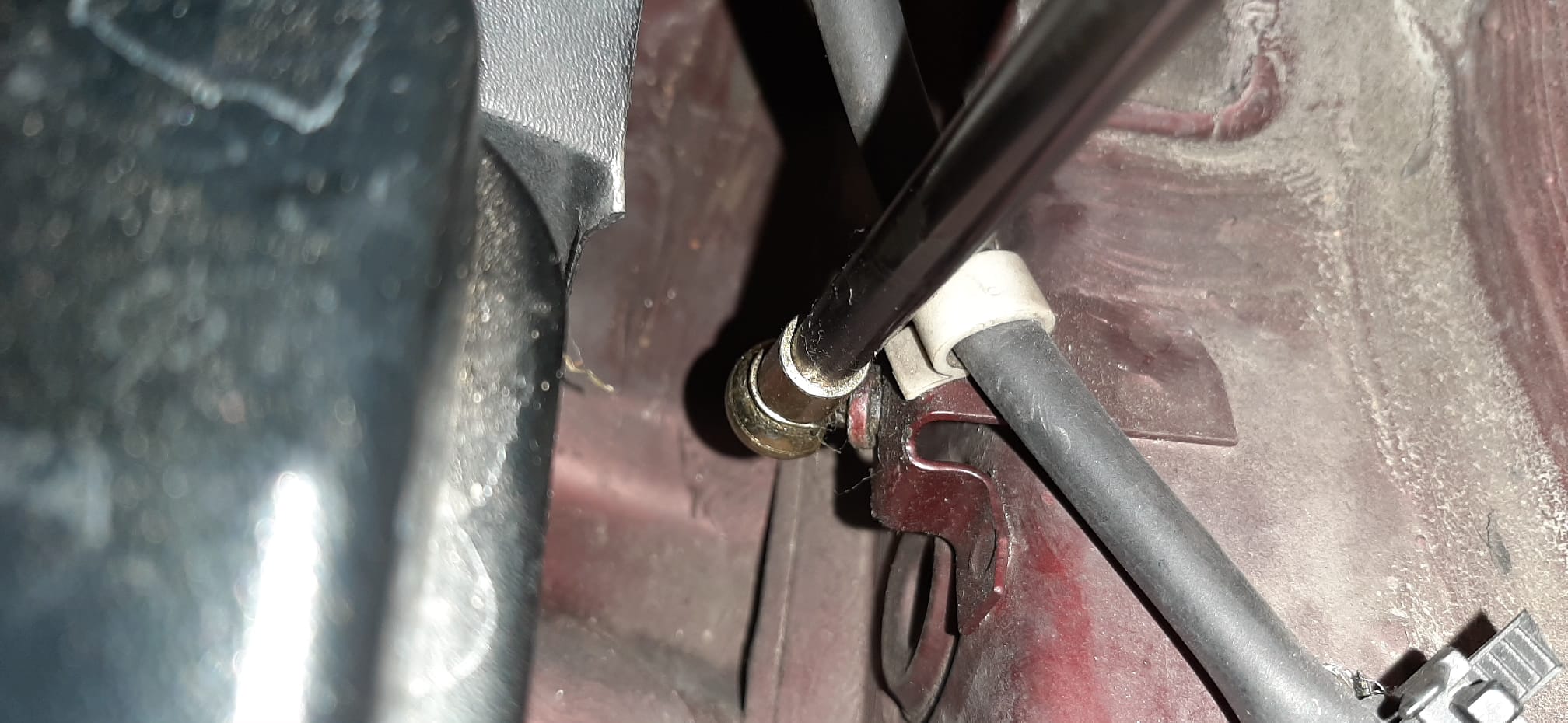

Driver's side hood strut is damaged. Don't know how it happened but the thing where the strut sits on is bent. The part number is 94450137200 and is quite cheap (26 EUR/USD) but I think it requires tack welding to be fitted?
WhatsApp Image 2023-11-19 at 21.35.24.jpeg (236.45 KiB) Viewed 1534 times
Any tips to bend this back into shape would be welcome!

The hood struts fit at lot like the hatch struts. There is a ball socket on the strut side, and a ball on the car side, with some clip that retains the socket over the fixed-in-place ball.
Looks like the car-side ball for that hood shock is bent or cracked from its weld. (I don't know for sure that they are welded in place, but it makes sense.)

The hood latch looks like something is cracked/chipped? It's possible to drill out those four rivets, remove the latch, and see what you can see. I suspect the latch is available from Porsche dismantlers if yours isn't repairable.

I checked my latch today and can confirm that catch spring is very tight. I tried to move it with my finger and it wouldn't budge. If you suspect the latch mechanism, you can remove the hook part from the underside of the hood. It's bolted on with two easy-to-remove bolts...

I think first order of business will be to try and bend back my pneumatic spring mount.
I read somewhere that someone had a similar problem where the little ball joint was gone, and they inserted a bolt through the hood strut and the spring mount as a temporary fix. That sounds like a plan to me but I'm wondering if anyone here can verify that the strut on the car side is indeed hollow and that you can insert a bolt through it. If so, what size bolt would that be?
Any ideas for bending this spring mount back in place would be welcome. It's a tight area and I think I'll need upward pressure so not sure how I will manage.

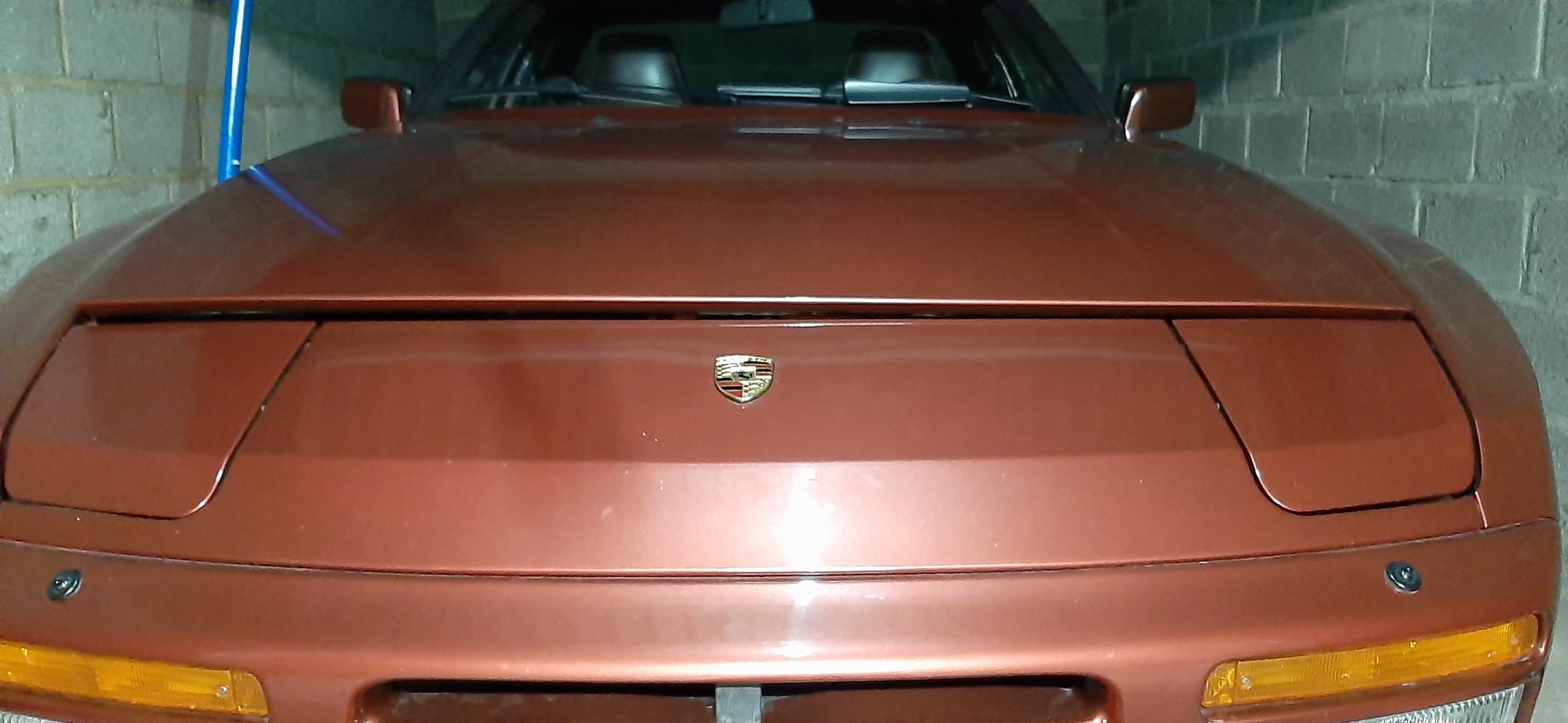

Here's a picture of the hood with the left strut removed and the OEM air filter box completely in place.
