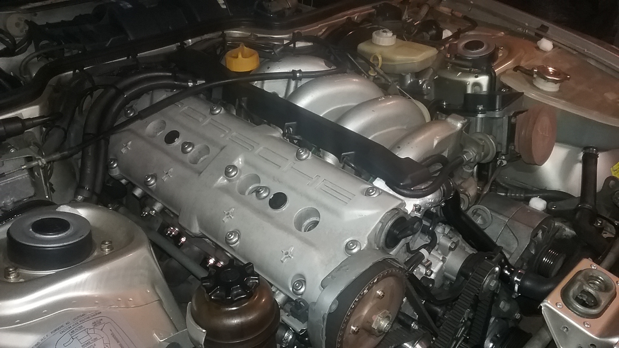

944S and S2 owners need to understand that these are magnesium, not aluminum, covers and magnesium demands very specific coating processes, as it is one of the most, if not the most, unstable metals around. Your typical powder coating shop will not have a clue how to deal with mag; typically only aircraft refinishers work with it on anything approaching a regular basis. There's a ton of really good information on the internet about magnesium finishing - look for a product called Prekote and forget about powder coating if you want it to last. My cover was horrific, with black magnesium oxide and peeling silver paint all over because a prior owner had rattle-canned it after stripping the very good quality factory finish off. I bead blasted, washed (really well with Dawn dish soap) and Prekoted it, then applied a few coats of clear Cerakote MC-5100. It turned out amazing (below) and won't oxidize, peel, flake off, or turn black for quite some time to come, if ever. It still feels silky smooth and looks exactly like it did the day I finished it, a year ago. You should be able to find another cover in reasonably good shape, but it probably won't be cheap. Best of luck!

I did do the inside. It was pretty clean, actually. The prior owners had been using synthetic oil that must have had an awesome detergent package, because the engine was clean as a whistle inside. When I did the cover, I bead blasted and finished the inside as well, because the Cerakote is rated to handle the temperature and it's a super tough coating. I had the cover off about a year ago and it still looked perfect. I don't have a picture of the inside though.
