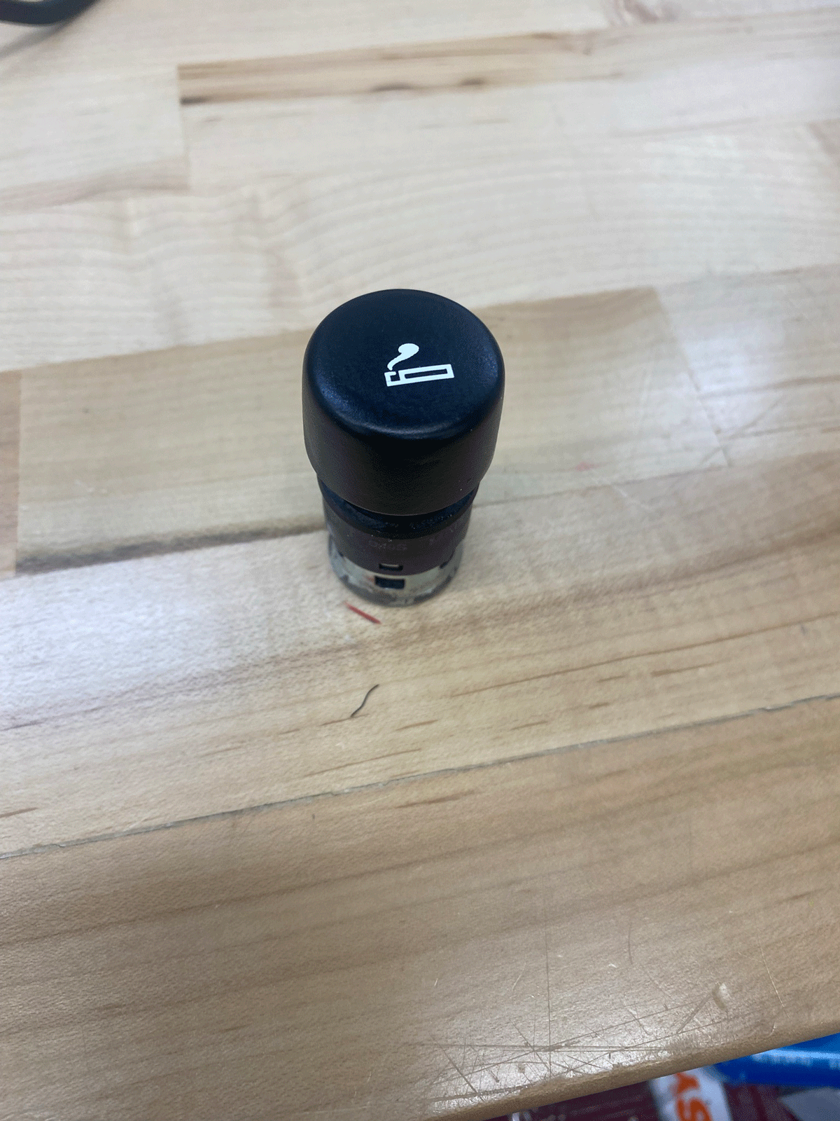

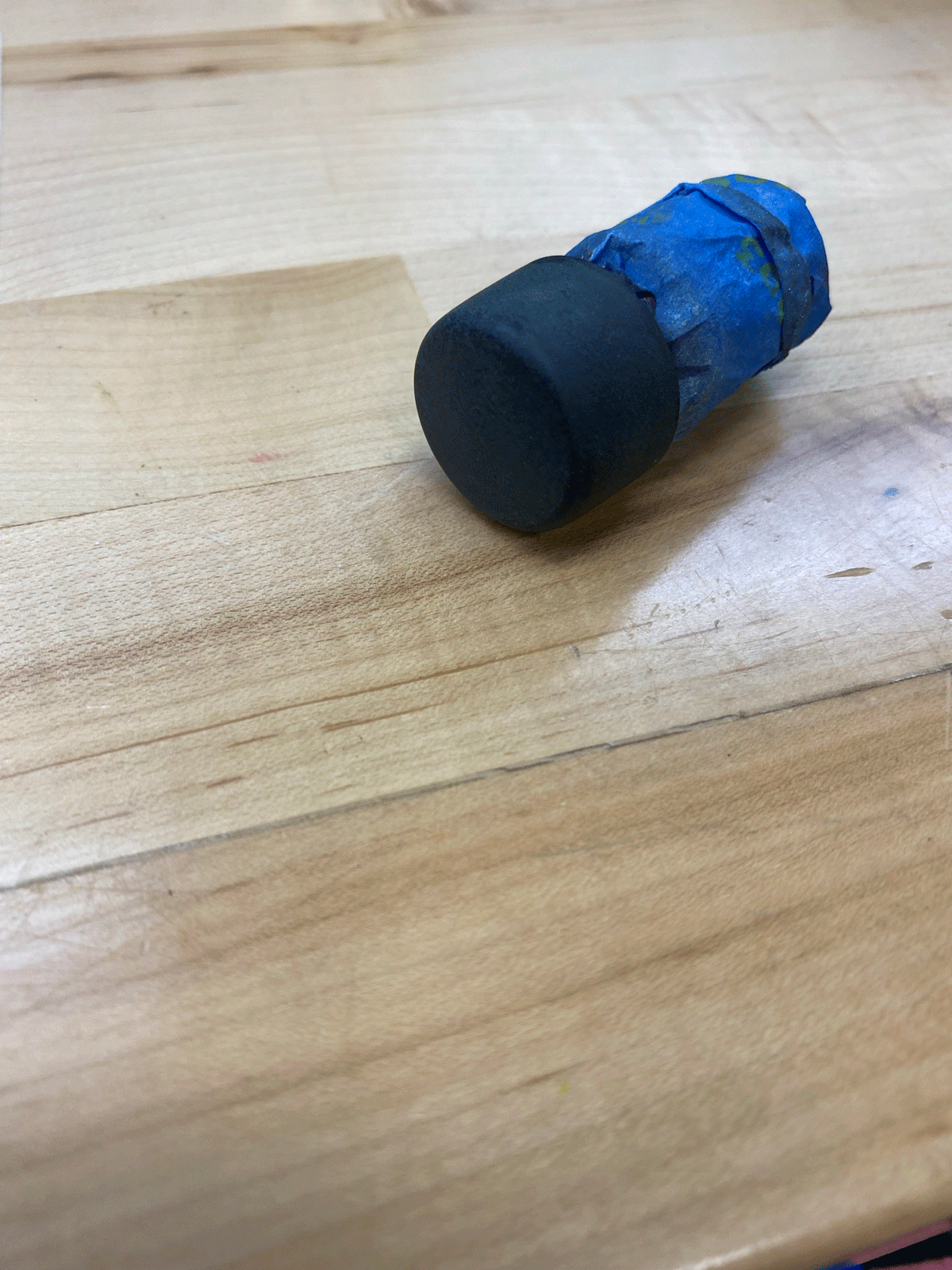

So I 'restored' the lighter today. Bottom line, these little graphics are great and are the key to making things look new again. That said, I wasn't a fan of sanding off the old graphics and using the nail polish brush to apply the clear. It wasn't terrible, but the clear looked a bit blotchy and brushed on after drying, and the sand marks were still visible. Probably user error, but I tried my best... I'm also hyper picky at times... ;) So, what I ended up doing was lightly sandblasting the plastic to get rid of all the old graphics and give it a uniform texture. I then applied the graphics from the kit, which went on with no problem at all, and then sprayed the whole things with Rustoleum satin clear. The graphics seem to do well with the clear, but Joaquin may tell us otherwise, I dunno. I have to say overall it looked better than I had hoped -- like a new part! I didn't place the graphics in exactly the same spot as the original, so next time might make little templates. If you want to make your parts look new again, these graphics are the only way to go!
After sand blasting.
After applying the graphic and a coat of satin clear.
