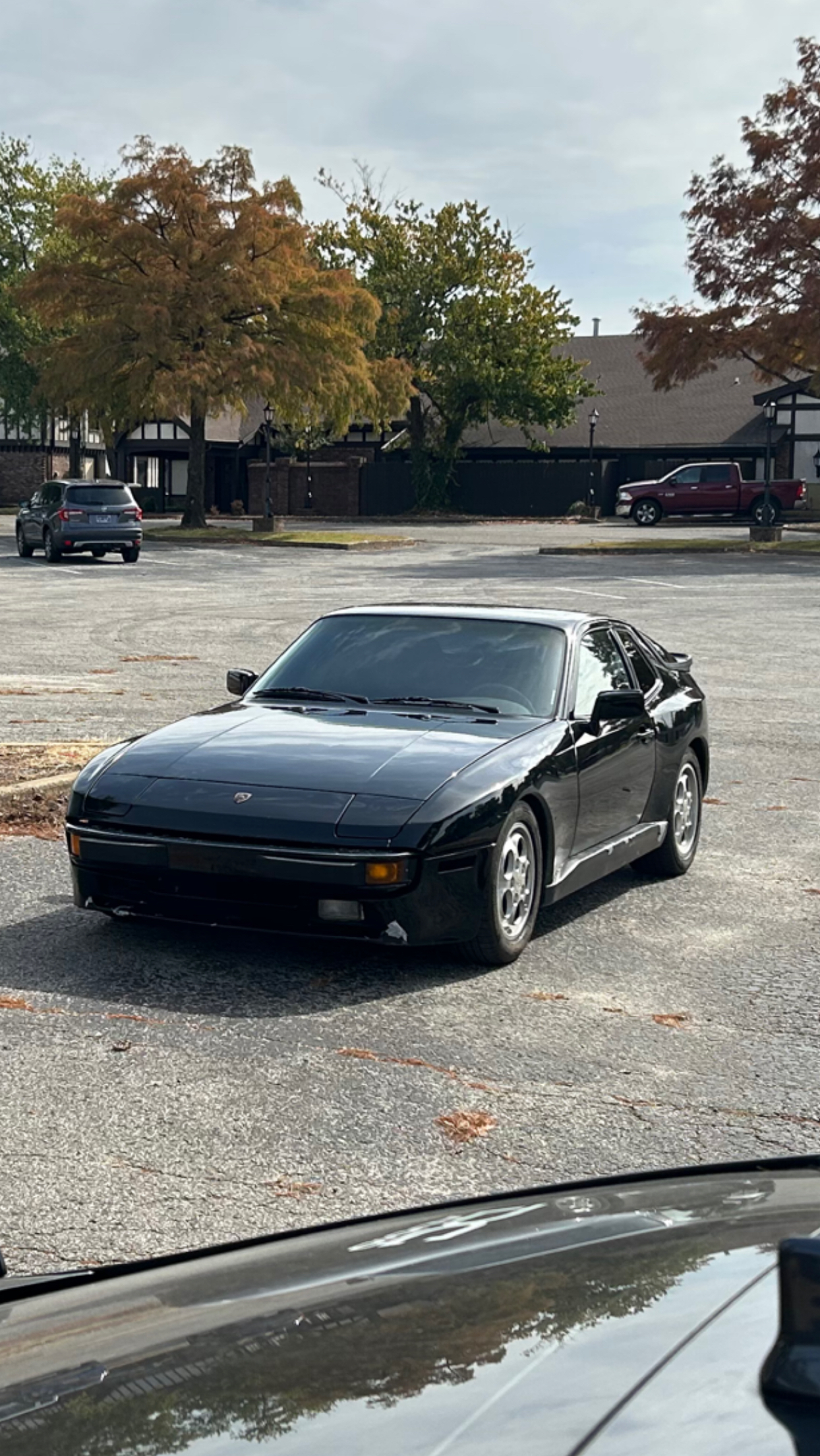

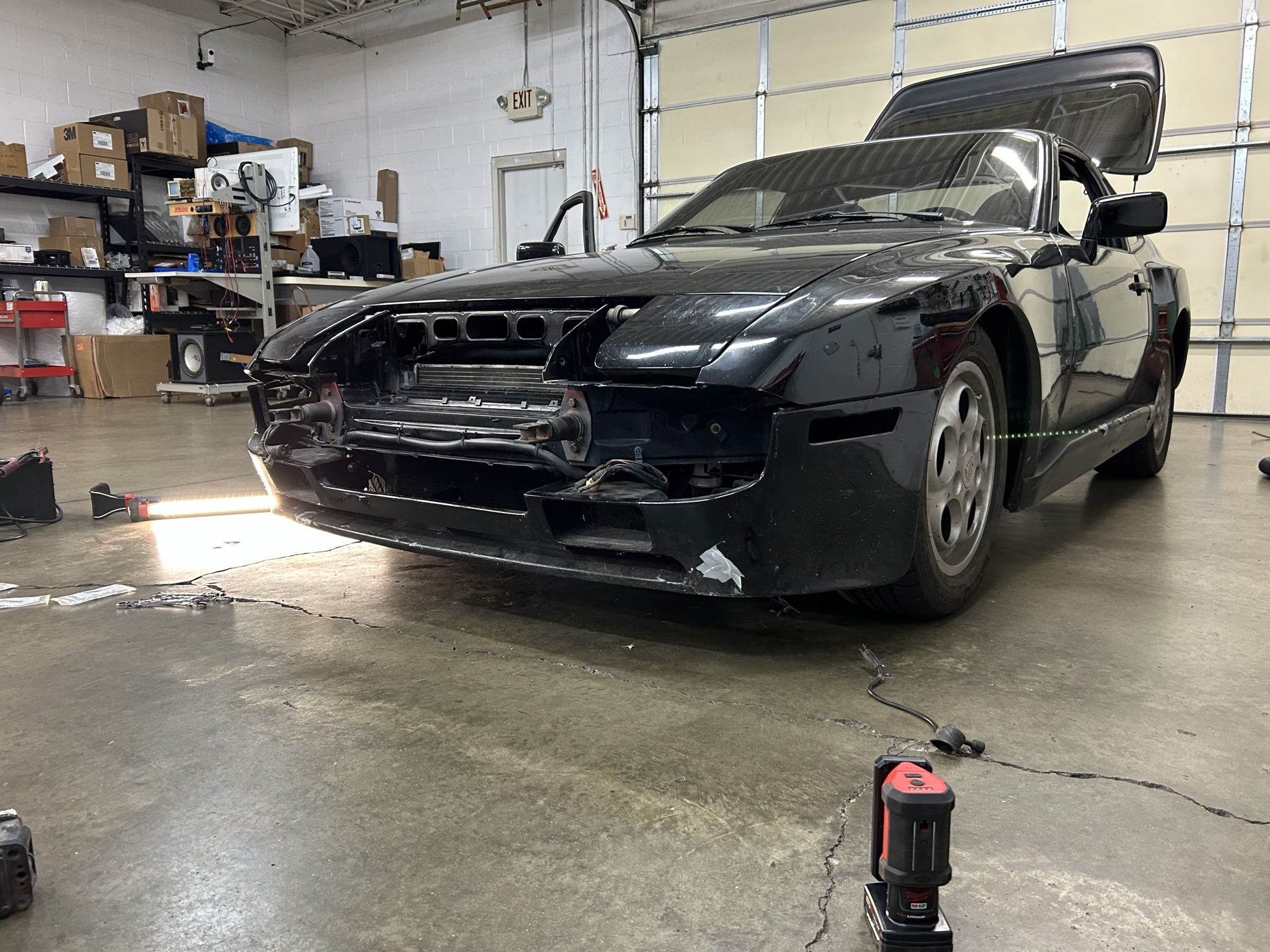

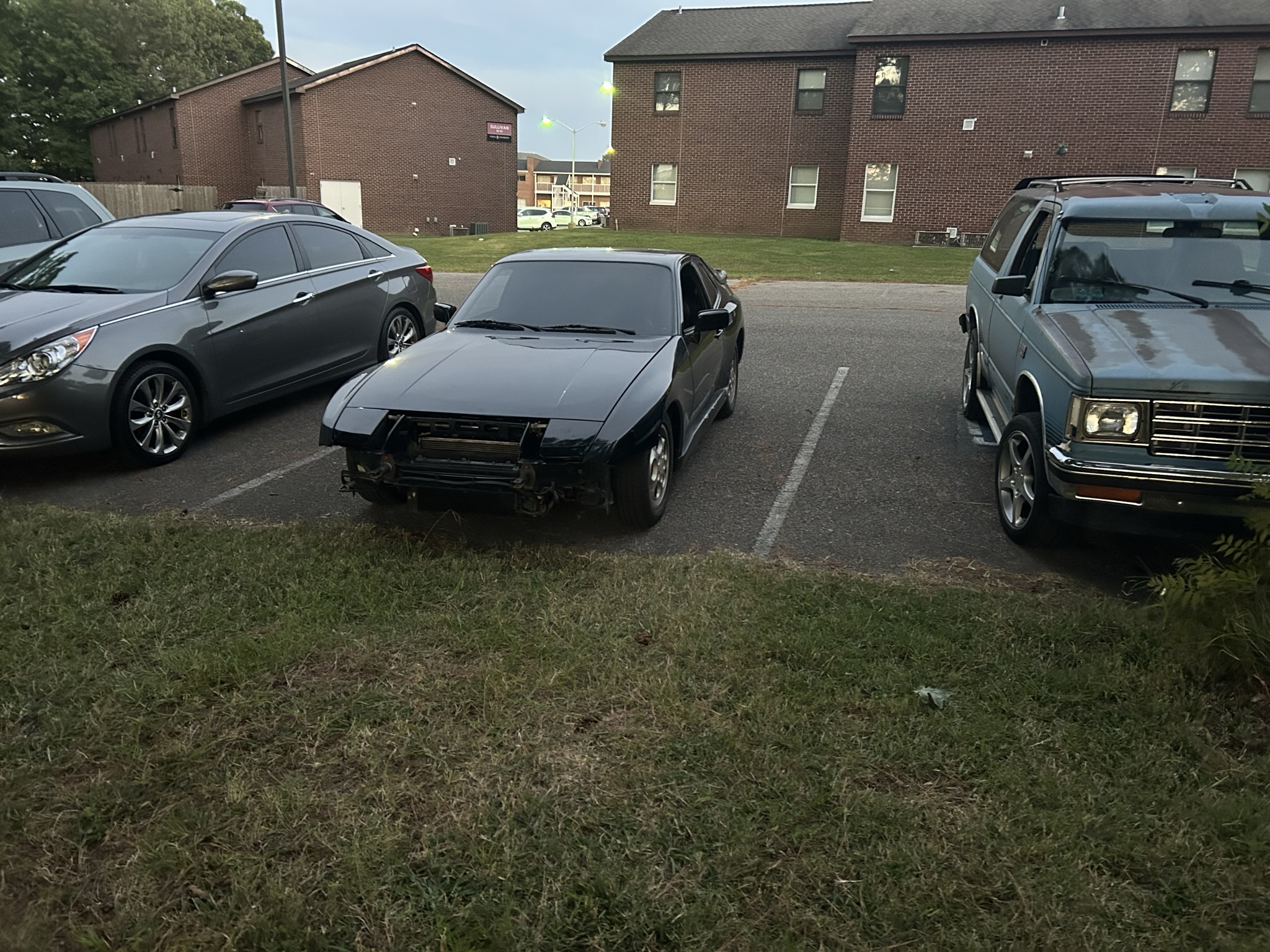

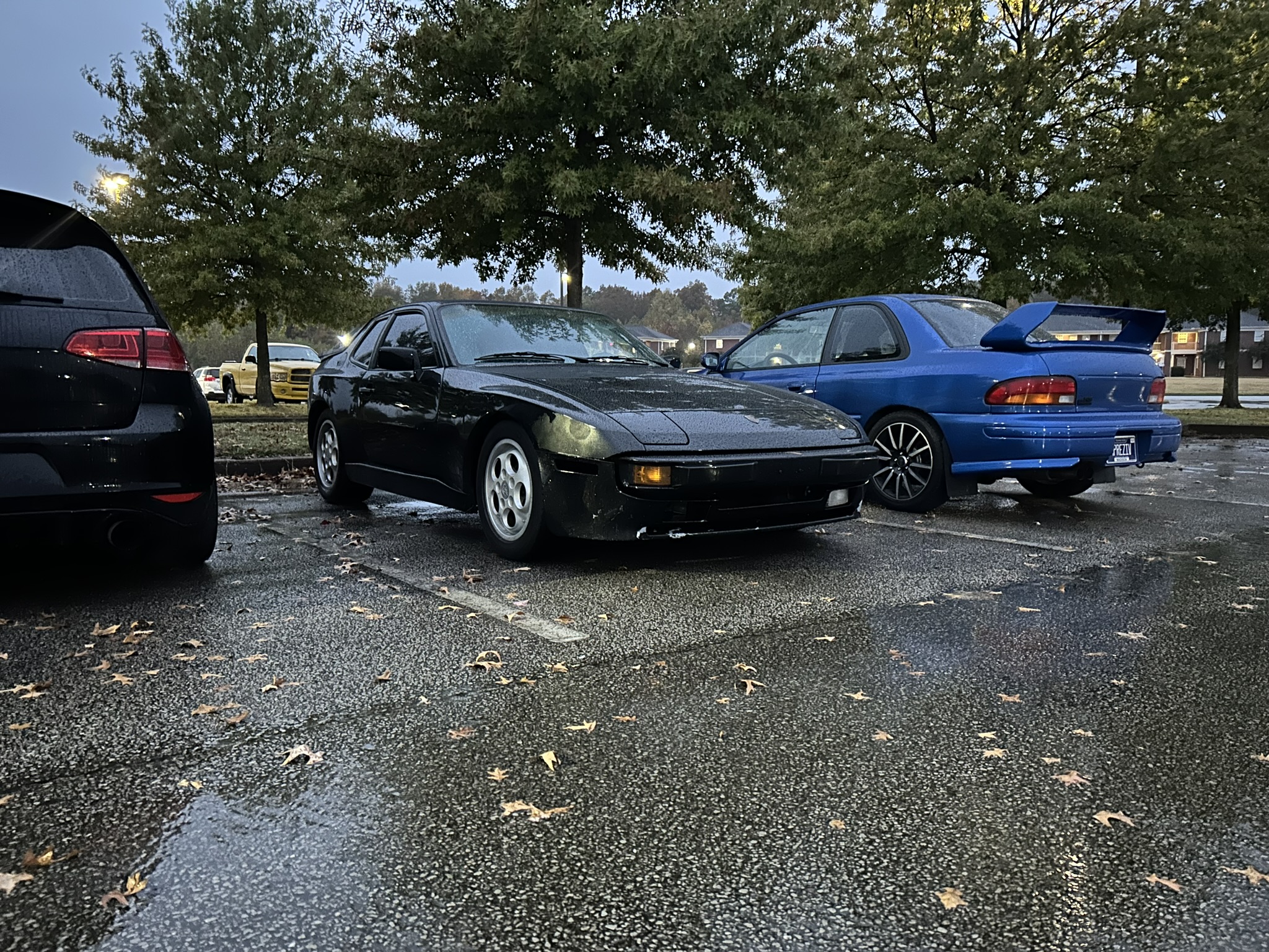

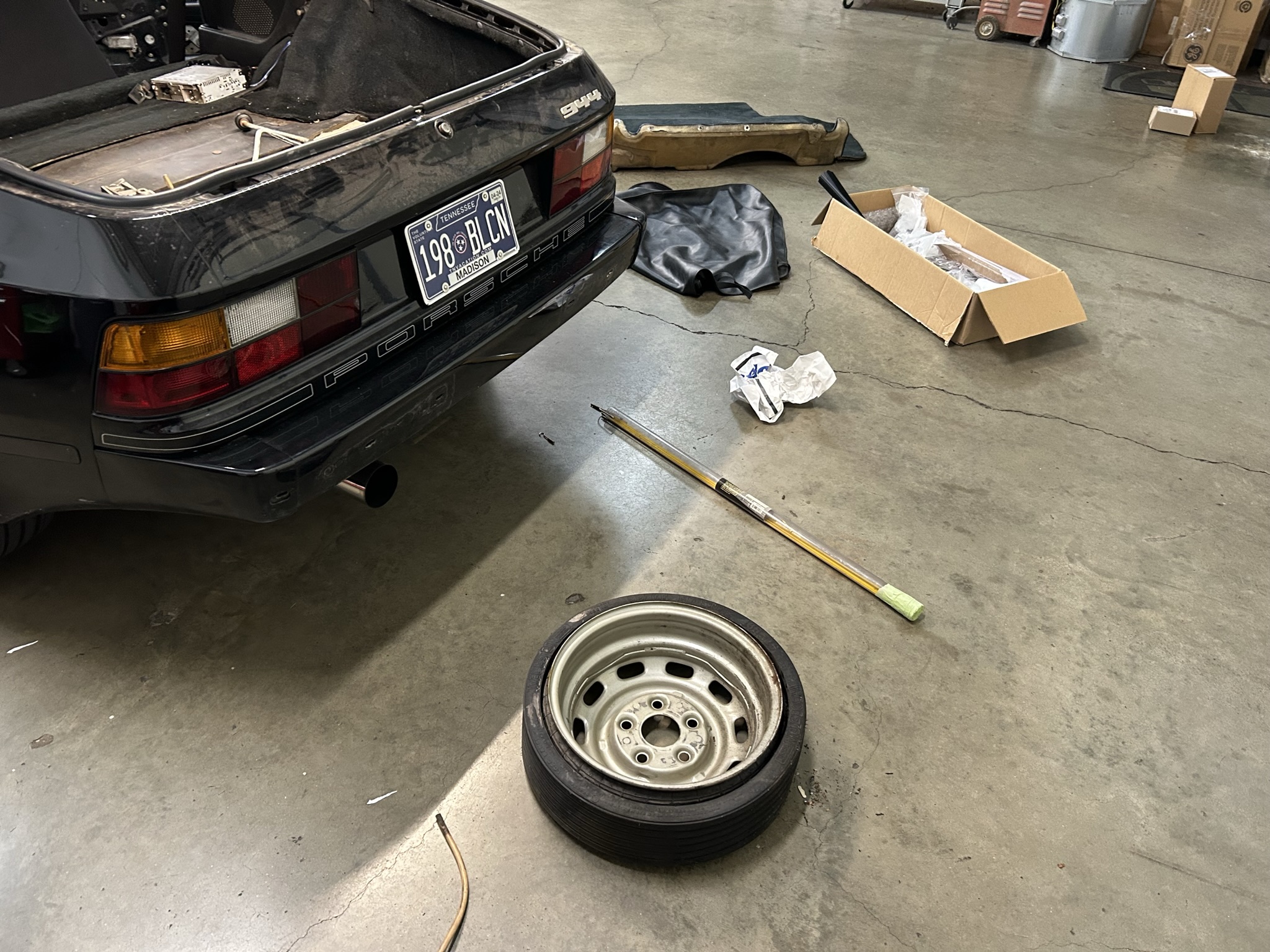

After getting the alignment, next i needed to et my exhaust fixed, so i took it to a local shop and they did a good job. Shorlty after though, the tensioning rod for the alternator/ac compressor belt came loose and dropped while i was driving. Over all this didn't cause much damage. When this happened, i noticed a sudden loud grinding type noise but i thought it came from the car next to me, only to find out at my destination that it was infact dragging on the ground. thankfully i had only driven it like that for less than 400 feet. I replaced the tension rod and bolts, put some loctite on there and called it a day. Next i put the bumper back on, and got the lights working. Shortly after i noticed something odd about the rims on the car. They sat super far inboard of the wheel wells. AND one of the front wheels sat farther in than the other one. Turns out i had 3 early offset turbo phondials, and one 928 phone dial rim. I promptly replaced the 928 rim to match the others and ordered 30mm spacers. After that i haven't really done very much. I order a master and slave clutch kit from 944 online because sometimes my pedal would go halfway to the floor and i had to pull it up with my foot, and the master cylinder had a tiny little leak. I received the kit last week but haven't had time to install it. I also went ahead and changed the oil since sooner than later since i had rebuilt the motor, and i replaced the gear oil in the transmission. I also found the car has some water leaks so i ordered all new body seals. Im pretty happy with the progress I've made so far, and had a lot of fun driving it. Currently i plan on keeping the car for a while, but will most likely be looking to sell in about a year. Given the value of porche 944's right now, i likely will not be able to sell the car for what i have put in it. I wouldn't mind some thoughts from yall on how much this car is worth, or able to sell for. Heres some photos
