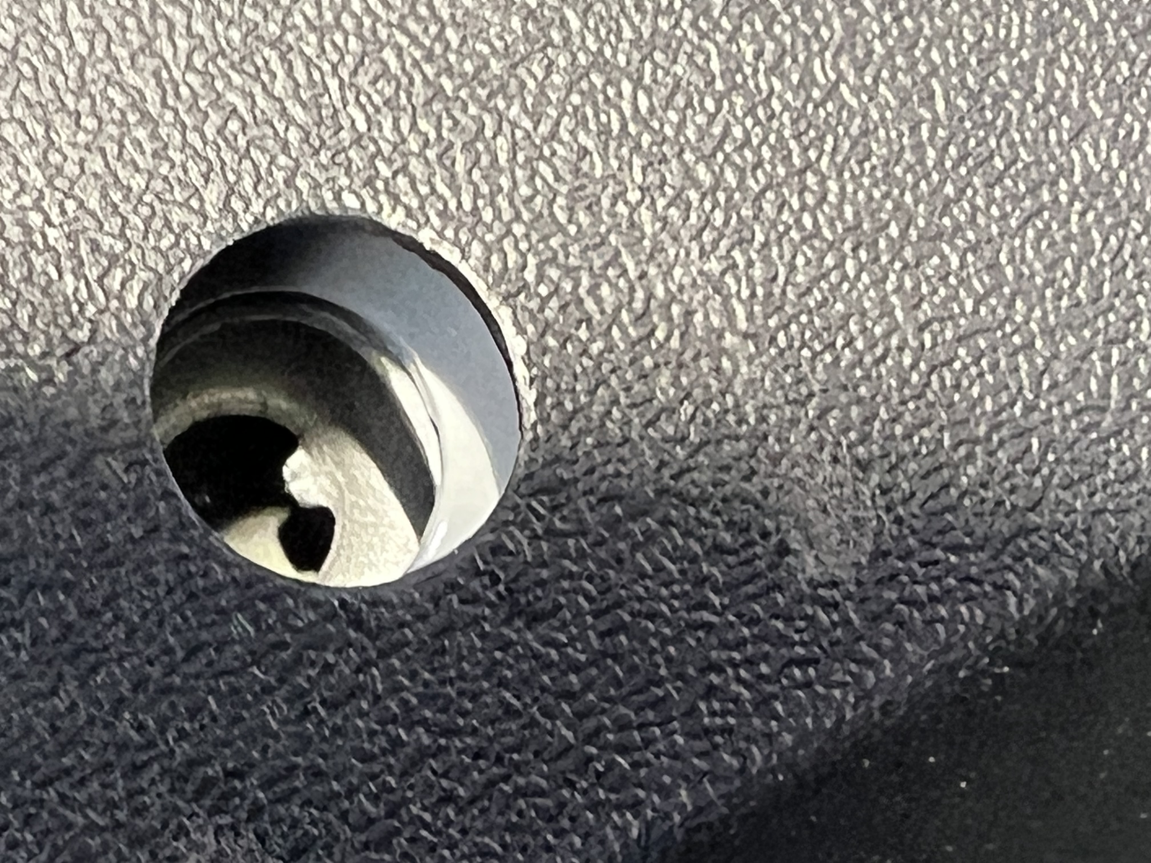

So I was trying to use my luggage cover from my other 981 GT4’s
The 718 GT4RS does not come with the luggage cover( Porsche tells you that the reason why is that they’re trying to save weight🙄)
Anyway, so I tried to use the luggage covers from my other GT4’s, and it will not attach, and it seems as the reason being is that there are two tabs that are located in the hole where the screw goes that holds up the luggage cover on the 981, but there isn’t any in the 718 gt4rs ironically, a few friends of mine that got the early gt4rs is meaning … December and January versus mine, which came in July are able to use the luggage cover I assume their car had the tabs required to hold the luggage cover screw ???
See the pictures below
The first picture is of the 981 GT4 luggage cover hole
The second picture is of the 718 GT4RS
Notice the 2 metal tabs inside the hole
718 GT4 RS
718 GT4 RS

Here is the part number from the 981 luggage cover notice the screw the reason why that one attached to that 718 gt4rs is there’s no tabs for that screw to grab onto…
Anyone with knowledge as to why this is the case would be greatly appreciated🙏

I should have included the part numbers I was given by Porsche North America today .. it differs by one number… the last number instead of 00
It’s 01
98155534101. That’s supposed to be the same cover for the 718 GT4.??
Porsche it doesn’t make new parts they use the same parts over and over again for the life of me. I wouldn’t understand why in the world they would make a cover that wouldn’t fit both 981 and 718. It’s the same ¯\_(ツ)_/¯ body.

Well yo my surprise and shock
Oh and Tom delight ….🤣
It seems that they actually did change the part which seems nothing more than shocking, defying all logic. They seem to have gone to a threaded screw. Here is a picture of the new part.
Blow me away !!!!
Re: Rear luggage cover for GT4 RS ???
Posted: Sun Oct 15, 2023 8:40 am
Glad you found your answer. Since you know people who were able to use the 00 part on a GT4RS, I'm guessing there is a VIN-split in the parts catalog, with cars up to the split using the 00 part number and cars after the split using the 01 part number. That's Just a guess, of course, but if you browse through PET for virtually any Porsche model, you see that all the time. Those crazy engineers in Germany are constantly refining. Actual threads probably attach the cover more securely that that twist-lock lug on the 00 version (or it's just cheaper... :shh: ).

Just a wild guess but I have a feeling that maybe that one have turn wasn’t enough for them to feel it was secure enough based on the fact that the car rides literally like a buckboard…. Compared to the earlier GT four so maybe that has something to do with it I don’t know my never came loose but who knows it seemed like a really kind of cool system. They had half turn locks in done…..

My GT4 is a 2021 model - build locked September 2020 and it came with the threaded part # .01 5S, so that part and configuration is not something that's new.
PS - the date code on the tabbed version pic you attached appears to be from 2010, so it stands to reason that they changed part design several years ago.
Why any of the old parts would show up on new cars, as I think you mentioned, is very odd. Maybe double check that that is in fact the case?
