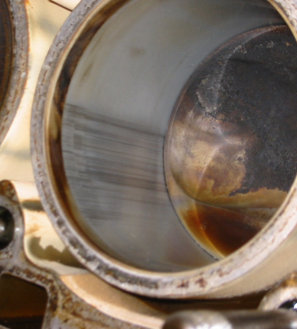

I removed the factory 951 motor from the car when I built/installed the 3 liter motor in 2008. That original 951 motor is the one I'd be rebuilding, and it still has the twice-skimmed head on it. That's the head I'd like to use if possible. The crank and rods should be good, though I'd probably get the crank polished for good order's sake. As for bigger valves and cams -- maybe, but not sure it's worth it given my goals, especially since factory smoothness and tinker-free CA smog legality are at the top of my list.
The motor is still on a stand and all assembled, just like the day I yanked it out, so I can't take pics of the cylinders right now. Below is a picture of the worst cylinder from like 2007 (from an even older camera) when I last had that head off. That's a factory 100mm bore with scoring. Assuming it's no worse now, think Millennium can bring these back to a true 100mm bore?
