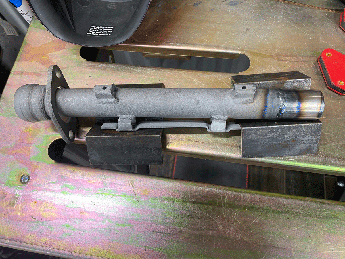

I opted to use a new section of 1.25" OD pipe. It's smooth and perfectly round, so should seal better in the slip joint. :)
New tail peace TIG'd in place and cut to length.
I had to grind down the welds on the tail piece to give the slip joint enough range to install the pipes. TIG'd the O2 port in place and then sand blasted the whole thing for paint.
Painted with Por 15 High Temp and cured for 2 hours at 400F. I have fairly low expectations for the Por 15, but figured it was better than nothing, maybe. Will put it back together tomorrow and hook up the wideband. I'm guessing it's cruising somewhere in 11 or 12 AFR range right now, but time will tell.... :)
