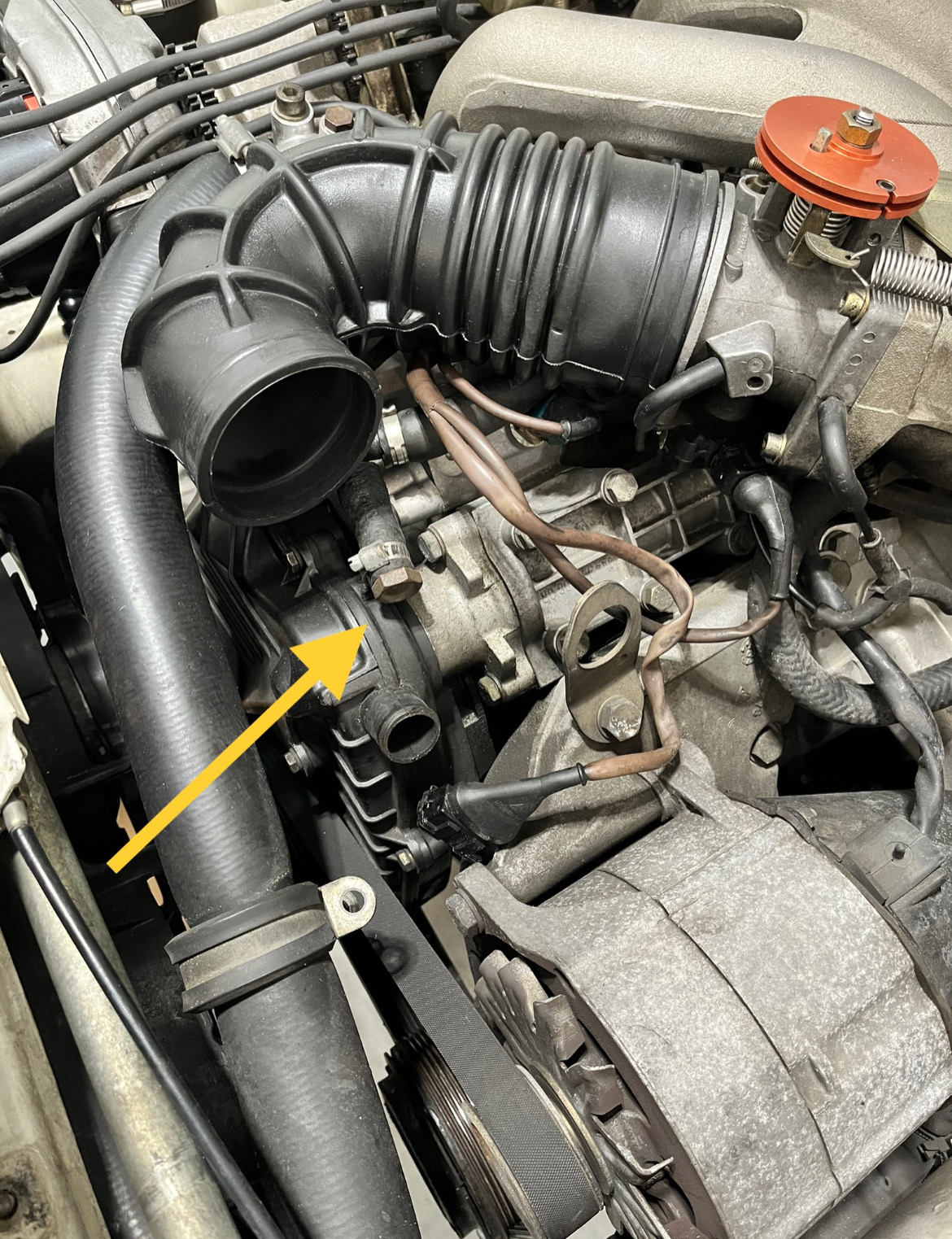

Hello carpokes, Can someone help me identify why this vacuum line would be plugged off with a bolt? Where should it have originally connected? Thanks

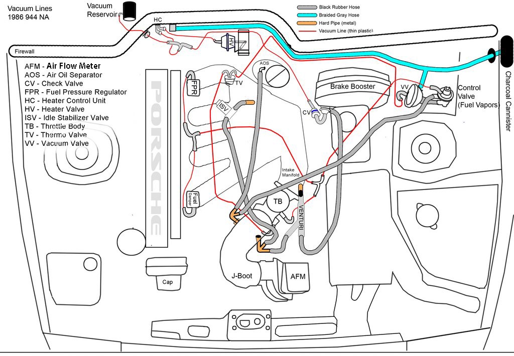

May help.
944 vac2.jpg (211.97 KiB) Viewed 347 times

Looks like someone may have done a venturi delete on your car.
