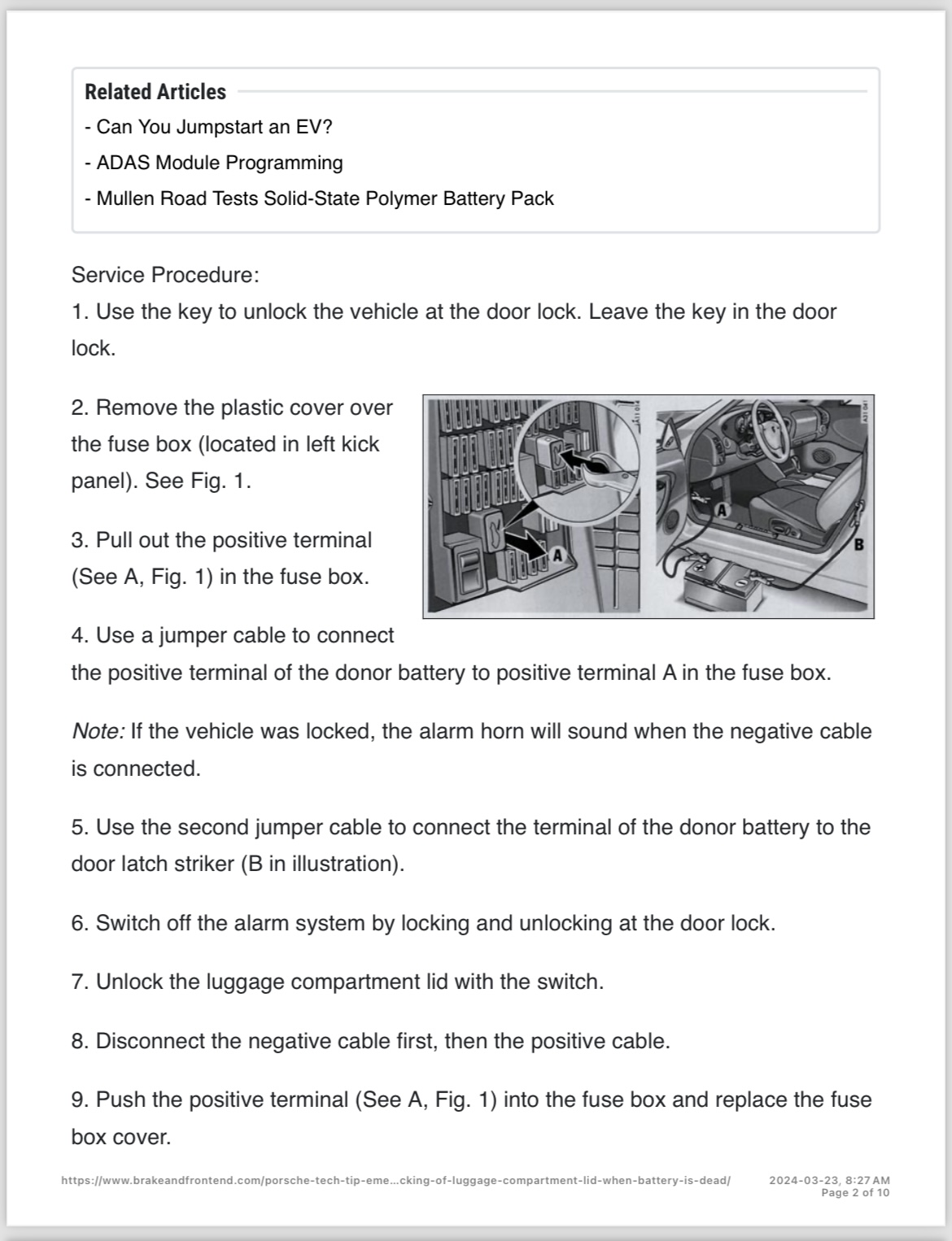

Re: 986 Frunk Locked with Dead Battery
Posted: Sat Mar 23, 2024 5:30 am
by P_Coastal
For a 986, very similar
