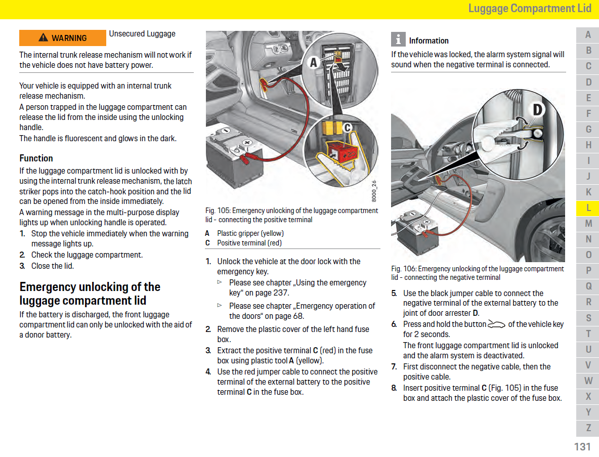

This might not help for your 986, but here's a screenshot of my owners manual's instructions for a 718 Cayman with the same situation as yours:Doc423 wrote: Tue Aug 15, 2023 12:16 pm Need some help; battery tender in the frunk went out on my 986; tried pull-out jump fuse in the fuse box in driver's footwell, no work because battery totally dead; at this point what can I do to get into the frunk to install new battery???![]()
On the driver side wheel well, reach over the wheel and run your hand vertically just behind the top of the wheel. You will feel a cable. Pull the cable. It will open the Frunk.
