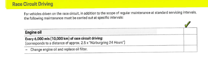

By the way, the "Driving on the Circuit" manual book does say to change the oil more frequently if driving on track but the interval and the book's entry are an absolute hoot! (Or scary, depending on one's POV!) Screenshot from the manual regarding oil/filter:
GT4 'Race Circuit Driving' engine oil screenshot 2023-08-12.png (70.01 KiB) Viewed 920 times
Using 2½ Nürburgring 24-hour drives to approximate when to change oil/filter is absolutely HILARIOUS!!!

Crap, 2 1/2 Nurburgring 24 hour drives to an oil change ...................that takes optimism to new heights. I imagine I would want to change it every 1000 track miles since that will likely happen after about 4 full weekends. I have been in a habit of changing after every two race weekends for a very long, long time. With the difficulty changing the fluid in a Cayman I may try and extend it a bit, especially since friends are telling me they are still going bit longer that. Interesting data, my friend, and that gives me a baseline.

Yep on the trans and the diffs. With the Z06 racecar, I changed both quite often.
As for the oil/filter, yes, you can extend that on the Porsche from what you have been used to in the past, considerably longer if you want. 1,000 to 1,500 miles will be fine, longer if you want. You'll be able to gauge it after a season.
