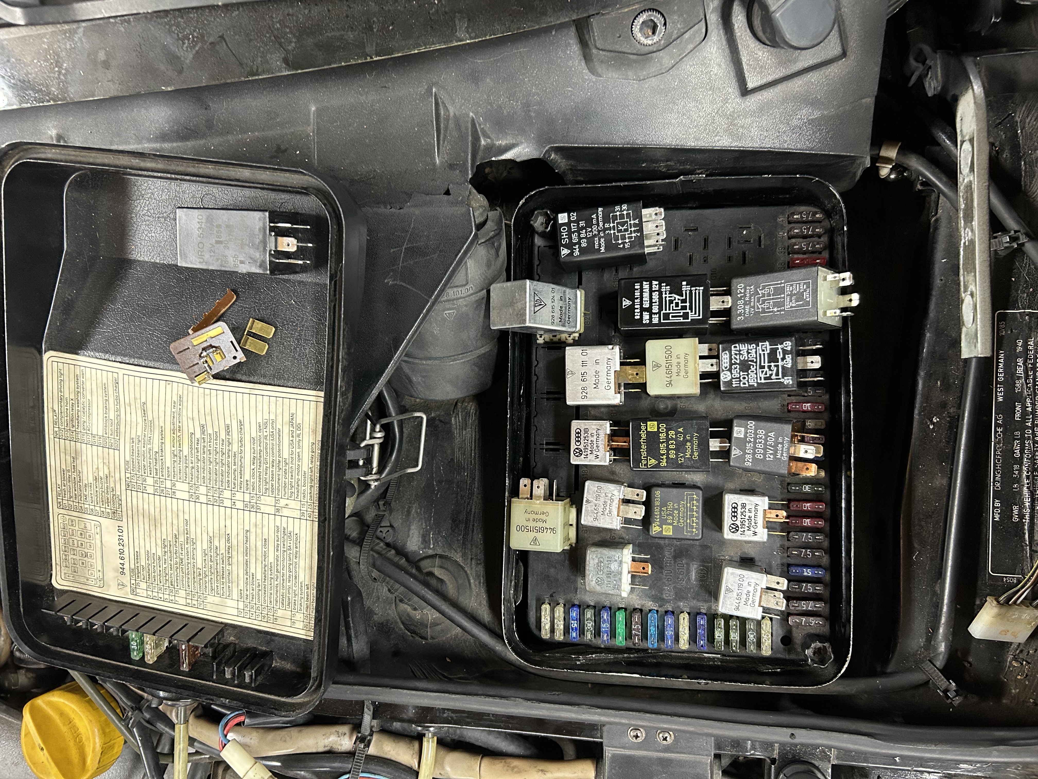

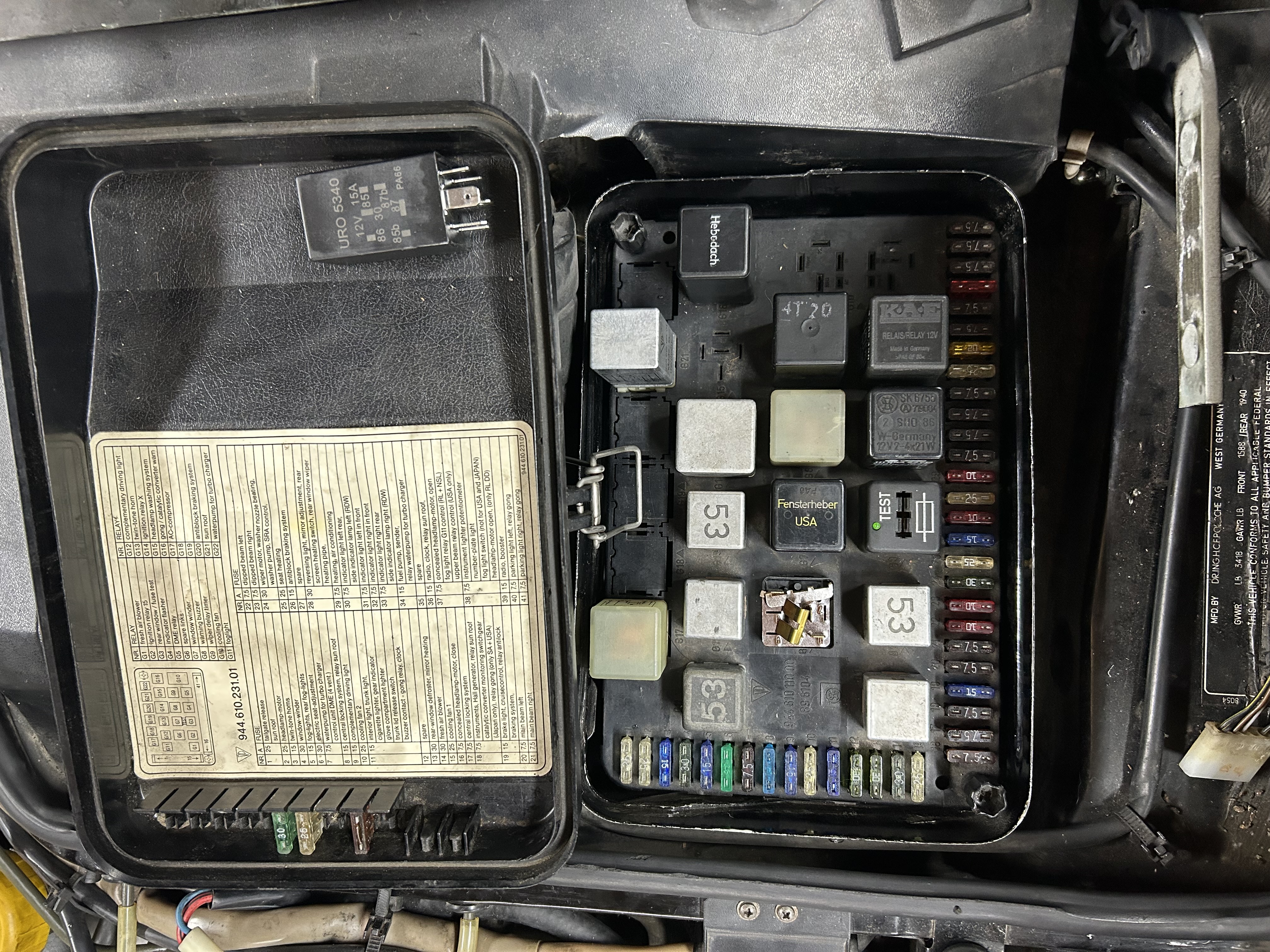

Ok so now that i’m getting close to being able to drive my 944, i thought i may as well attend to the smaller interior issues and electrical issues while i wait for parts to arrive. Here are a few photos showing the relays in their current position.
I do realize i am missing my g10 fan relay, i have a used one i’m getting soon. But i was curious if anyone who has a 944 just like mine could let me reference their correct relay setup so i can make absolutely certain i have the right relays in the right places so that when/if i need to diagnose other electrical issues i’m not chasing my tail. Right now the problem i was concerned with was my sunroof not working. It appears the motor for my sunroof is in the rear driver side quarter panel and has two brown relays mounted to it. My sunroof currently does not operate at all. I verified the fuse is good so far and that there is power at at least these two
terminals at relay spot g21.

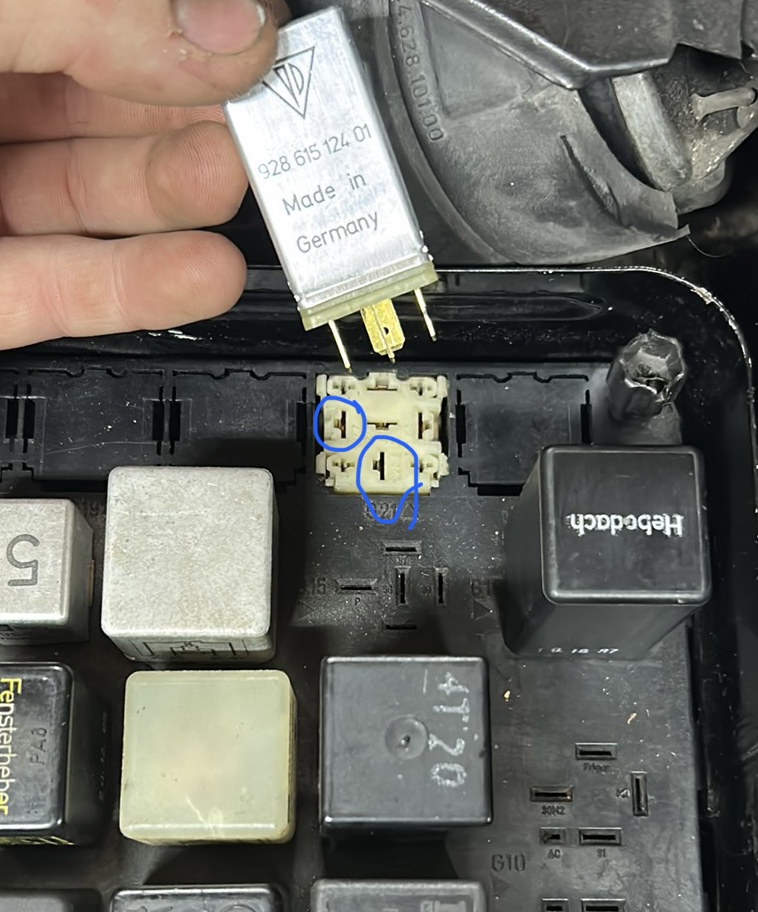

Also note that whenever i place that silver relay in my hand into spot g21, the fuse for the sunroof circuit, number 8, pops. Also my pop up and down headlights do not, well, pop up and down. Currently the headlights are not installed, but the motor still does not operate. Before i go checking power at different wires for all these problems i want to verify my relays and that they are in the right spots. That is the main reason for this post. As to the actual reason why these different accessories don’t work, im confident i can figure out, although any tips are greatly appreciated, but for the most part i just need relay info.

I checked this out and it was pretty helpful although it wasn’t a total match to how the relays are in my car. mine has a spot for g21 relay but they don’t even list that one on the PET. In the PET it says it’s for an 88s2944 so idk if that’s the difference

Here's my fuse box (central electrics) from my 1987 944na. The flasher relay is aftermarket (with an adjuster knob for LED turn signal rate control, adjacent to the DME relay). Otherwise, I believe everything else in there is stock.

The 928 615 124 01 relay is for ABS. Superseded by 03 if that helps. It's listed for 86.5-on 928 cars, pretty much all the 928's available with ABS.

When i put the sunroof relay i have into that spot the fuse no longer blew, so i think the abs relay was causing that issue, but i’ll check out that clark’s garage information later this week once my new relays arrive.
