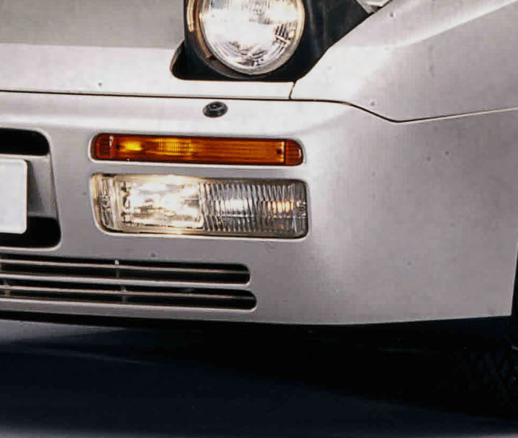

Is this about the clear lights (under the amber) in this picture? Pelican still seems to list them for sale, albeit with a hefty price tag. Or is the issue that folks want them in polycarbonate so they are less likely to break? Maybe that's some Carpokes should partner up with @Rennbay to make... :think:

Tom wrote: Mon Aug 07, 2023 8:53 am Is this about the clear lights (under the amber) in this picture? Pelican still seems to list them for sale, albeit with a hefty price tag. Or is the issue that folks want them in polycarbonate so they are less likely to break? Maybe that's some Carpokes should partner up with @Rennbay to make... :think:
Yes Tom - it's a little bit of both! Brand new lenses are still available and come with the entire housing assembly from Porsche. I ordered them from an online dealer and they had to get them from Germany which took over a month. I believe I paid around $300 for each side and this was a few years ago.
That is extremely expensive given one well placed stone on the highway can crack or shatter the lens. I reached out to only944.com previously and he stated his vendors weren't interested in reproduction polycarb or plastic replacements, due to the cost of the molds. Carpokes to the rescue?
