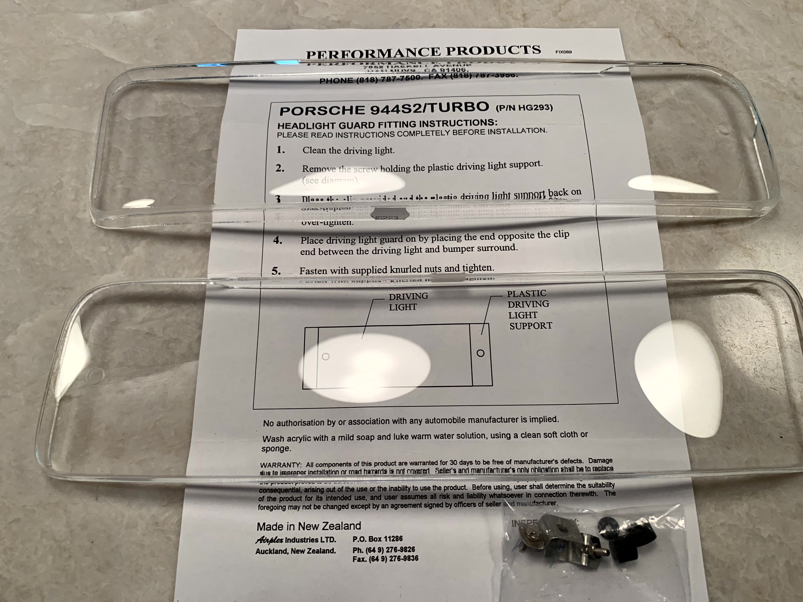

I have two sets of what appear to be polycarbonate lens covers for the fog/driving light combo on the 944 S2 or 951. I purchased them 23 years ago from Performance Products, along with the Bosch Euro Driving/Fog Lights. All never installed. It's a familiar story... "When I get the car repainted, I'll install these."
I can dig them out and post a picture. They may even have a tag indicating who made them as my Excel spreadsheet doesn't include that info.

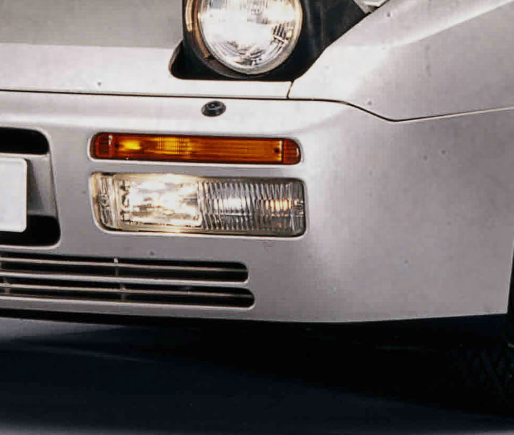

Is this about the clear lights (under the amber) in this picture? Pelican still seems to list them for sale, albeit with a hefty price tag. Or is the issue that folks want them in polycarbonate so they are less likely to break? Maybe that's some Carpokes should partner up with @Rennbay to make... :think:

Tom wrote: Mon Aug 07, 2023 8:53 am Is this about the clear lights (under the amber) in this picture? Pelican still seems to list them for sale, albeit with a hefty price tag. Or is the issue that folks want them in polycarbonate so they are less likely to break? Maybe that's some Carpokes should partner up with @Rennbay to make... :think:
Yes Tom - it's a little bit of both! Brand new lenses are still available and come with the entire housing assembly from Porsche. I ordered them from an online dealer and they had to get them from Germany which took over a month. I believe I paid around $300 for each side and this was a few years ago.
That is extremely expensive given one well placed stone on the highway can crack or shatter the lens. I reached out to only944.com previously and he stated his vendors weren't interested in reproduction polycarb or plastic replacements, due to the cost of the molds. Carpokes to the rescue?

Latitude48
Posts: 360
Location: Seattle Area
Has thanked: 105 times
Been thanked: 113 times
Here's a picture of the fog/driving light covers. Surprisingly, they are still available direct from the manufacturer in New Zealand. In US dollars the price is a bit over $71/pair, which is pretty cheap to protect expensive lights. These are UV stabilized Acrylic. Here's the link: https://www.airplex.co.nz/product/1549- ... clear-pair
