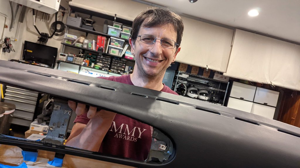

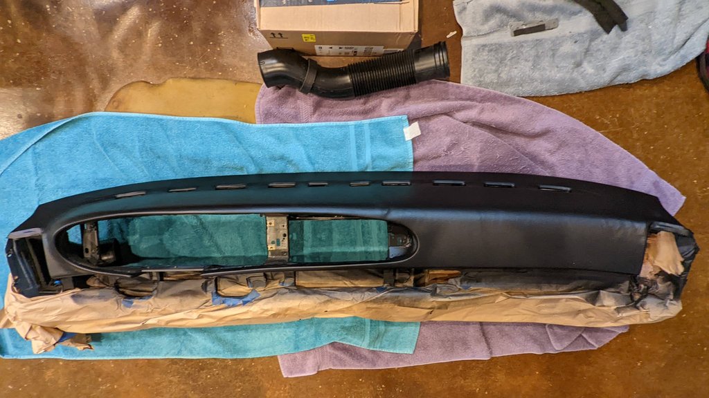

Last summer, I re-covered my stereotypically-cracked dash (as well vinyl paint the light colored portion of the dash and door cards with wonderful results).
Aside from the smell of the contact adhesive - which is truly powerful - it wasn't super difficult.
However, the material lining the defrost vent openings along the windshield hasn't remained well adhered.
Does anyone make/sell some kind of plastic clip/grommet to surround the vent holes for general "make it pretty" purposes?
I don't have pics of the new vinyl lifting away from the vent holes, but I do have a a few pics of me being really darn proud of finally taking care of the dash cracks.

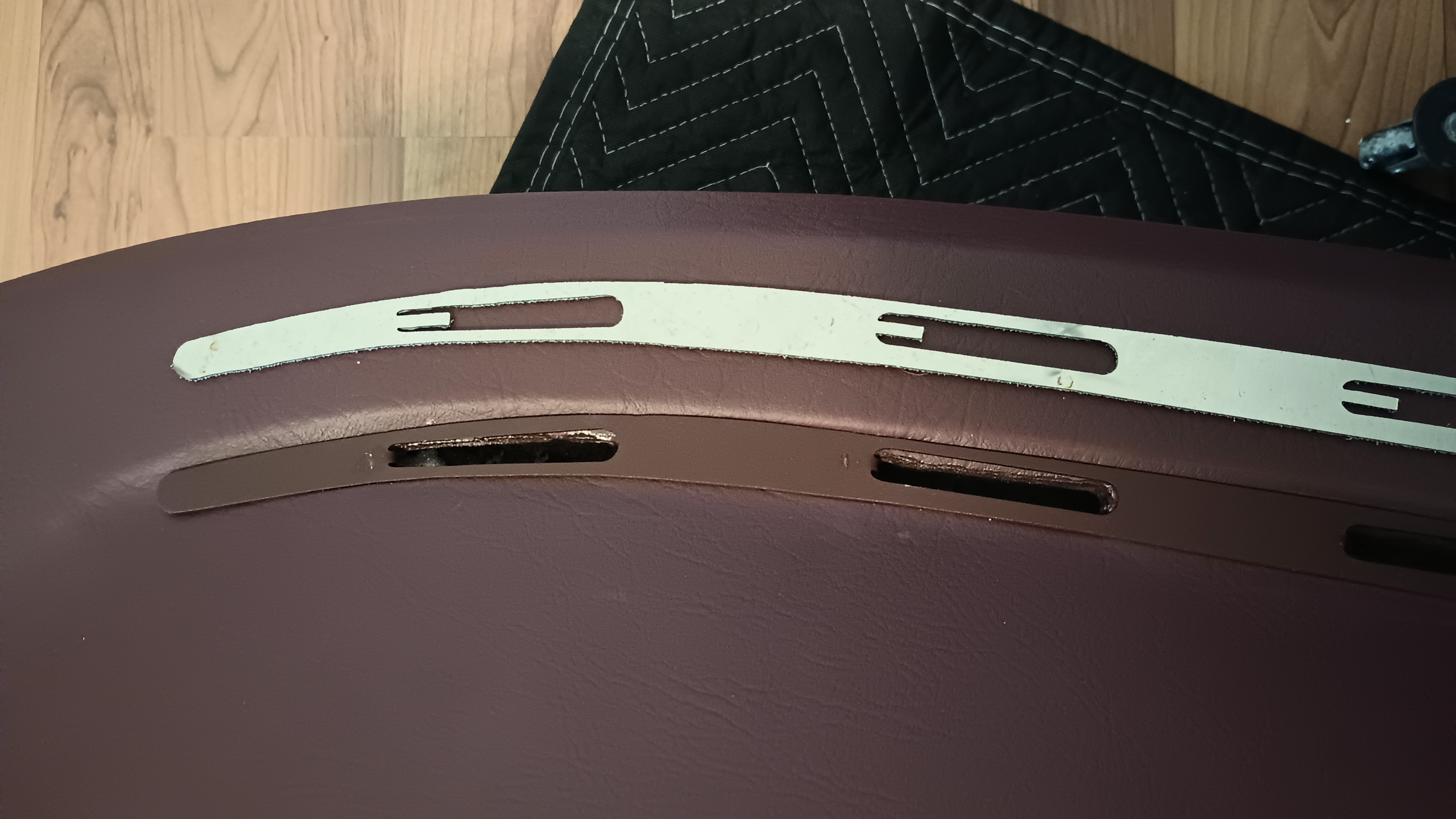

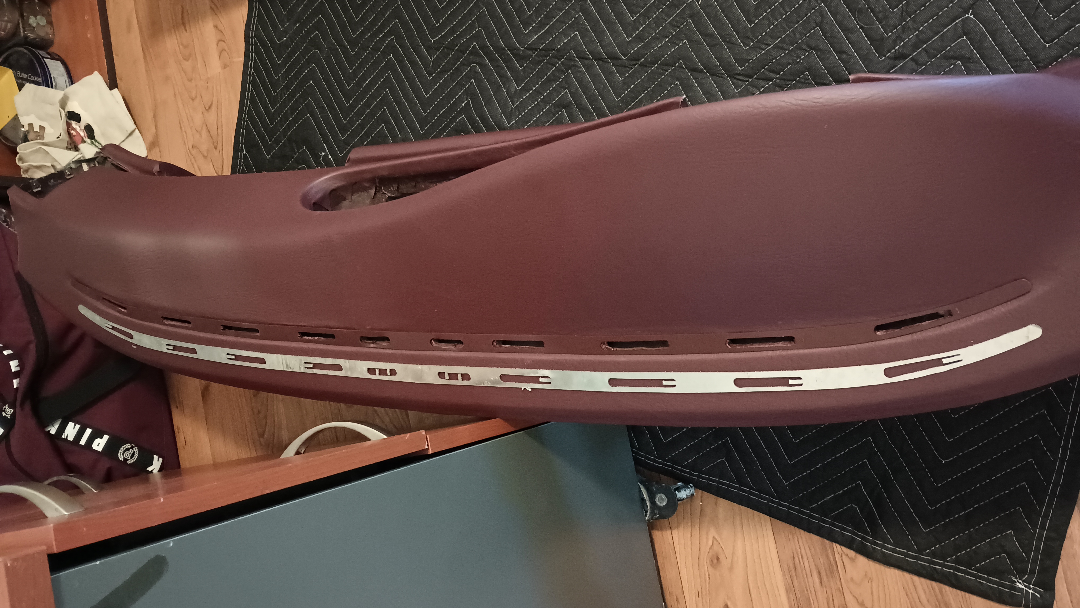

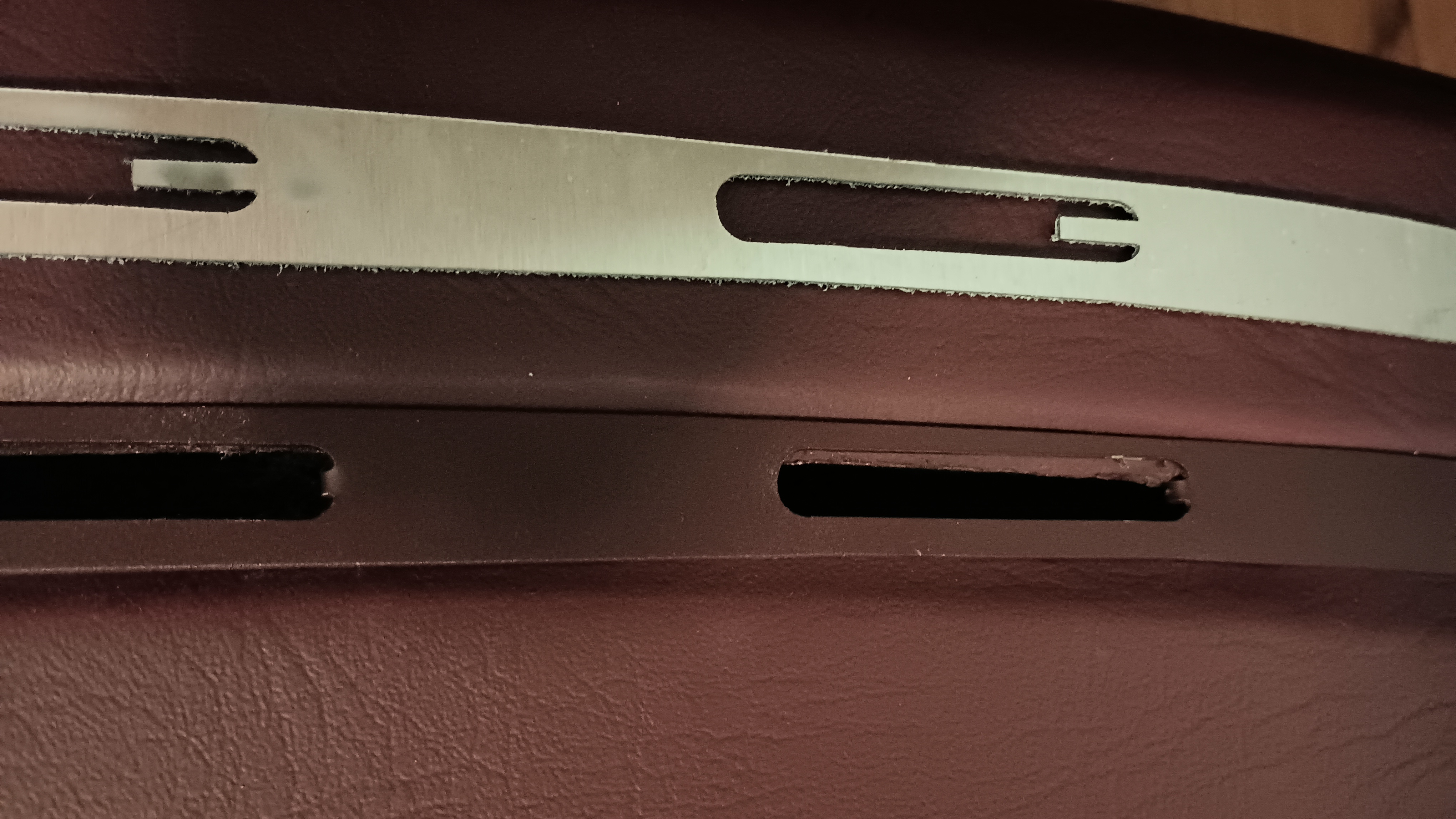

So, I started recovering dashes, and my main problem was exactly this. I got a Classic 9 insert from another Porsche enthusiast that we made some parts for, but I hated the fitting, the holes did not matc, they had to be drilled etc, etc. May be I am too anal on some things but I did come up with a part that we will be using and have available for anyone who needs to refurbish or has already refurbished their dash.
My metal part is water jet cut, and can be painted to match. It attaches with tabs that work as clips to keep both the part and the vinyl in place.
I am in FL, and thus we need a/c 9 months a year. With the separation of the vinyl, the air is routed differently than oem, and gives you spots of mist in the windshield (outside, which make me crazy).
So here it is, if anyone is interested.
This shows one in stainless and one already painted and installed.
This shows a detail of the tabs.

@j.samper, how can I buy this? This is exactly the thing I need.
I wasn't looking forward to removing my already-installed dash enough to drill holes for the "Classic 9".
Re: Defrost vent opening beautificaton?
Posted: Wed Jul 19, 2023 12:38 pm
by j.samper
usury wrote: Wed Jul 19, 2023 12:31 pm @j.samper, how can I buy this? This is exactly the thing I need.
Yes, this you can bend the tabs with the dash installed (a little tricky, but can be done) using the tools for hose removal that most of us already have.
I do not have a price set yet, but if you are willing to paint, use and give me feedback, just pay shipping.
