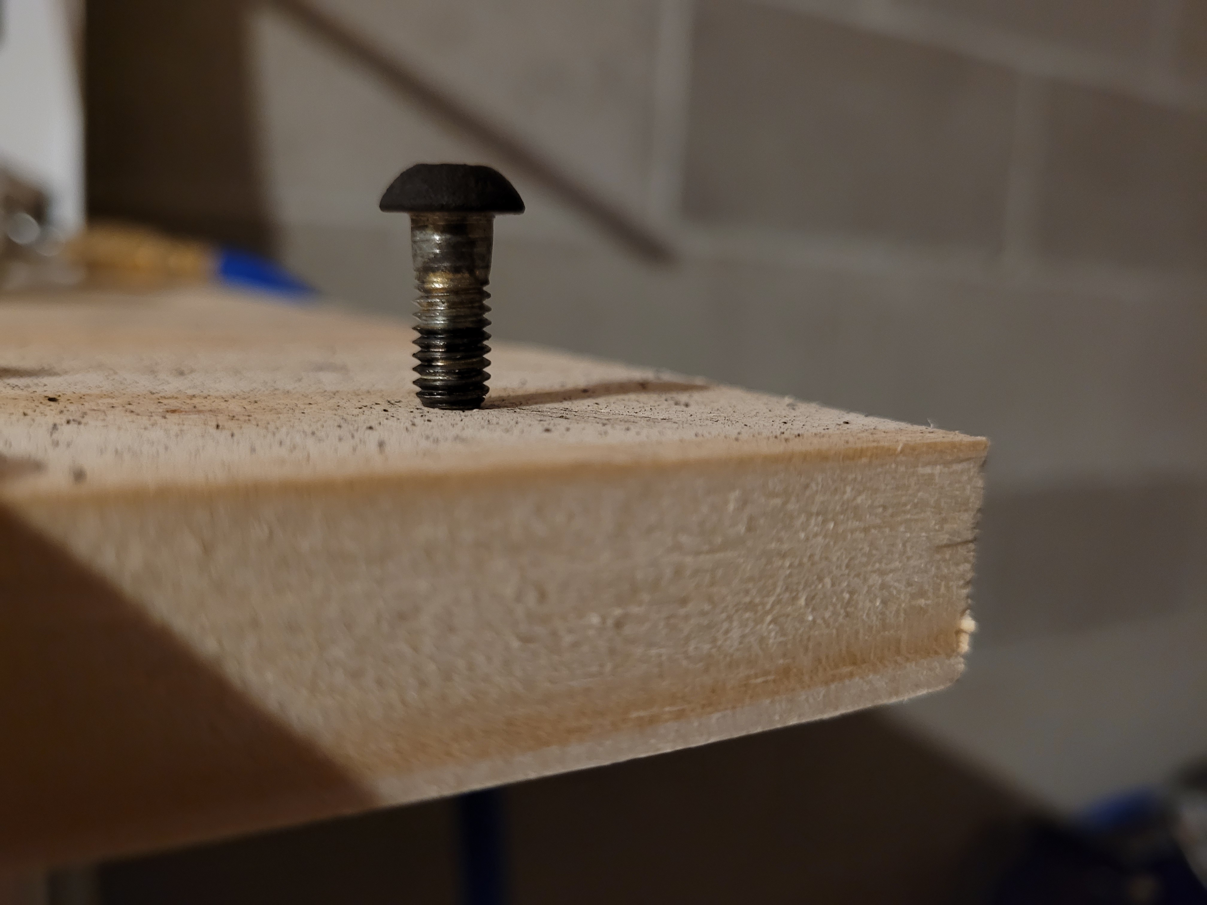

So I have another set of calipers and I was hoping to remove the slide plates to clean them up. That would mean destroying some of the screws since they're stuck in there pretty badly.
Unfortunately I'm not sure if I can replace them now. I got one of them out, and it turns out they're weird screws with a tapered unthreaded part:
Can you buy these anywhere? I compared a 6x1mm socket head screw, and it really does't fit the same. The holes in the plate are slightly wider, just right for the tapered screw. The ordinary ones leave a tiny bit of play. It might not be a big deal once it's all tightened up - but then, why are they like this at all? Does it matter that much? Would I get away with ordinary screws?

Darwin wrote: Sun Sep 26, 2021 7:00 pm Is this what you’re looking for?
https://www.paragon-products.com/Calipe ... 959.01.htm
The screws, yes, but not the plates.

If you’ve already gone through the trouble of removing them, why not replace them?
