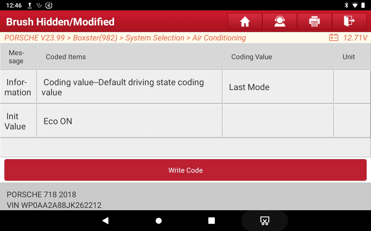

The first one is a big one. I changed the config so that the car remembers the state of the Auto-Start/Stop button on start up. I have A-S/S turned off now, and the car remembers and starts up with it already off. I don't have to remember to hit the button every time I get in the car. This config apparently only remembers the A-S/S and PASM button states. PSE, PSM, etc. are not remembered.
Remember Auto Stop/Start (ASS)
Two changes.
  • SYSTEM SELECTION> AIR CONDITIONING> Coding value--Default driving state coding value = Last Mode
    {Default: Eco ON}
Console buttons-1.jpeg (425.77 KiB) Viewed 11326 times

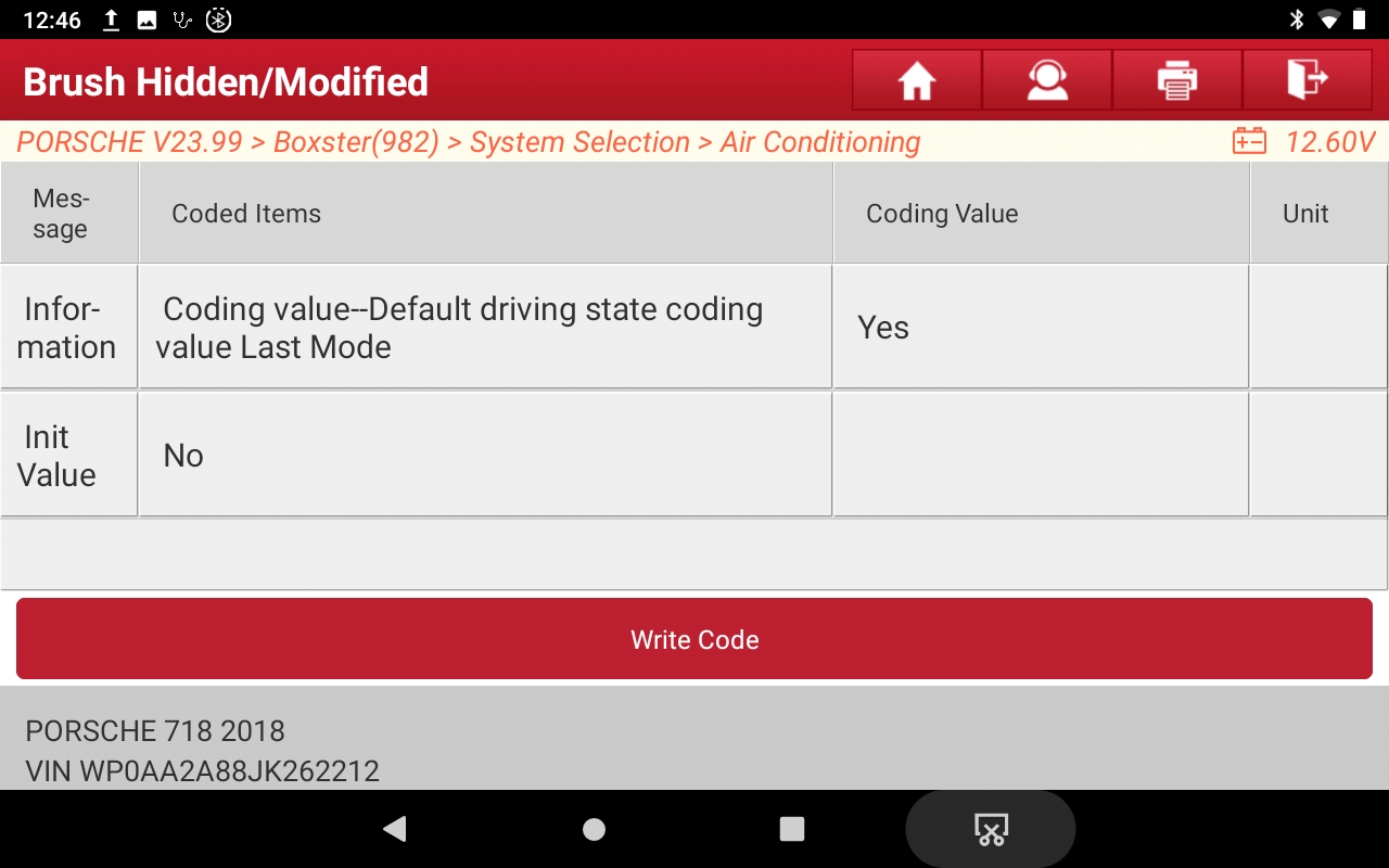

  • SYSTEM SELECTION> AIR CONDITIONING> Coding value--Default driving state coding value Last Mode = Yes
    {Default: No}
Console buttons-2.jpeg (427.15 KiB) Viewed 11326 times

With the auto start stop programmed to remember the last setting, does the car still always start in original driving mode or does it remember the last driving mode? E.g., I usually drive in individual mode but the driving mode always defaults to original mode upon car start up. I then turn the driving mode knob to individual that also turns auto start stop to OFF.

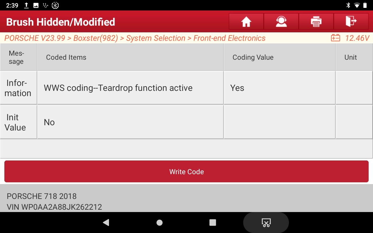

Larry C wrote: Tue Apr 11, 2023 7:33 pm Thanks for posting this. Pardon my naivety, but what is the “teardrop wiper?”
This function activates an additional pass of the wiper 8-10 seconds after the washer is used and normal wiper mode is finished. The idea is that the additional swipe will clear the remaining drips of washer fluid.
Teardrop Wiper
  • System Selection>Front-end Electronics> WWS Coding> WWS coding--Teardrop function active = YES
    {Default: No}
Wiper teardrop.jpeg (421.88 KiB) Viewed 11308 times

Larry C wrote: Tue Apr 11, 2023 7:52 pm With the auto start stop programmed to remember the last setting, does the car still always start in original driving mode or does it remember the last driving mode? E.g., I usually drive in individual mode but the driving mode always defaults to original mode upon car start up. I then turn the driving mode knob to individual that also turns auto start stop to OFF.
No, it only remembers the actual A-S/S and PASM switches in the console. Rather limited for GTS or other Sport-Chrono equipped cars. None of the other consoles switches or the drive modes are saved.

blueline wrote: Tue Apr 11, 2023 8:01 pm This appears to function similarly in some ways (or achieve a similar end result, anyway) to Windows Registry edits and changes.
Similar process, and similarly cryptic descriptions. And sometimes the path makes no sense. It took me a long time to find the A-S/S bit. Who would have thought that would be configured in the A/C controller?
