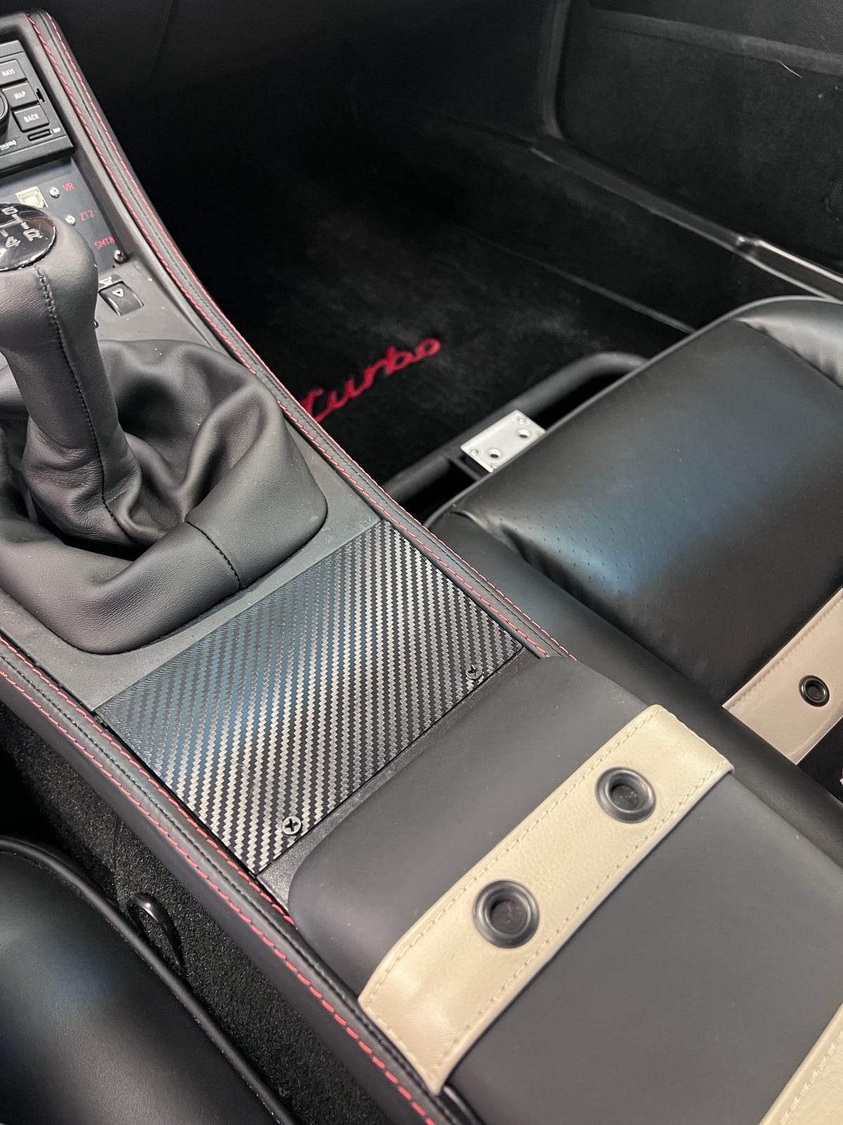

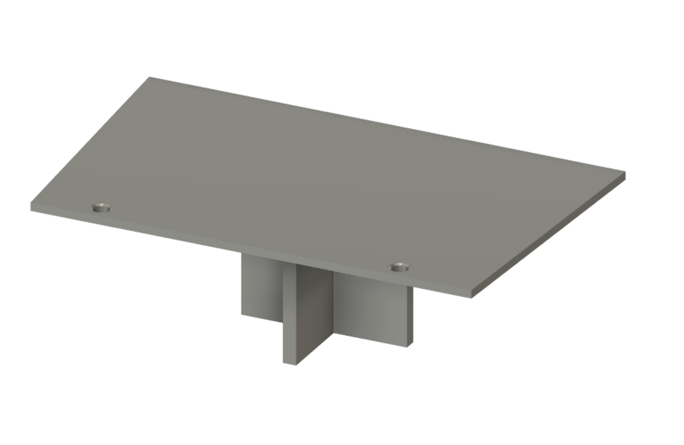

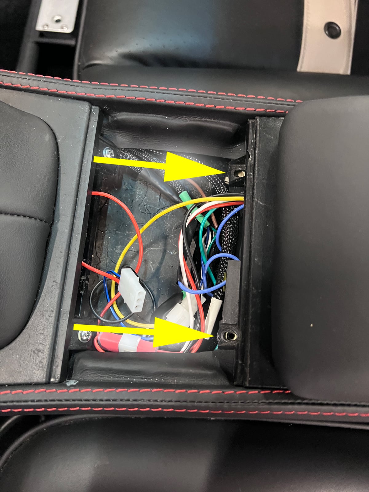

This is a blank panel to install in the place of the ashtray in an oval-dash 944. It is secured in place by two #6, 1-3/8" (35mm) screws that go into the speed-nuts normally used for the front of the center console armrest panel. (The screws now hold both the arm rest panel and the ashtray panel in place.) I opted to add a support structure underneath to add strength to the panel.
I printed this one in ABS, using a textured build plate that creates a carbon fiber look. The model is smooth on top, so you'd only get this look with a similarly textured build plate.
