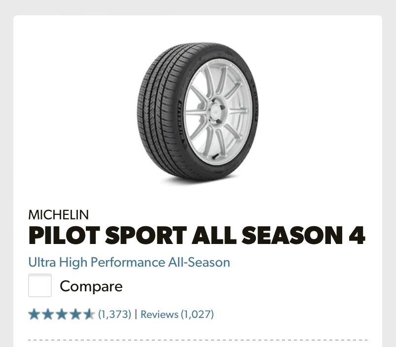

For over 20 years I have mostly had a UHP Summer set, and a Winter set (often Bizzaks). Winters are generally -1” from Summers. When the OEM HP Summers are done sometimes I replace them with UHP A/S. This is an evolving category that is often misunderstood. The current tire technology of this class is amazing. For me this is not used all year, but to extend and make more flexible the summer season. I can wake up to 5 degrees C on July 15th. Prime candidate in the class:
- 4BFFB63C-C46B-4D0D-AAA5-5DE47E41ED12.jpeg (80.08 KiB) Viewed 1733 times
