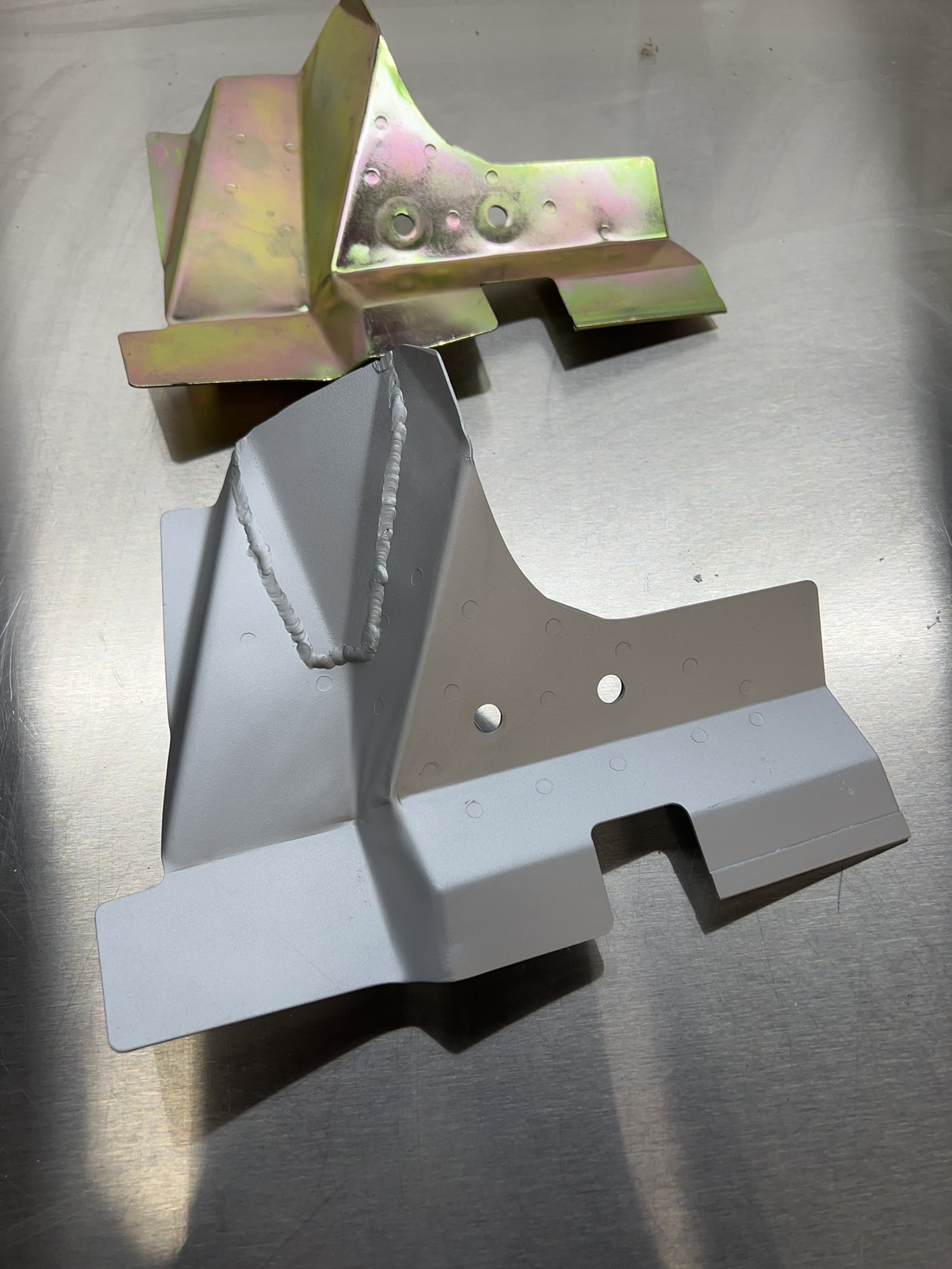

Looking great. They are indeed a very tight fit. See the thread linked below and pic for a way to buy some much-needed room.....
https://www.carpokes.com/viewtopic.php?t=157
shield mode.jpeg (553.26 KiB) Viewed 475 times

Already hammered and formed the shield to help clear. Next up now that it's tacked is to re-install the booster shield and make sure we're still good.
