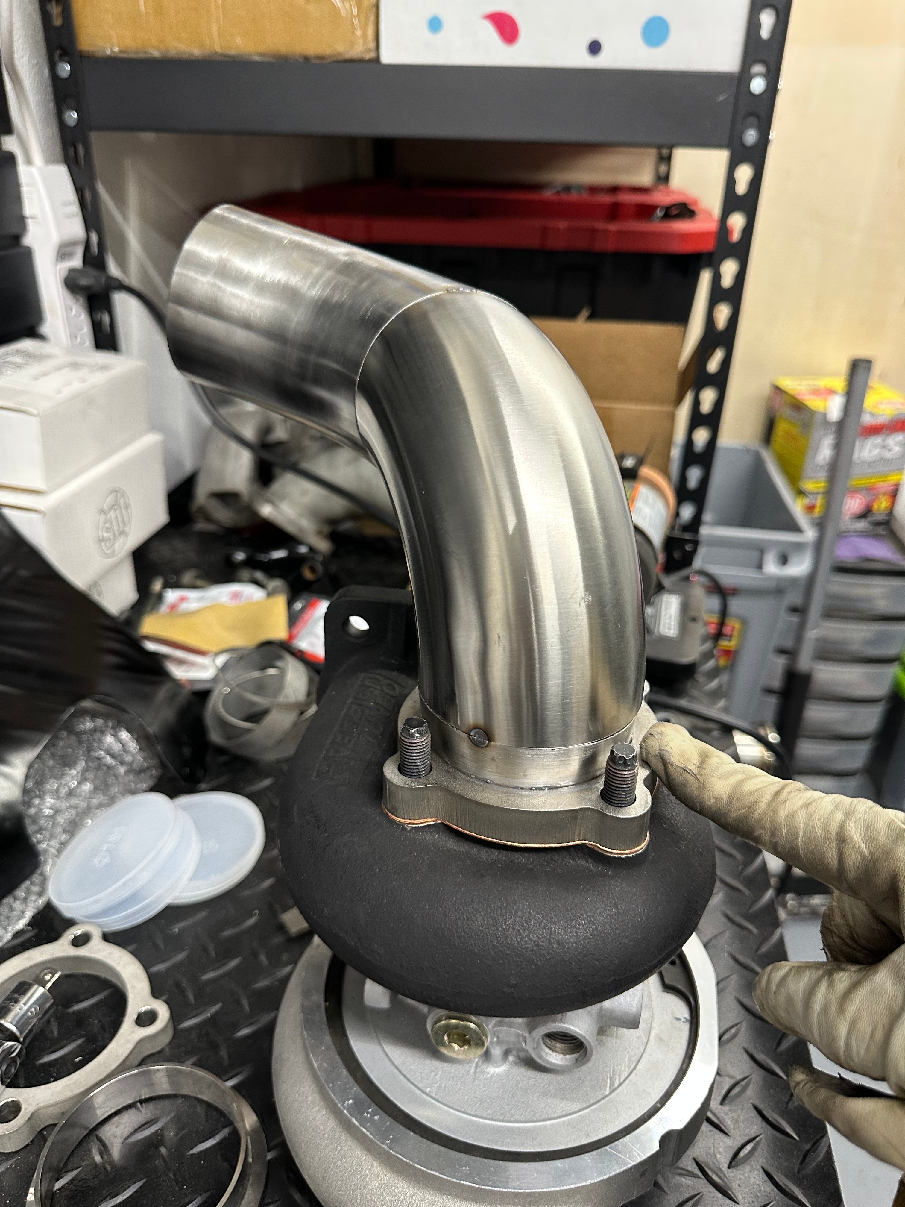

Fitting it is a real PITA

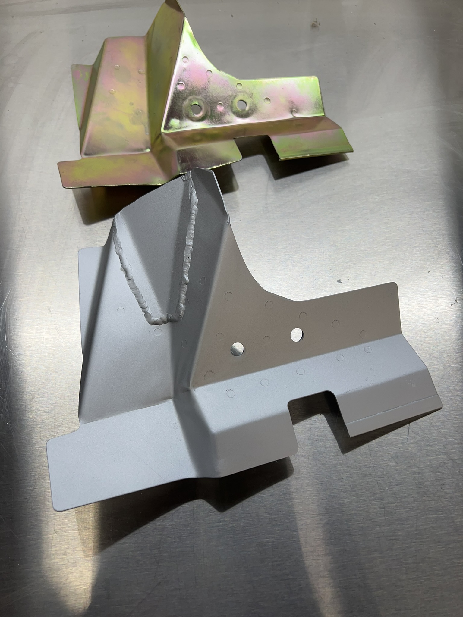

Looking great. They are indeed a very tight fit. See the thread linked below and pic for a way to buy some much-needed room.....
https://www.carpokes.com/viewtopic.php?t=157
shield mode.jpeg (553.26 KiB) Viewed 474 times

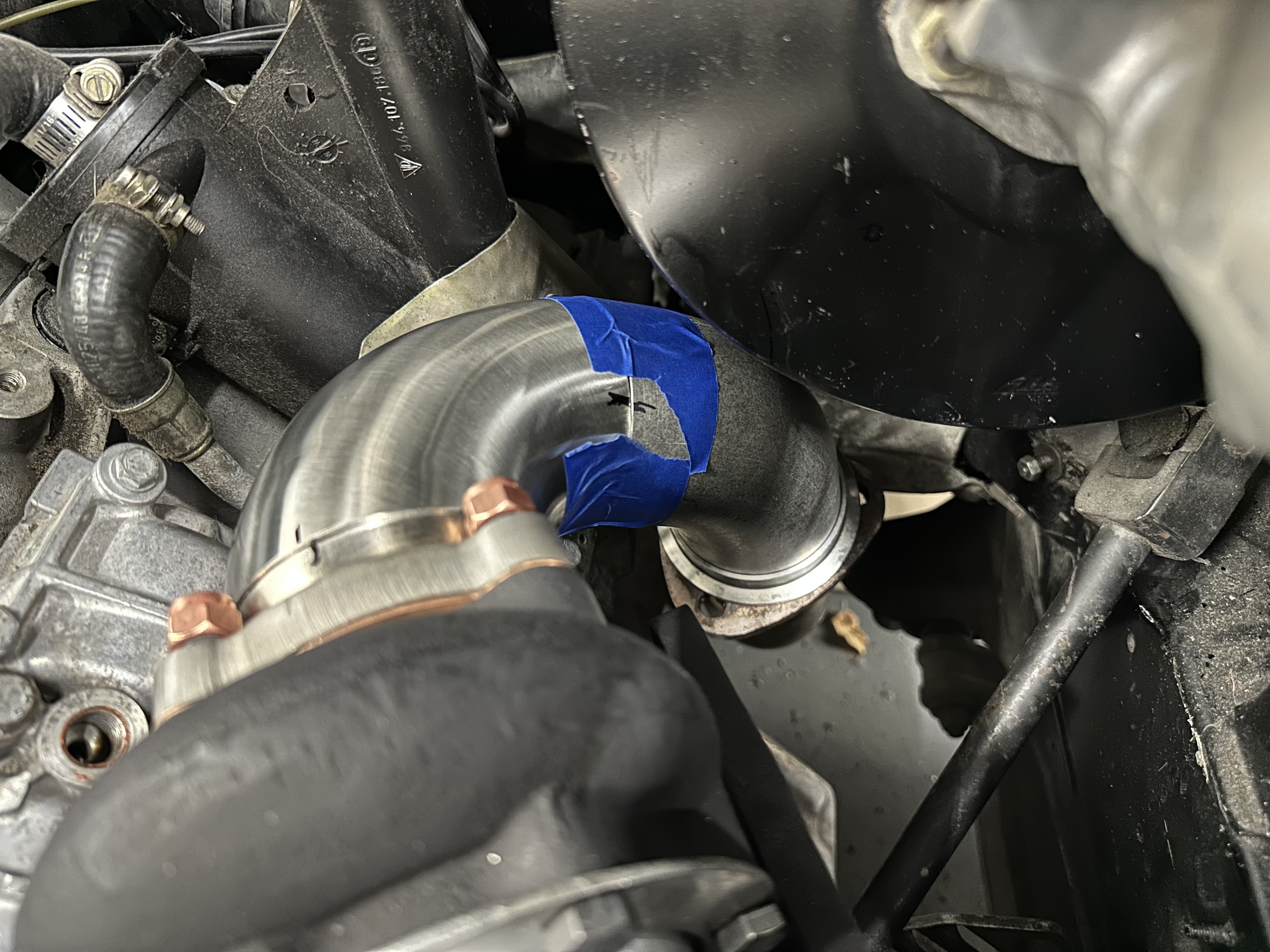

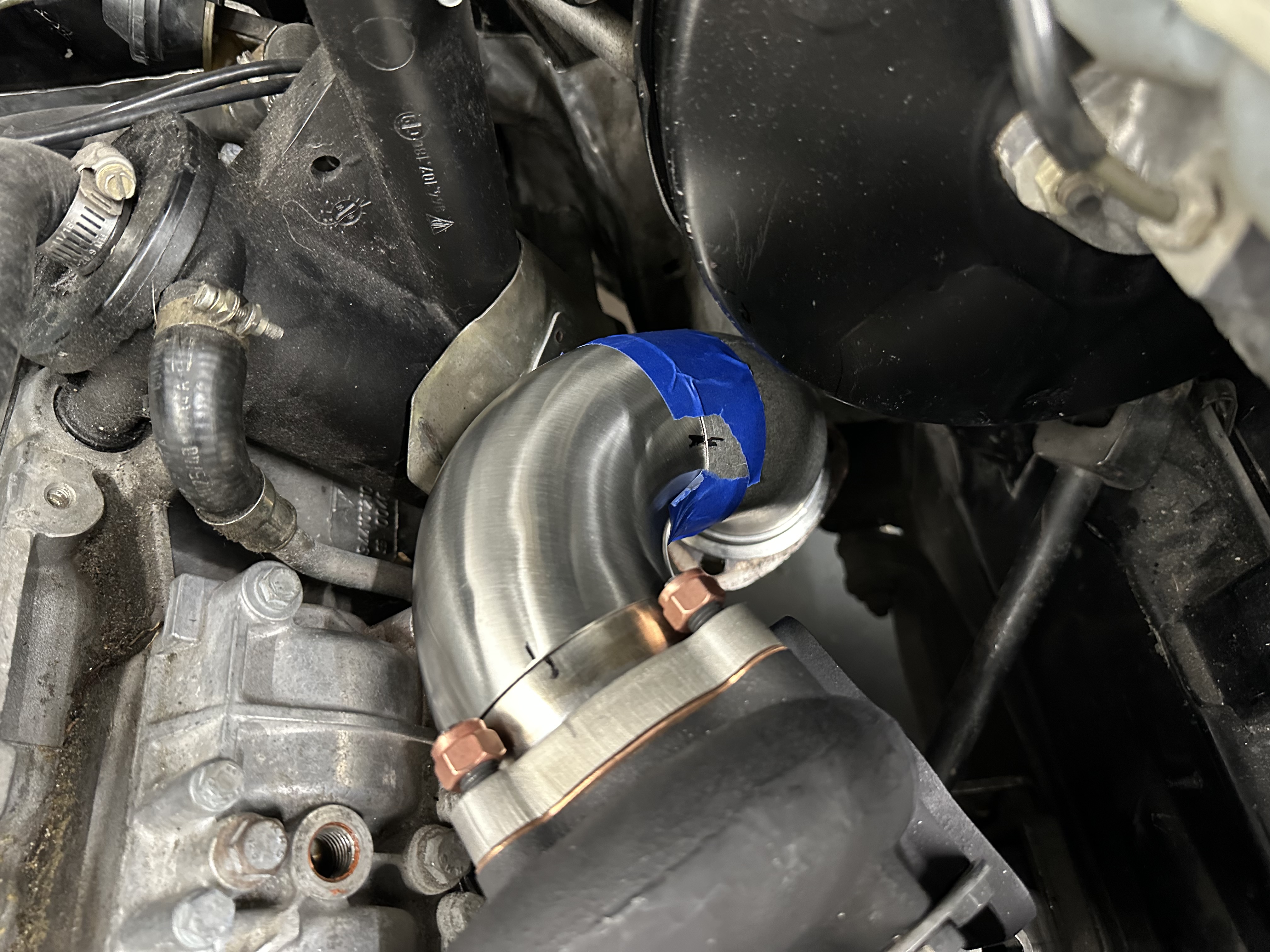

Already hammered and formed the shield to help clear. Next up now that it's tacked is to re-install the booster shield and make sure we're still good.

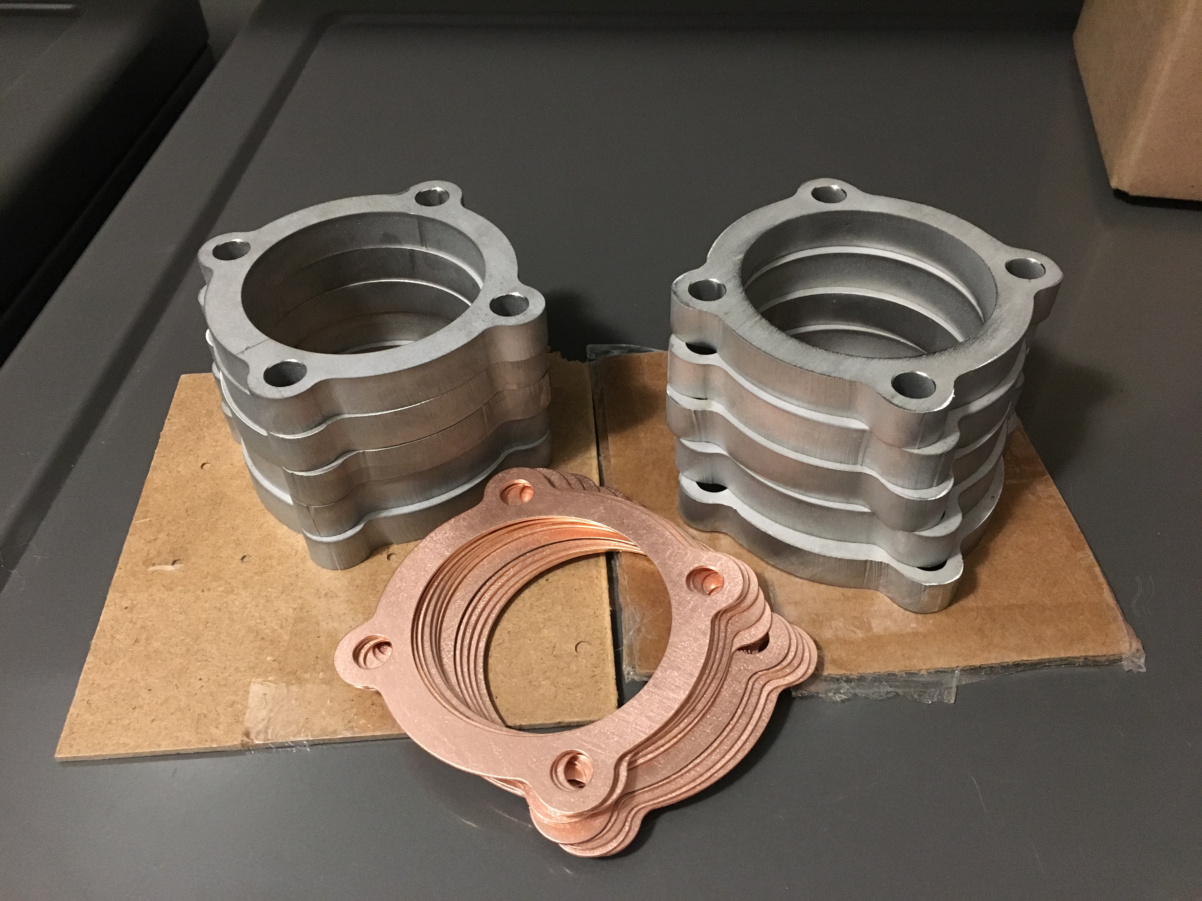

Where did you source the flanges - or did you cut them out yourself?
I guess send-cut-send'll do 0.5" mild steel :)

I CAD designed and had them water jet cut in stainless along with copper gaskets. Most of the flanges I found were 2.5 opening. I needed larger for my voodoo turbo outlet
