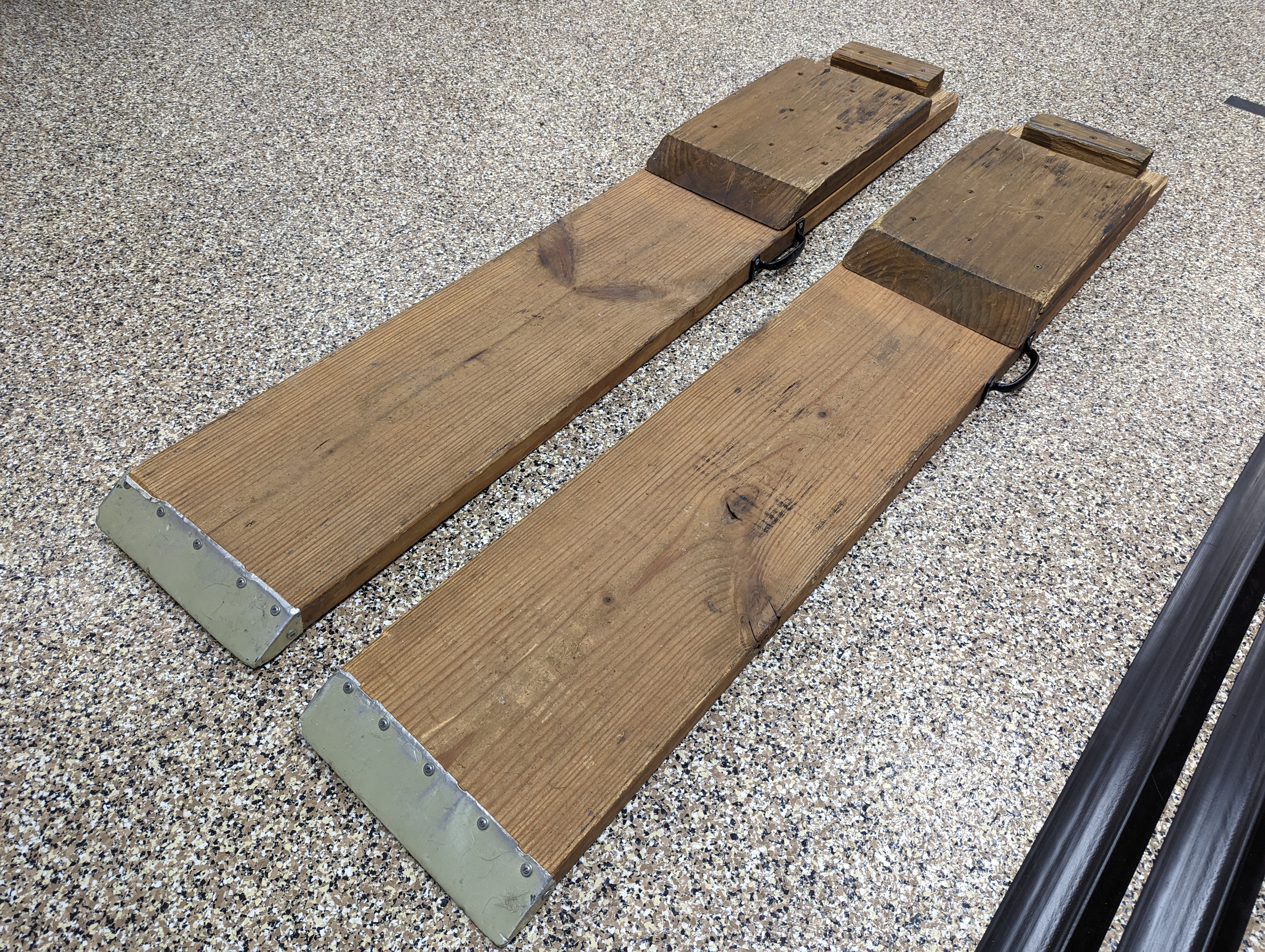

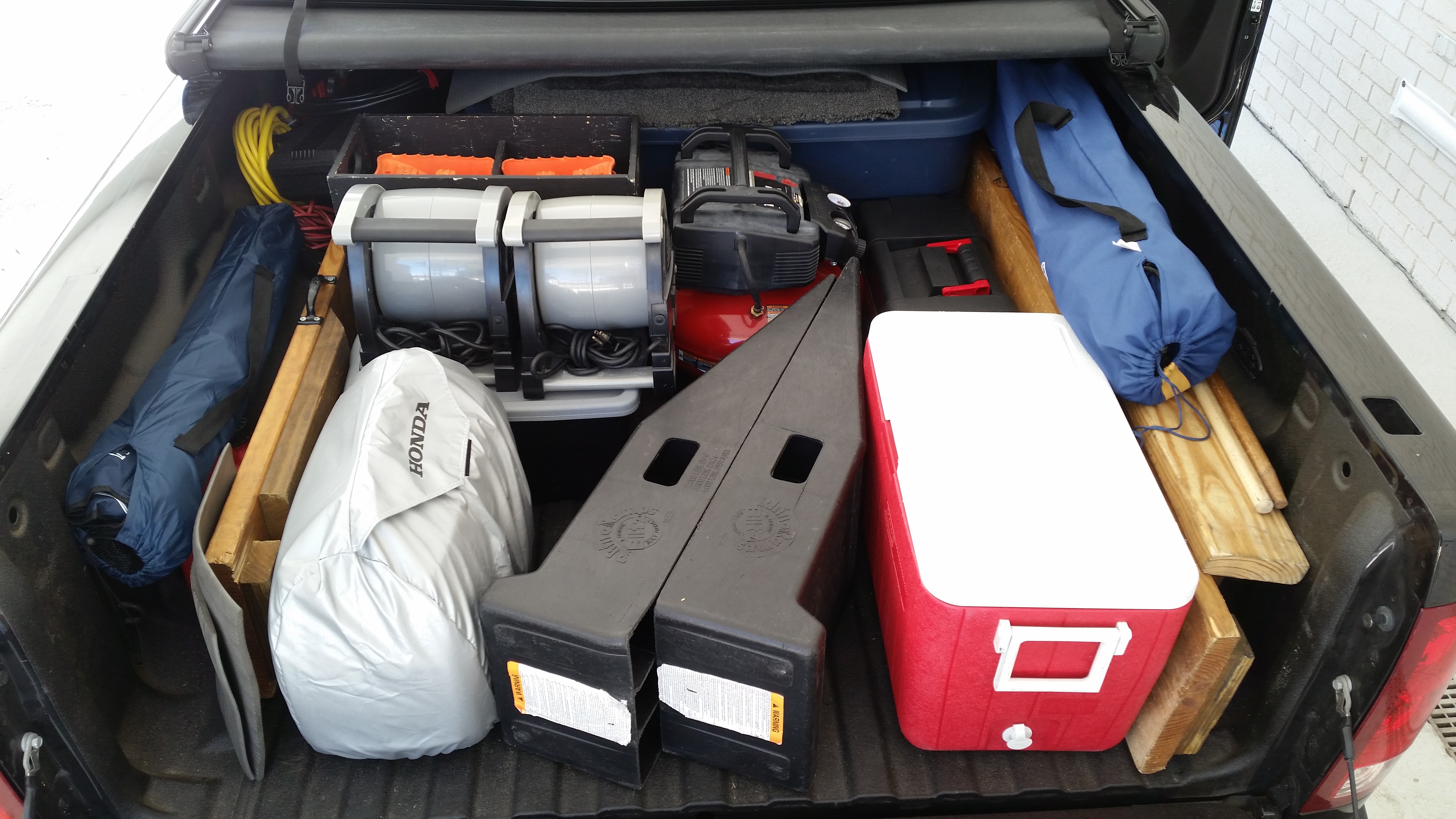

However, my previous car was a track-only, non-streetable C6 Z06 that was just as low in the front as the GT4 and what I did for trailering worked well. Rather than specialty trailers with their gizmos that might have caused headaches, I just backed my truck's rear wheels onto a set of Rhino Ramps which lowered the trailer's slanted rear and I then used the trailer's regular aluminum ramps, extending them further with the two 5'4" long double-stepped 2x12s that I put together. I even have slots to keep them mated to the aluminum ramps, especially useful when loading the car on the trailer. Carrying handles too. (2x12's are heavy.)
It works well. Also, having the Rhino ramps can be a plus if you ever have a trailer tire flat. (That assumes a dual-axle trailer of course.)
Simple and failure proof. Lots of use and wear on my old wood ramps.

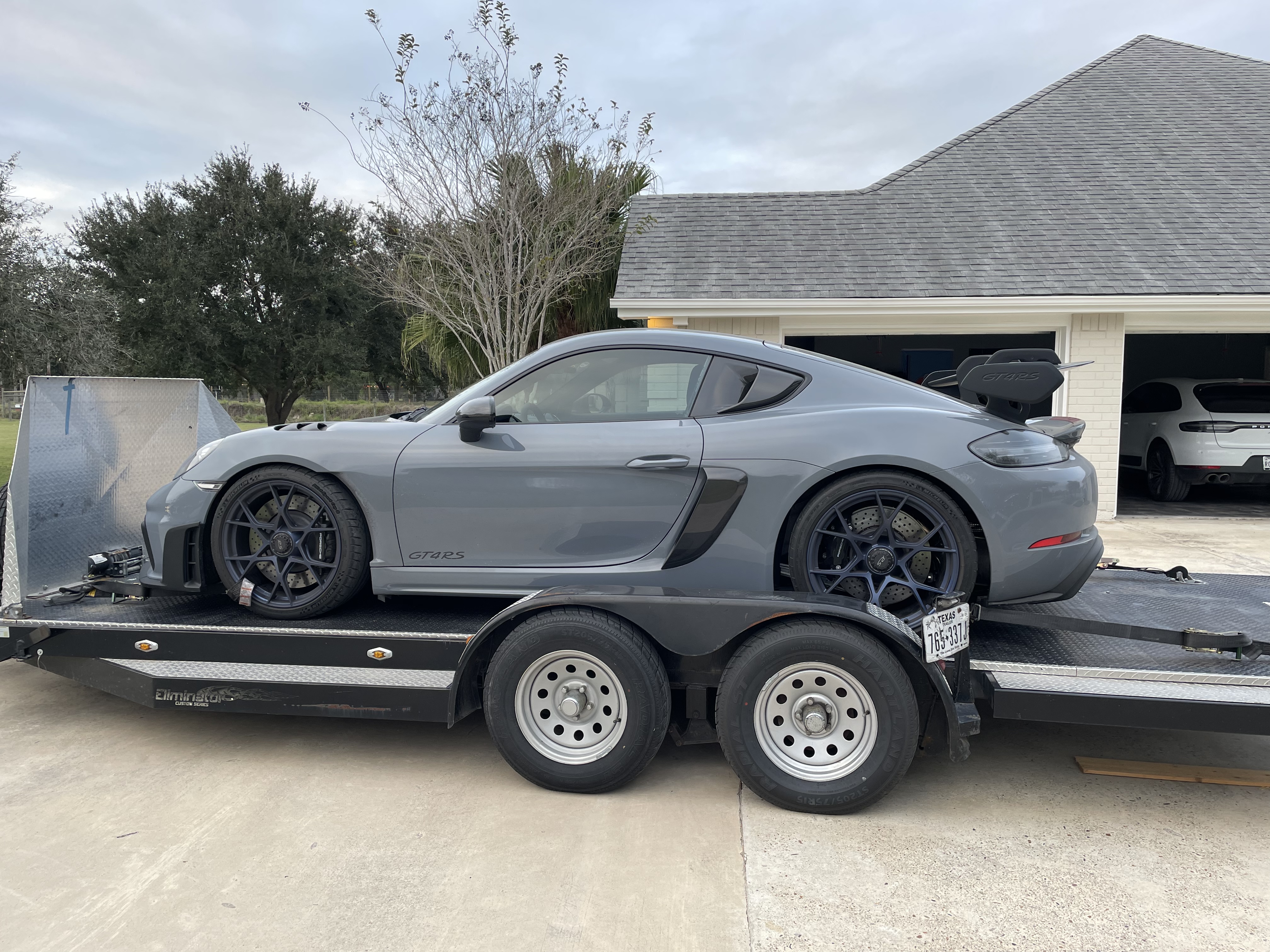

Gt4rs in an eliminator tilt deck trailer. Used 3 foot race ramps to get it in. Easy Peasy

Nice 4RS !!!Mojonito wrote: Fri Jan 20, 2023 6:37 pm Gt4rs in an eliminator tilt deck trailer. Used 3 foot race ramps to get it in. Easy Peasy

Wow, nice RS. I will research the Eliminator Tilt Deck, hadn’t come across that trailer.Mojonito wrote: Fri Jan 20, 2023 6:37 pm Gt4rs in an eliminator tilt deck trailer. Used 3 foot race ramps to get it in. Easy Peasy

Holy cow. Nice car. That car deserves its own thread here with a zillion pictures.Mojonito wrote: Fri Jan 20, 2023 6:37 pm Gt4rs in an eliminator tilt deck trailer. Used 3 foot race ramps to get it in. Easy Peasy

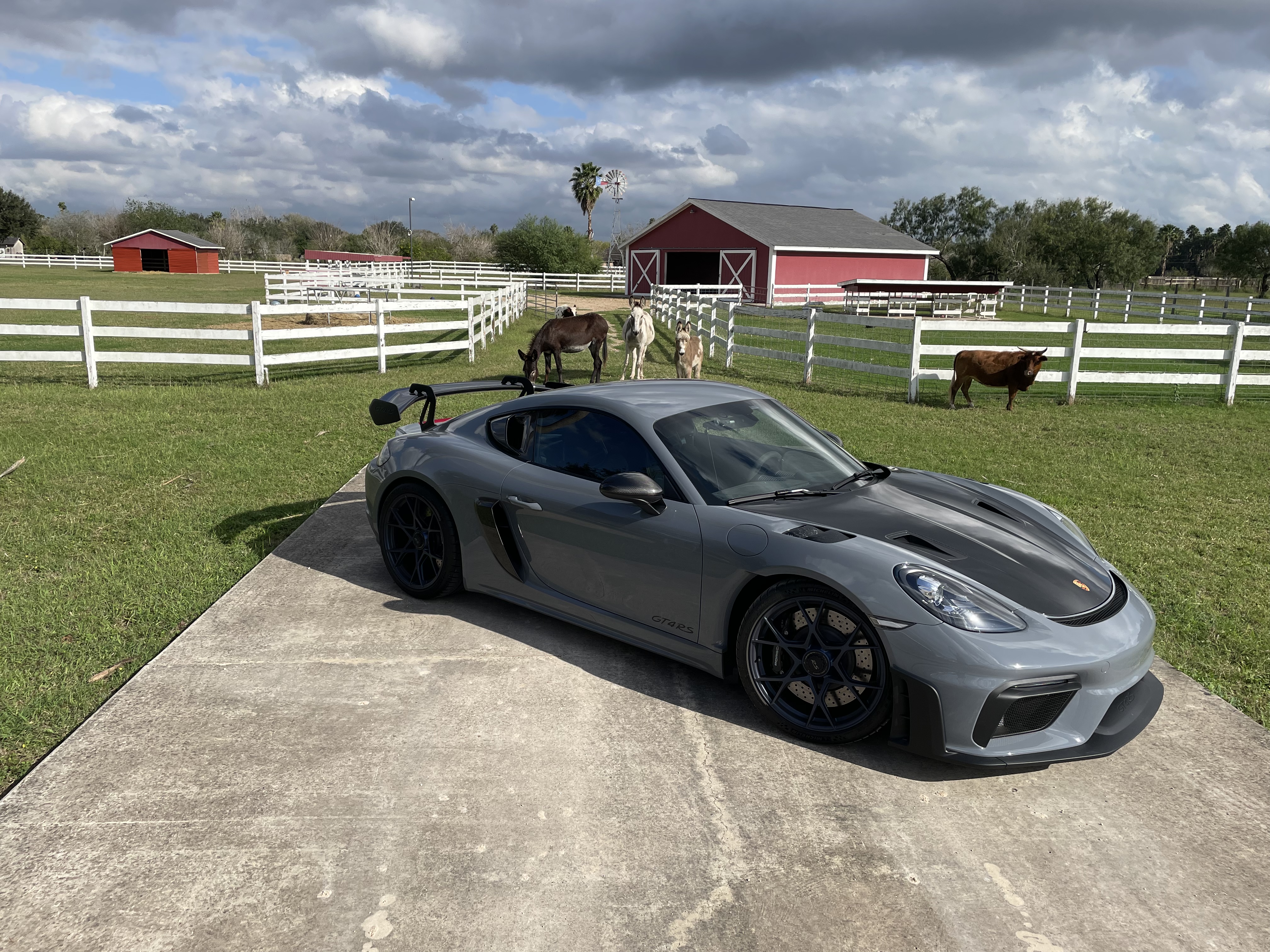

I’ll put something together when I have a few minutes to take some pics. Until then, check out the nice ass

Meanwhile, back to the trailer. I like the tilt feature on your Eliminator trailer - loading looks easy enough based on a quick web lookup of their product.

There’s a winch on there if you’re faint of heart but I just drive it up. Couldn’t be easier. Trailer isn’t super light though, i thinks it’s 2600 lbs
