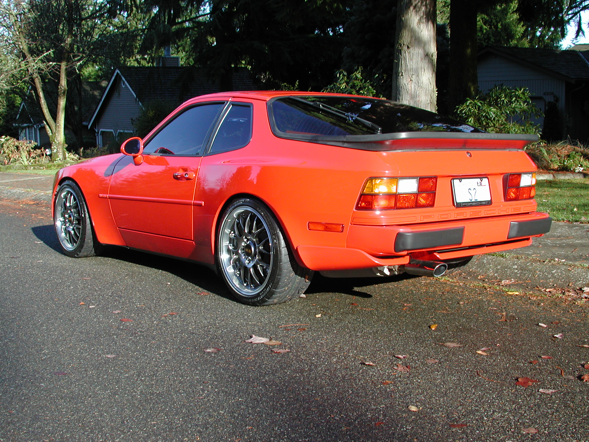

For reference, my 944 S2 has BBS RS-GT in 8x18, ET50 and 10x18, ET65 and my 951 has forged Fuchs in 8x18, ET52 and 10x18, ET65. Here's the S2.
- DSCN7474.JPG (1.1 MiB) Viewed 2757 times

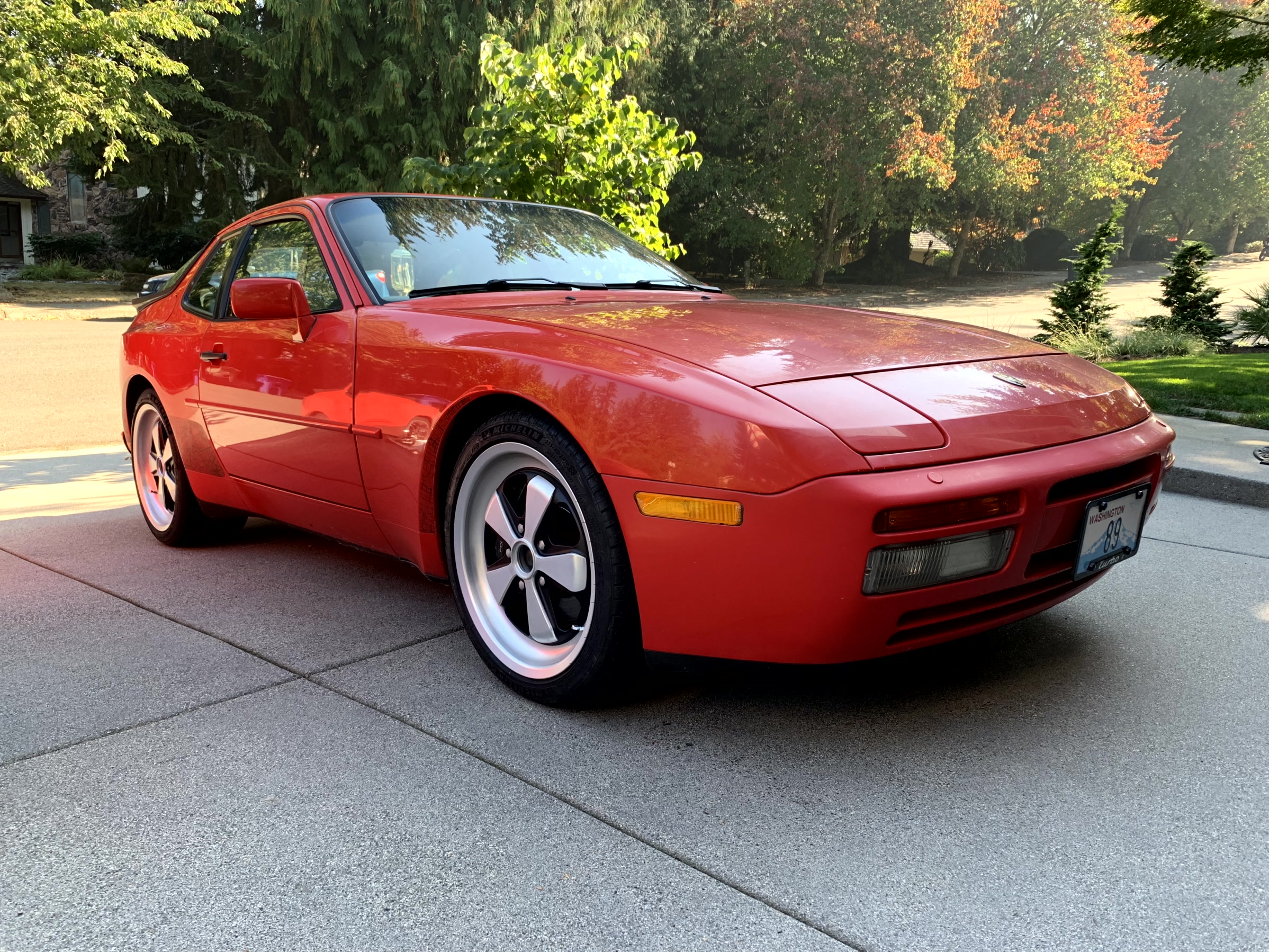

you don't happen to have the pictures of the Fuchs wheels do you? I've seen some of the Porsche classic wheels on sale and think I would really like the look.

Here's a picture I have of the 18" Fuchs on the 951. I believe the Porsche Classic wheels only come with black spokes.Sethers6945 wrote: Wed Nov 29, 2023 10:12 am you don't happen to have the pictures of the Fuchs wheels do you? I've seen some of the Porsche classic wheels on sale and think I would really like the look.
- 20221013_200712735_iOS.jpg (1.34 MiB) Viewed 2425 times

that looks fantastic! what size tires did you go with? did you use any spacers?

No spacers. Tires are standard for these rims: 265/35-18 and 225/40-18 Michelin Pilot Sport 4S XL.Sethers6945 wrote: Wed Nov 29, 2023 5:47 pm that looks fantastic! what size tires did you go with? did you use any spacers?
