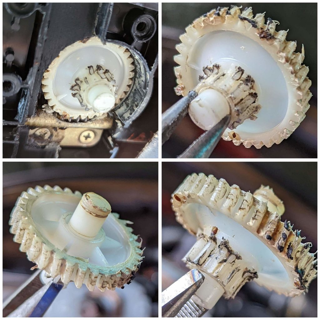

Nylon Gears
Nylon Gears
Nylon Gears

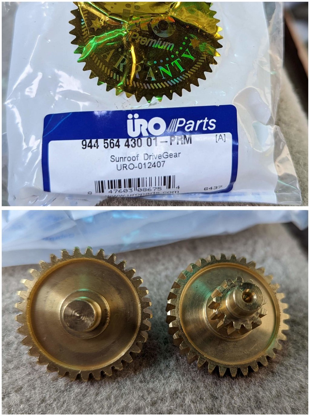

Replacement Brass Gears
Brass Gears
Brass Gears

Need to change the sun roof gears, where can i source the metal ones?
Re: What's Inside: Sunroof Lift Mechanism
Posted: Mon Jan 23, 2023 5:47 pm
by usury
4mangoes wrote: Mon Jan 23, 2023 9:29 am Need to change the sun roof gears, where can i source the metal ones?
I got them from Pelican. The part number appears on the bag in the photo.
The brass gears are machined very well and are a direct drop-in replacement.
