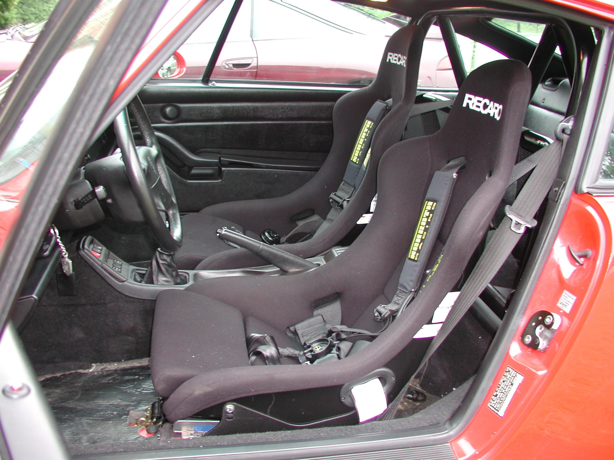

For seats in my 993, I was swapped them out for some Recaro pole positions, you can swap the cushions or add padding. The pole positions are basically the same seats that the 993 RS has. It is a fixed back racing shell, so no adjustments other than forward/back.

Yes, I installed the seats myself, used bkauto.com brackets along with some Recaro sliders.
Another option on seats is the 996 GT3 buckets, they are like the pole position but the side wings are not as tall. Those seats bolt right.
Here's a pic of the seats installed. Sold the car 10 years ago :(
(yes, I do regret selling.)
