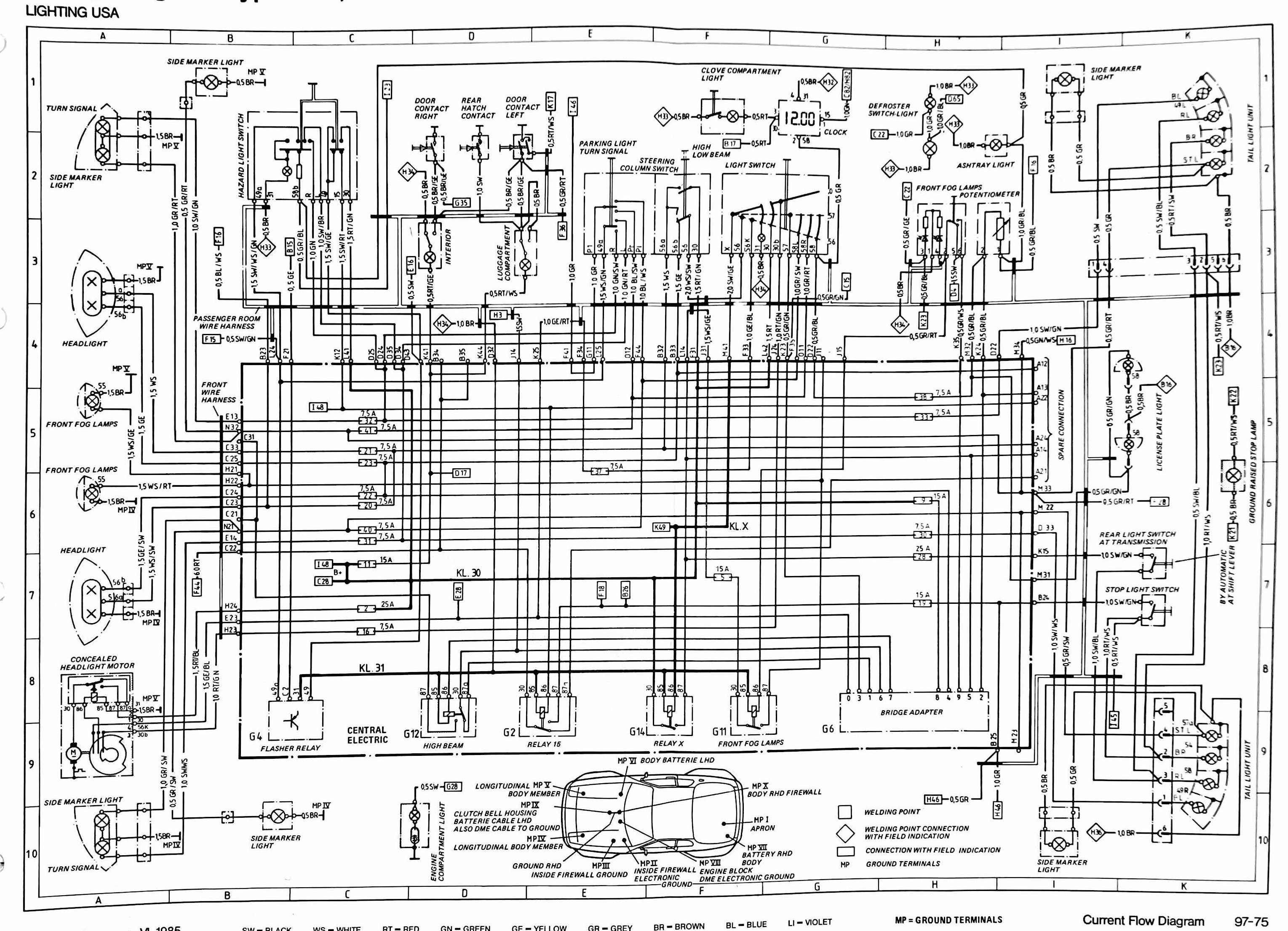

Not sure how much this will help, but here is that page.... After poking around a bit, I'd definitely check Relay G14 (aka Relay X). It would explain no power to the things that are not working I believe, but not the burned wire. What size is the green/red wire? I see a .5mm (small) wire in that color going to A10 of the climate control module, but suspect the one that burned on your car is bigger?aerolithe wrote: Thu Oct 13, 2022 2:32 pm Good day

I don't know if it's okay to post copies of the FSM here, but my copy sems to have all the electrical schematic pages for your 1986 model.
If yours doesn't, PM me and I'll help set you up.
Other non obvious things you'll find in the schematics:
"Central Electrics" is Porsche schematic speak for "fuse box".
ROW means "Rest of World" (whereas US-market models would otherwise be assumed).
Also, have you confirmed that "Relay X" is working properly, as Tom suggested? You'll find Relay X in the Central Electrics schematics.

Awesome! The power of Pokes! Worth digging to see what the burned wire does/did. Check fuse 28 for the reverse lights. There isn't much to that circuit after relay x -- just the fuse, reserve light switch, and the bulbs. If all those are ok, it must be the harness and/or connectors/sockets.aerolithe wrote: Sat Oct 15, 2022 4:54 am Good morning gentleman
