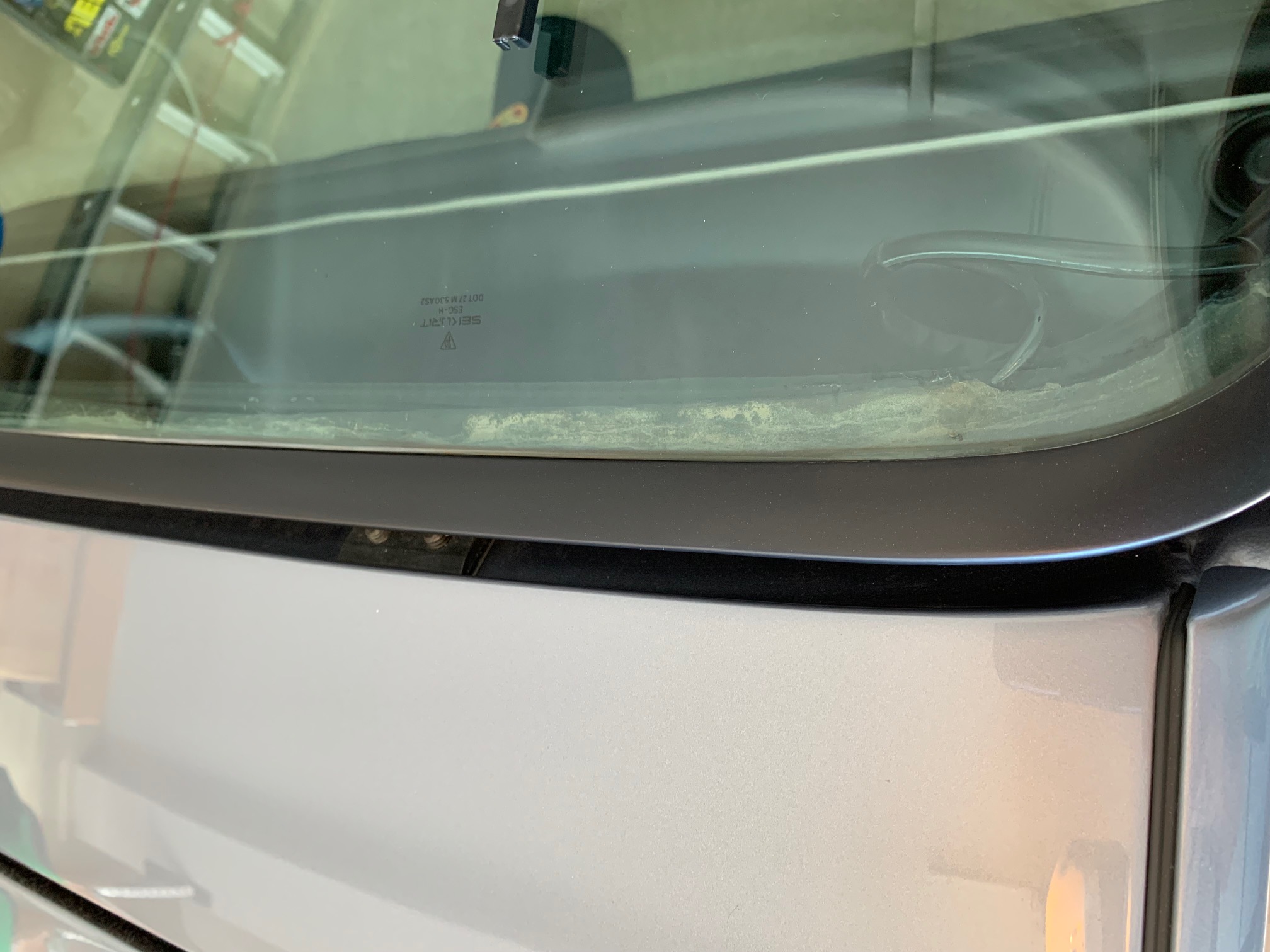

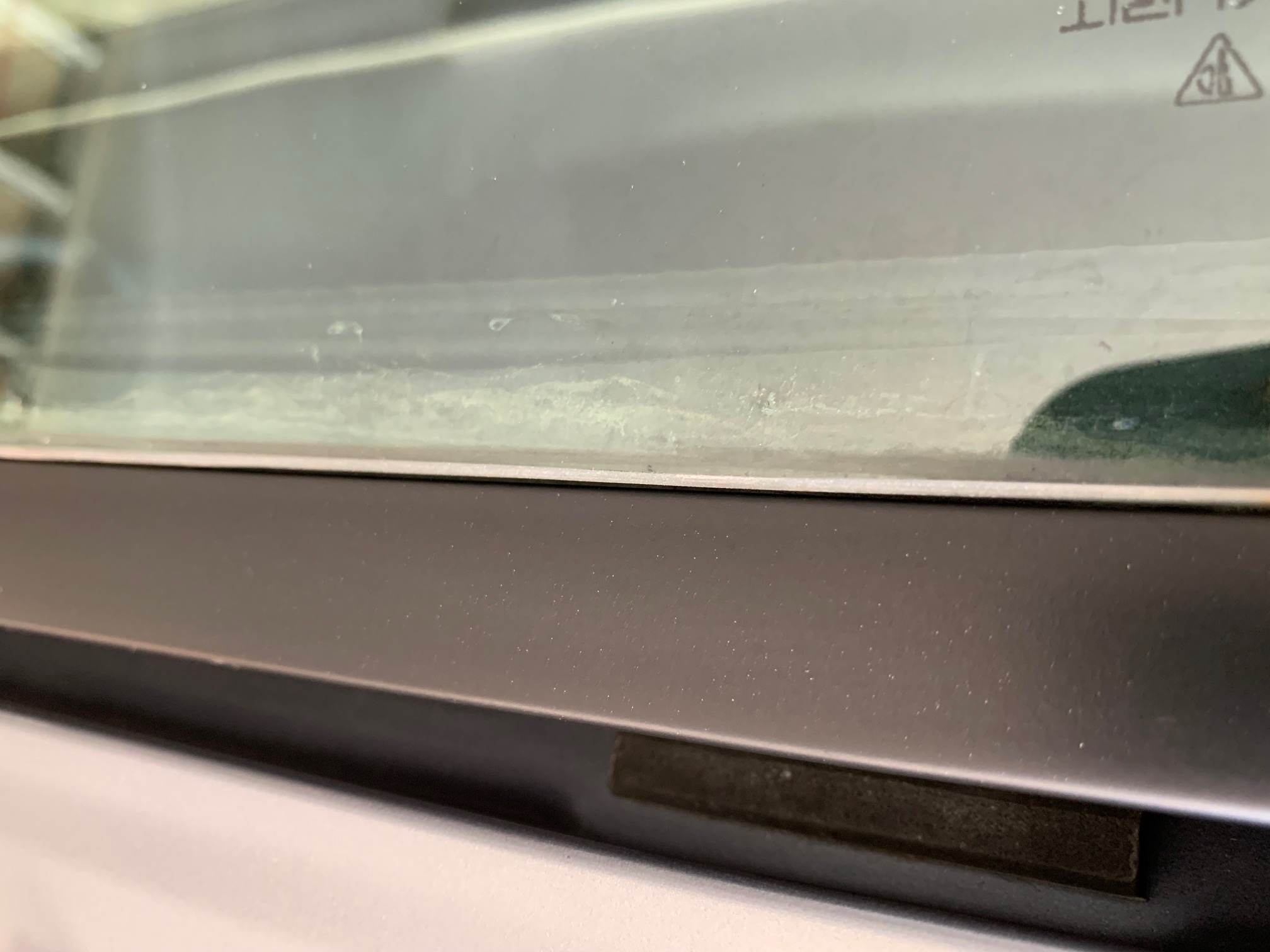

Was wondering if anyone here has resealed a rear hatch frame? The frame has come loose from the glass. Going to make this a winter project. ImageImage

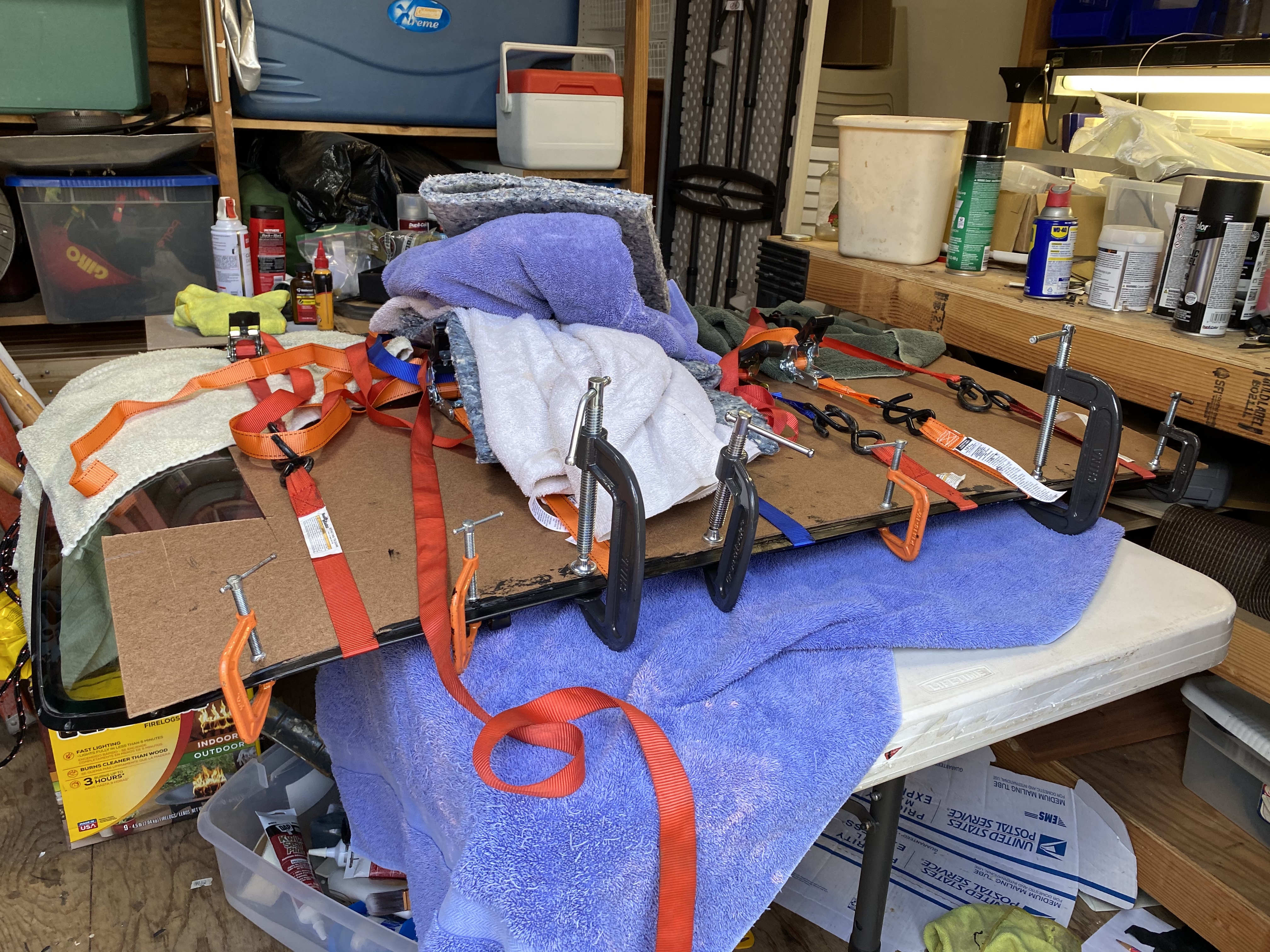

I did mine about 2 years ago - just resealed the top part of the frame. I used 3m window weld to seal it and then put a bunch of ratchet straps on it for 3 weeks. Still in good shape but I never close it with the lifts connected.

I took mine to an auto glass shop, and they did basically the same thing... They only let it sit overnight, but same idea.

Here’s a pic of mine in process
