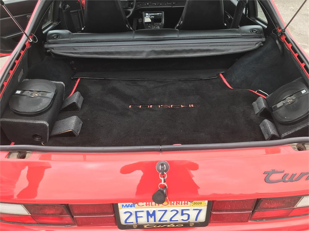

Here's a picture of my S2, with the broken end cap missing. I have new plastic ones from Porsche but might opt for the aftermarket aluminum variety. It's just one screw on each side.
