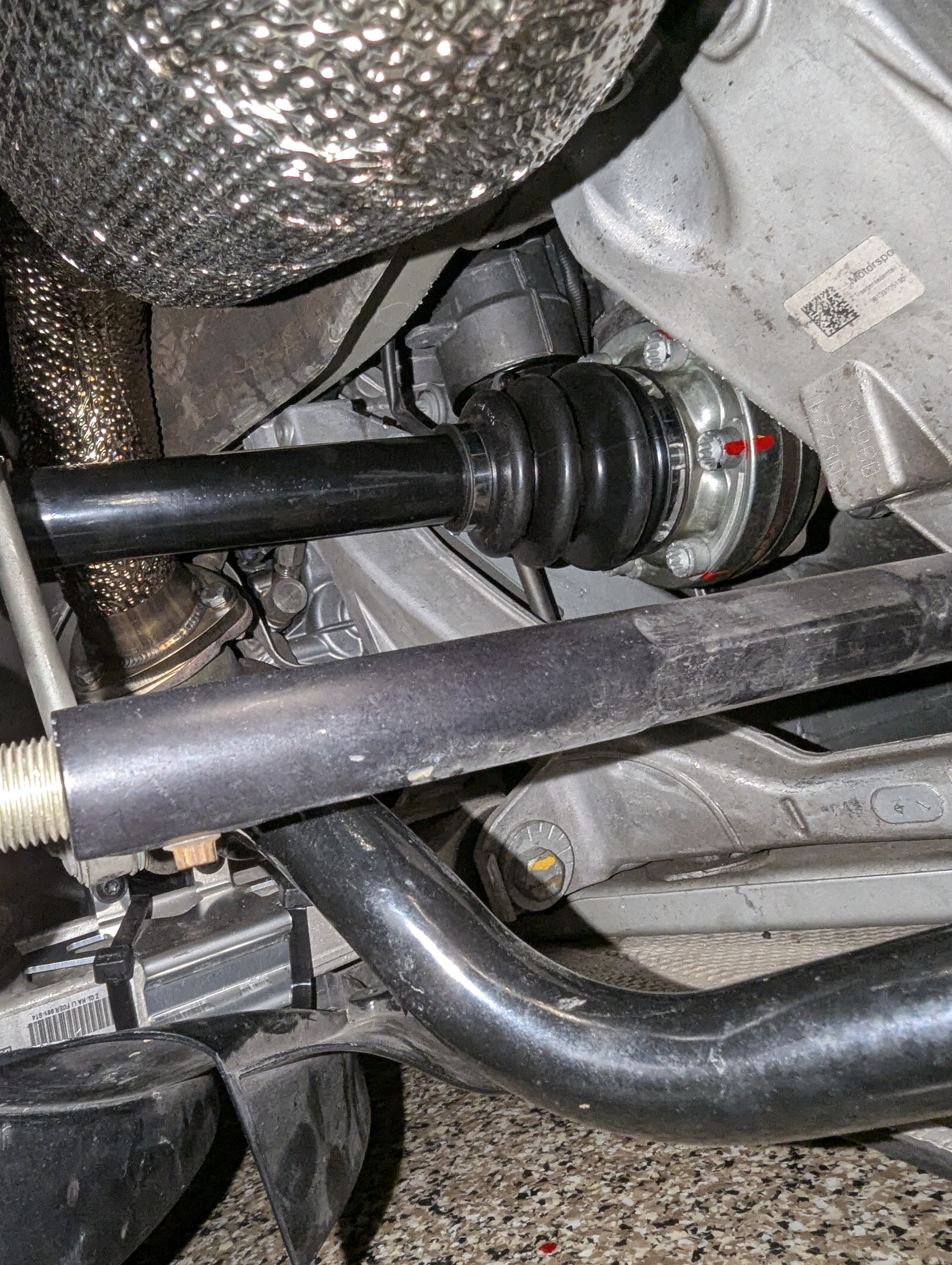

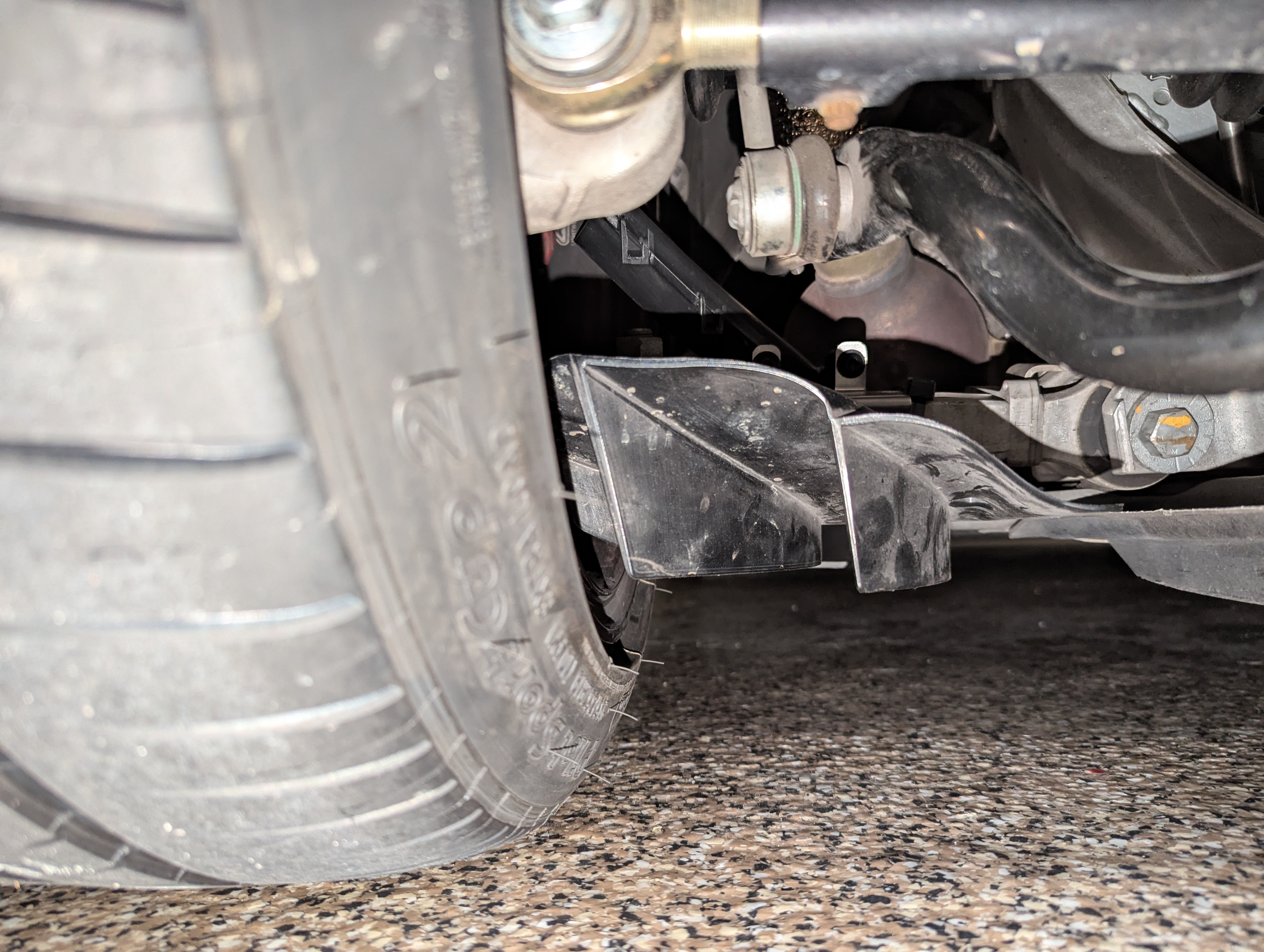

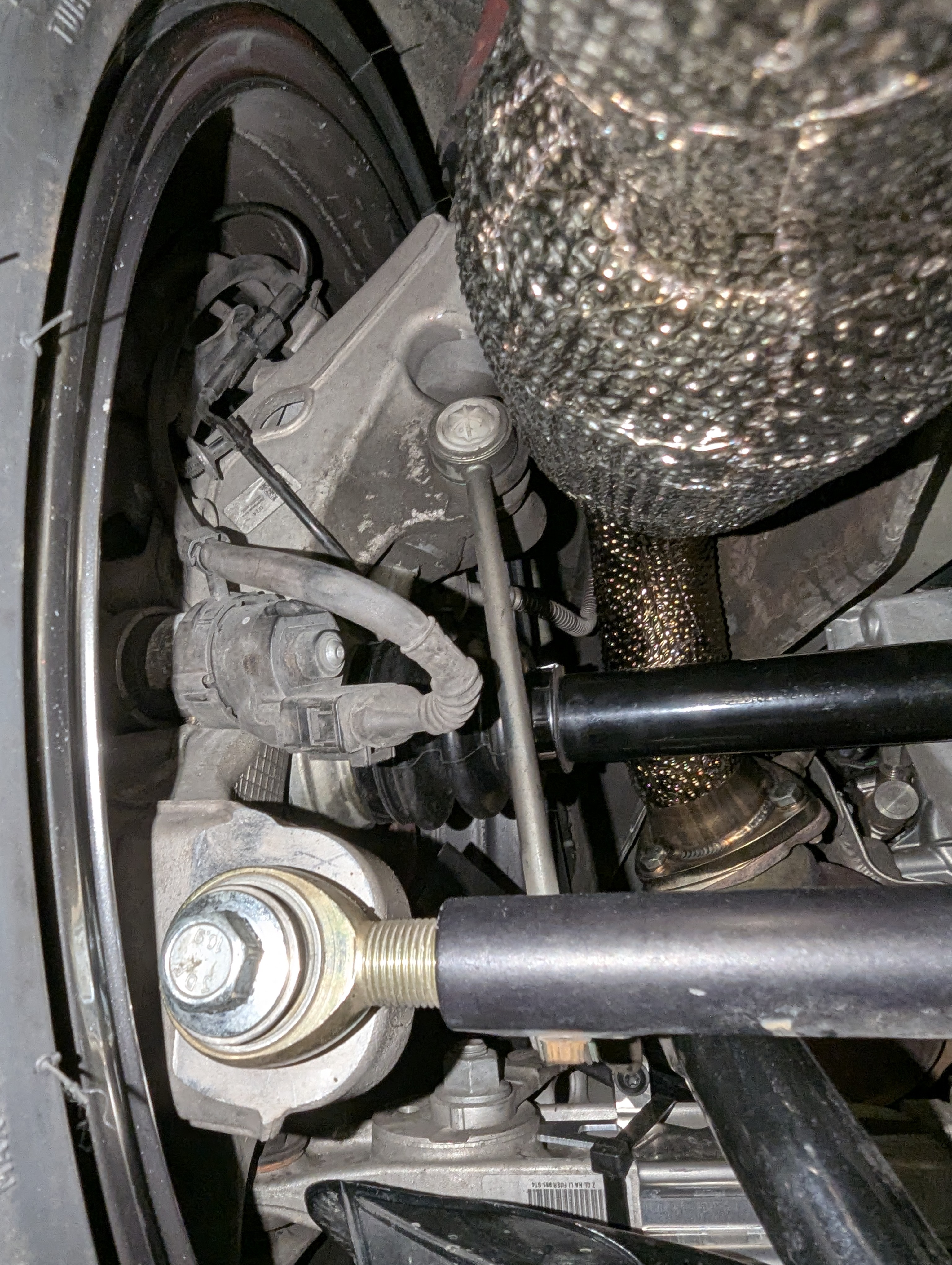

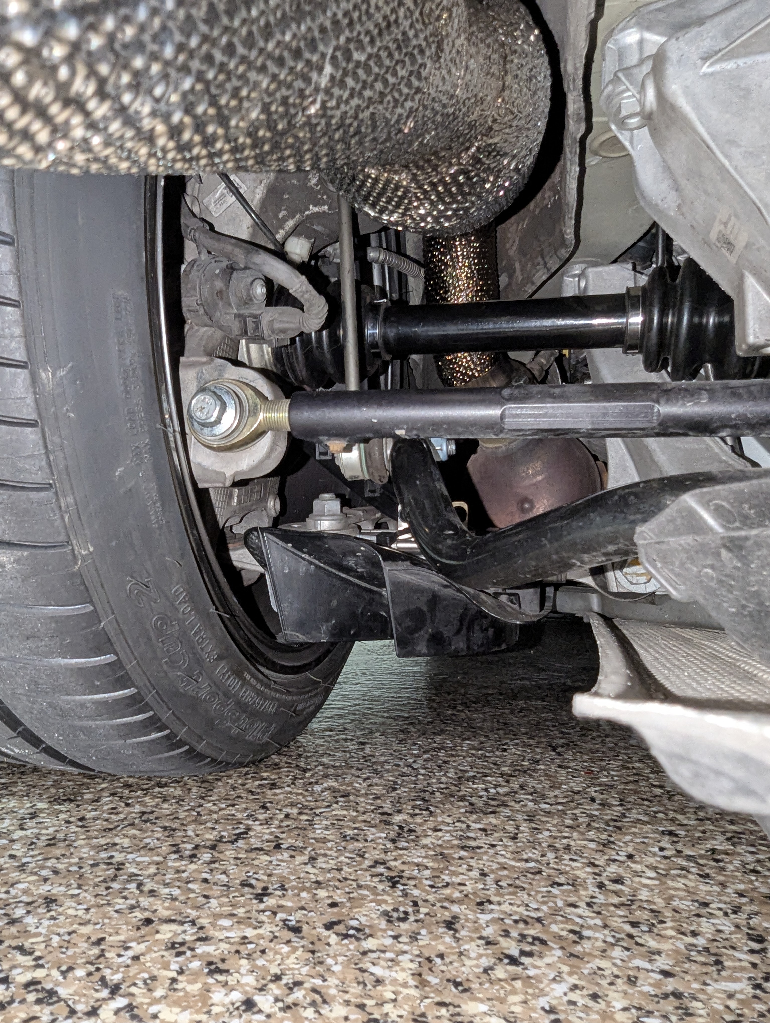

The GT4 is ready for the track again - the rear heat degradation issues have been addressed with parts replaced as described in earlier posts, so we'll see if they do the job. New inner and outer boots w/high temp grease, Porsche Motorsports rear axle air ducts and the new 3-D printed heat-shielded Soul OAPs.

Excellent result Tim!
I hope to follow your path with my OAPs.
Seeing the LCA air guides on with Zip Ties inspires me to trim mine so I can do the same. The stock clam shell does not seem super secure anyway.

:thumbup:
Agree on the clam shell not being very secure Jeremy. Josh at PoN (who did the work) said the same thing and added that he felt his configuration to be superior strength-wise.
