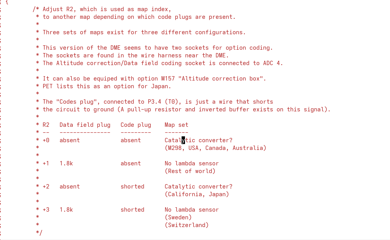

I found some interesting stuff about idle maps! The short version is:
* the maps are interpolated so the fact that they don't directly contain 840 doesn't mean much - it's half way between 2 of the values they do have
* there are 3 different maps that match this description in the DME. Rogue's XDF file only lists one. The 3 maps are all the same but they correspond to different regions/cat/o2 configurations.
The one used is controlled by something called a code plug... do you know about that and how yours is set?
If you just want to try editing the other maps, the locations of the other two in raw hex values are 18E8 and 1B00, while Rogue's XDF file has the only the other one (corresponding to the US setup) at 1665.
Note that that XDF file has an offset of 4096 (decimal) at the top which is 1000h so the address shown for the map is 0x655. So the corresponding values that I presume you need are 0x8E8 and 0xB00. You should be able to see that these contain the exact same rpm values as the one Rogue references.
So my guess is your car is selecting one of the other maps. Here's all the info I have on the code plug thing:
This is from an annotated version of the disassembled BIN that I got using stuff from a project called opendme. I don't know if it's still active but the code is on sourceforge and it has the .ctl files that if you disassemble the bin with D52, you get these useful comments and hints on what various functions do. It's far from a comprehensive reverse engineering but it's a good start. I used a hex editor to find other examples of the same map, studied the map read function and worked backwards....and then found this comment that explains almost everything lol!
I don't trust these comments 100% but they have definitely helped me so far.
