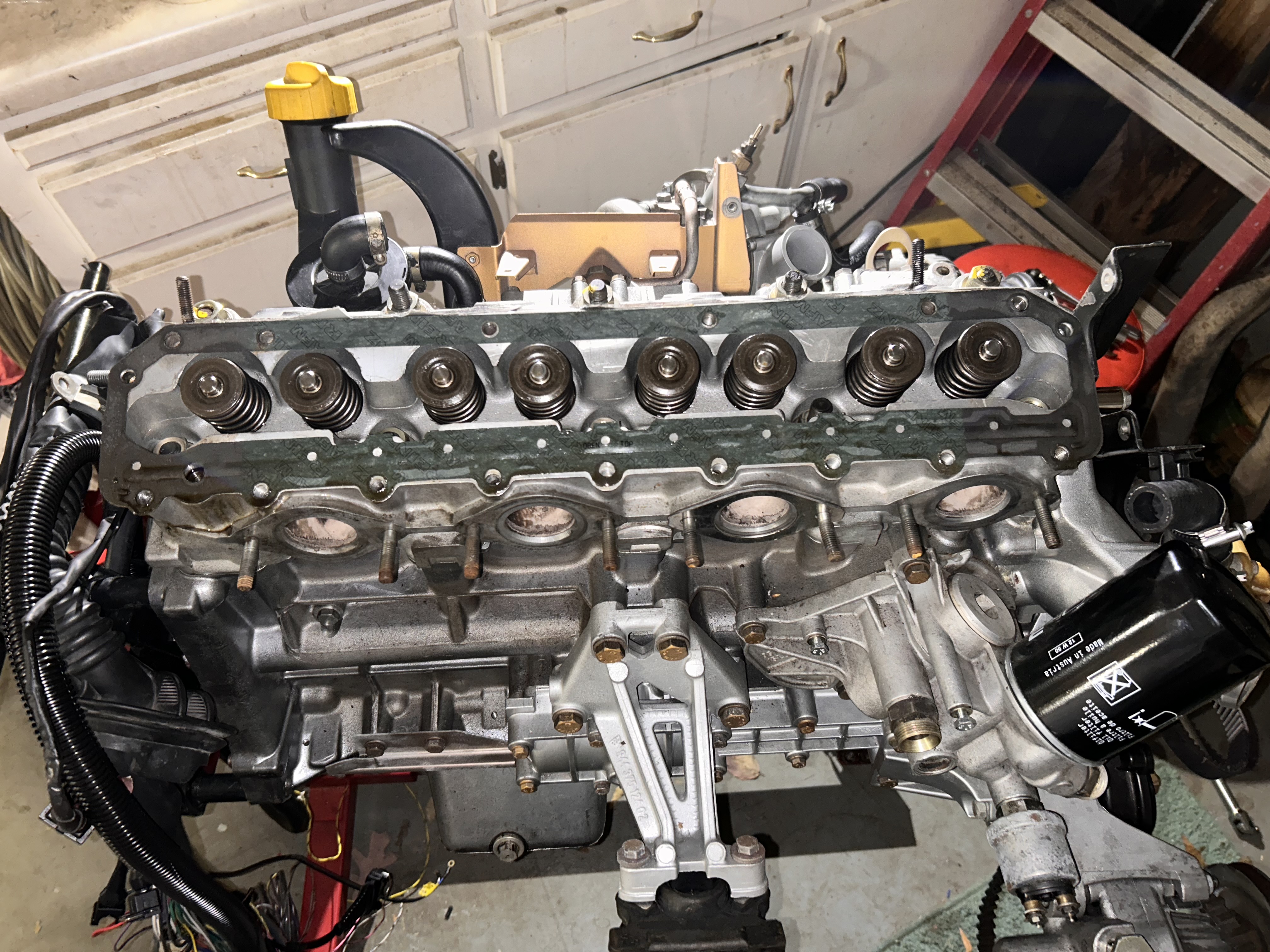

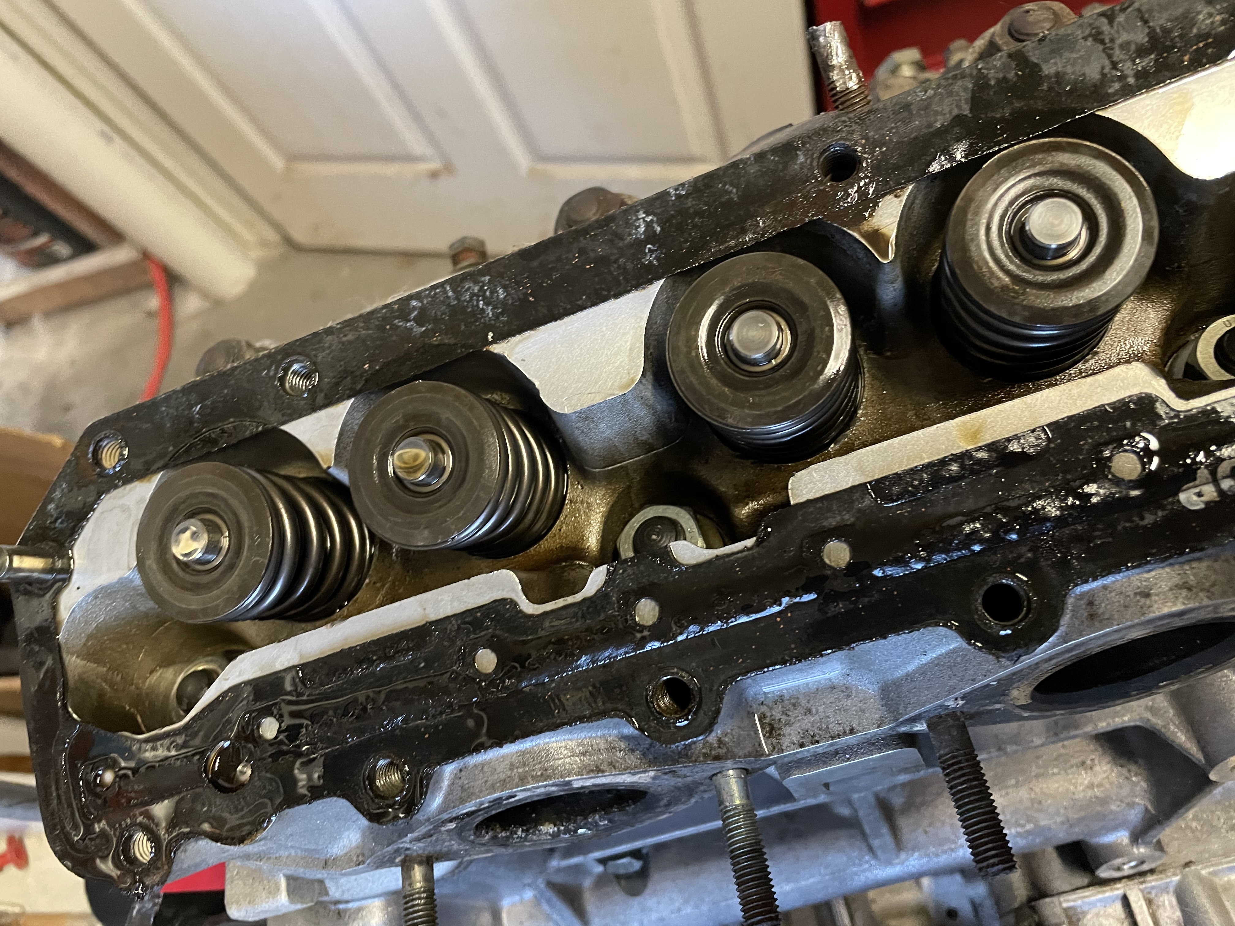

The lifters should not clatter like that if they were quiet a few hours before. Starting the engine from cold with the pressure valve in the head off should give a pressure of 3 bar only, so if the pressure goes to 5 then it seems the valves does restrict oil flow to the cam housing but perhaps stays open when turning off the engine.
What year is your car? If it's an '86 then rather than a sealed valve there may be a ball + spring set up, in which case there is no visible bolt visible on the side of the oil valley going up, on the head, from the block to the cam housing. Post a pic so we can see what you have. Not sure how the ball could stay up when turning off the engine but then I'm not familiar with the ball + spring set up on 8V heads.
'90 944 turbo
- Drscottsmith
- Posts: 230
- Joined: Thu Feb 16, 2023 5:43 pm
- Has thanked: 3 times
- Been thanked: 15 times
Here’s a pic from way back at disassembly…
Closest one I have
