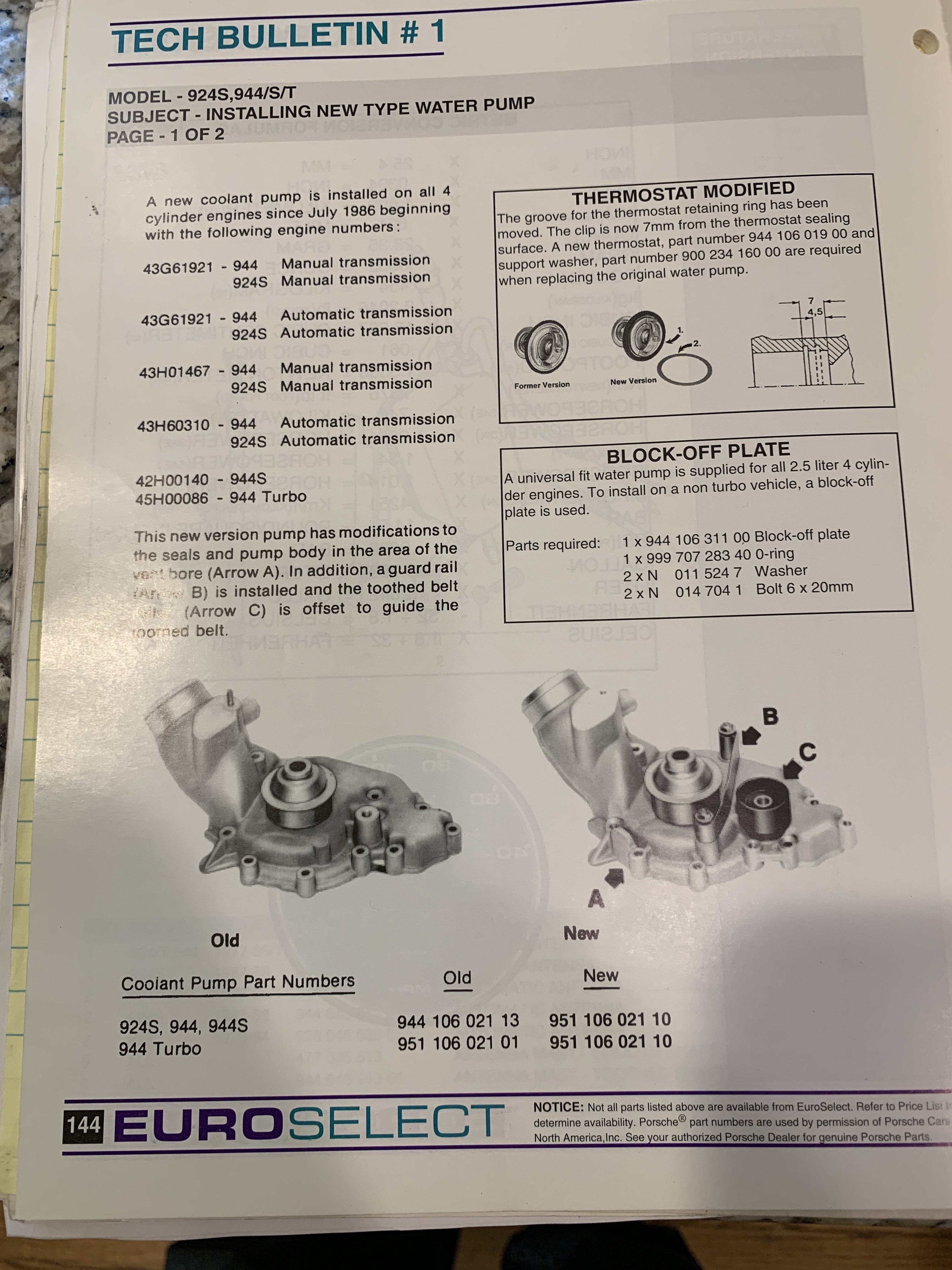

michaelmount123 wrote: Mon May 01, 2023 3:38 pm I had the TSB handy:

Wait...There's a second page that I'm having trouble uploading. Wait for it.

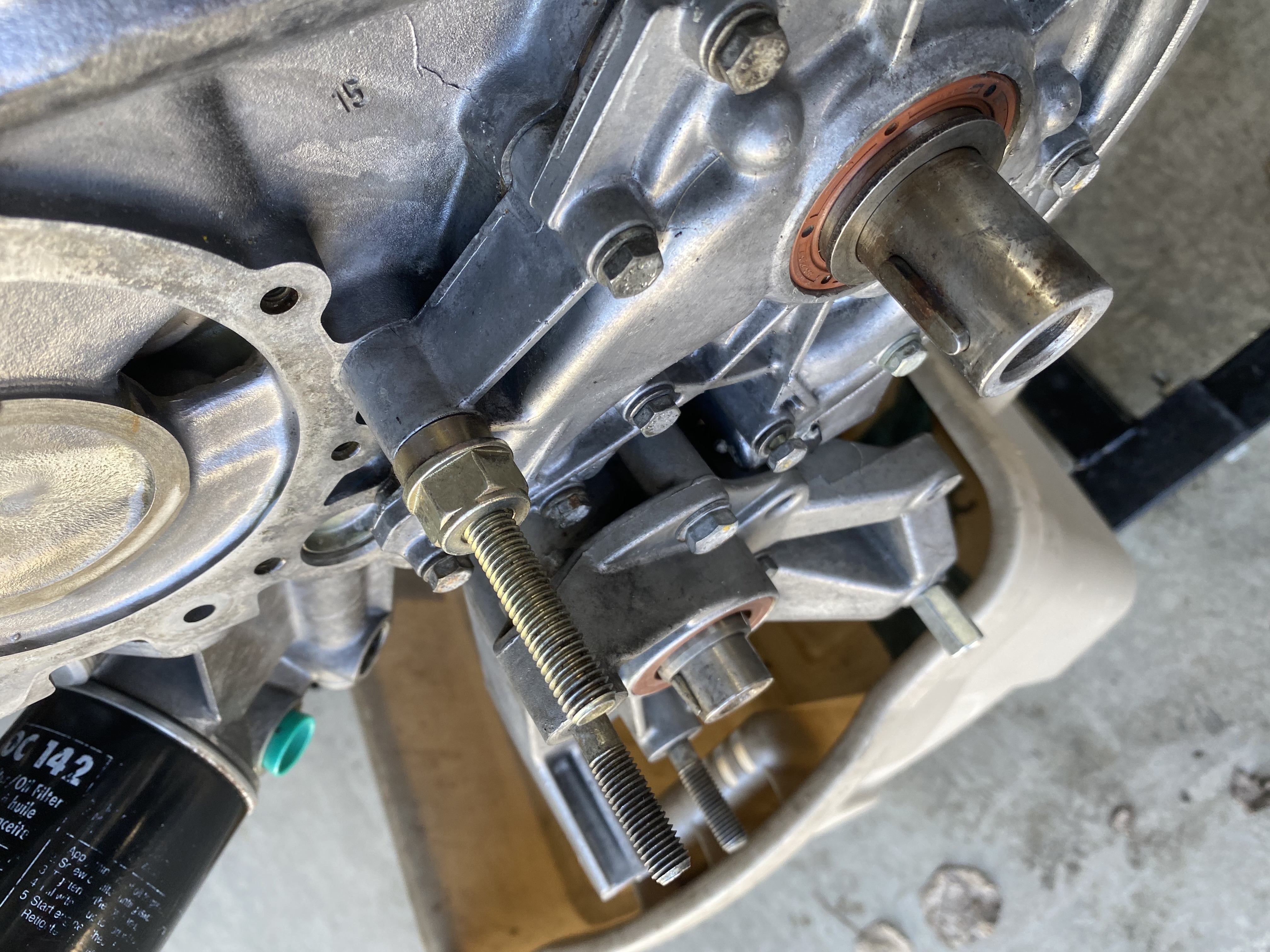

Thanks gents, I do have the water pump TSB (as part of the alldatadiy subscription). Does that relate to the bolt with flange-nut spacer thingie Gruhsy showed in the picture below? It's been too long to remember the specifics, but there was some unexplained mystery about the oil pump bolts and that particular fastener. Whatever I did, I guess it worked after 30k+ miles....
This one....

As you can see that bolt is attached to the oil pump.

All bearings are damaged.
