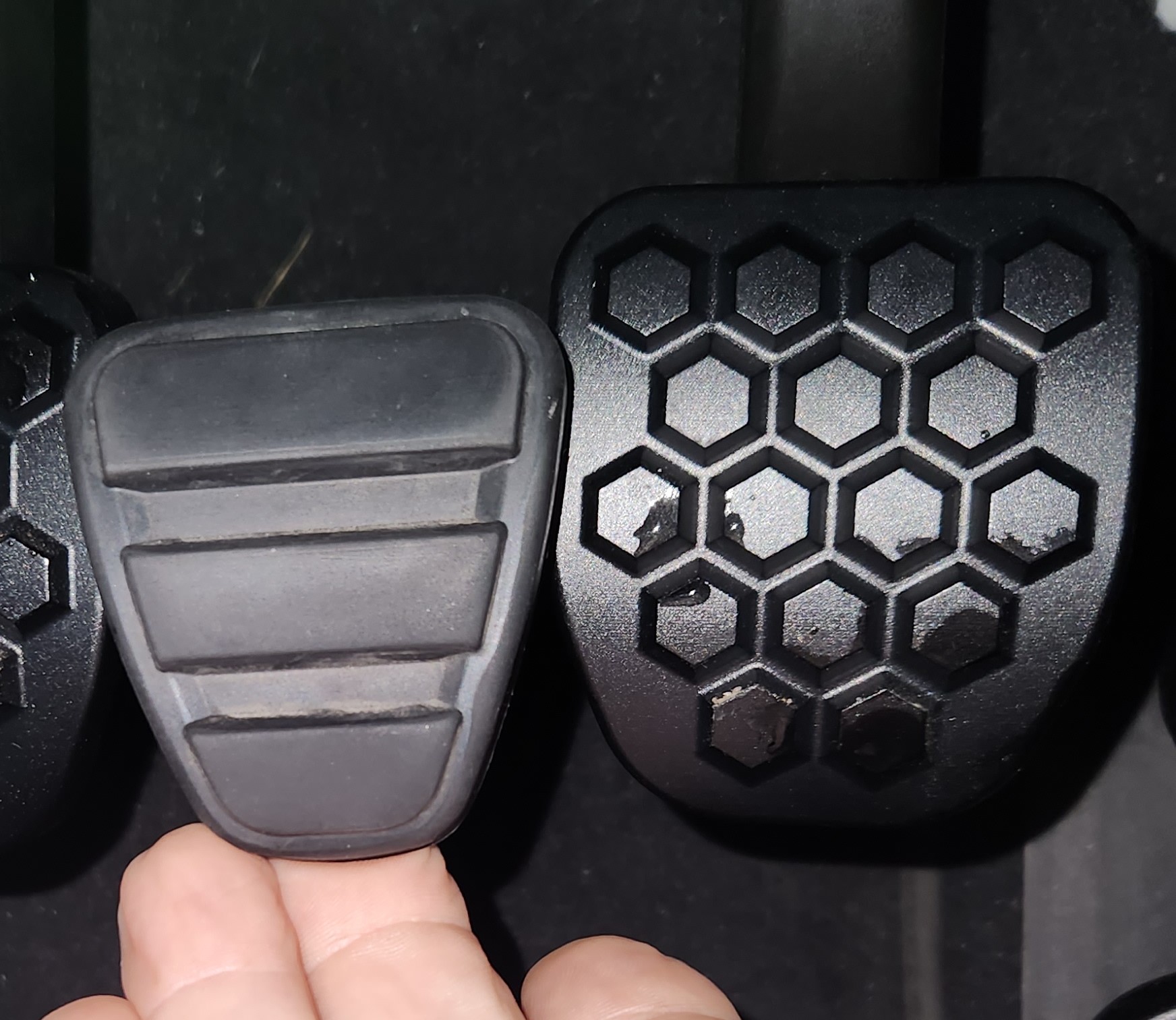

I re-installed my Numeric pedals. I'm pleased with them. Note that they are large and made of metal, not rubber like the diminutive stock units. So, appropriate footwear is a safety consideration.

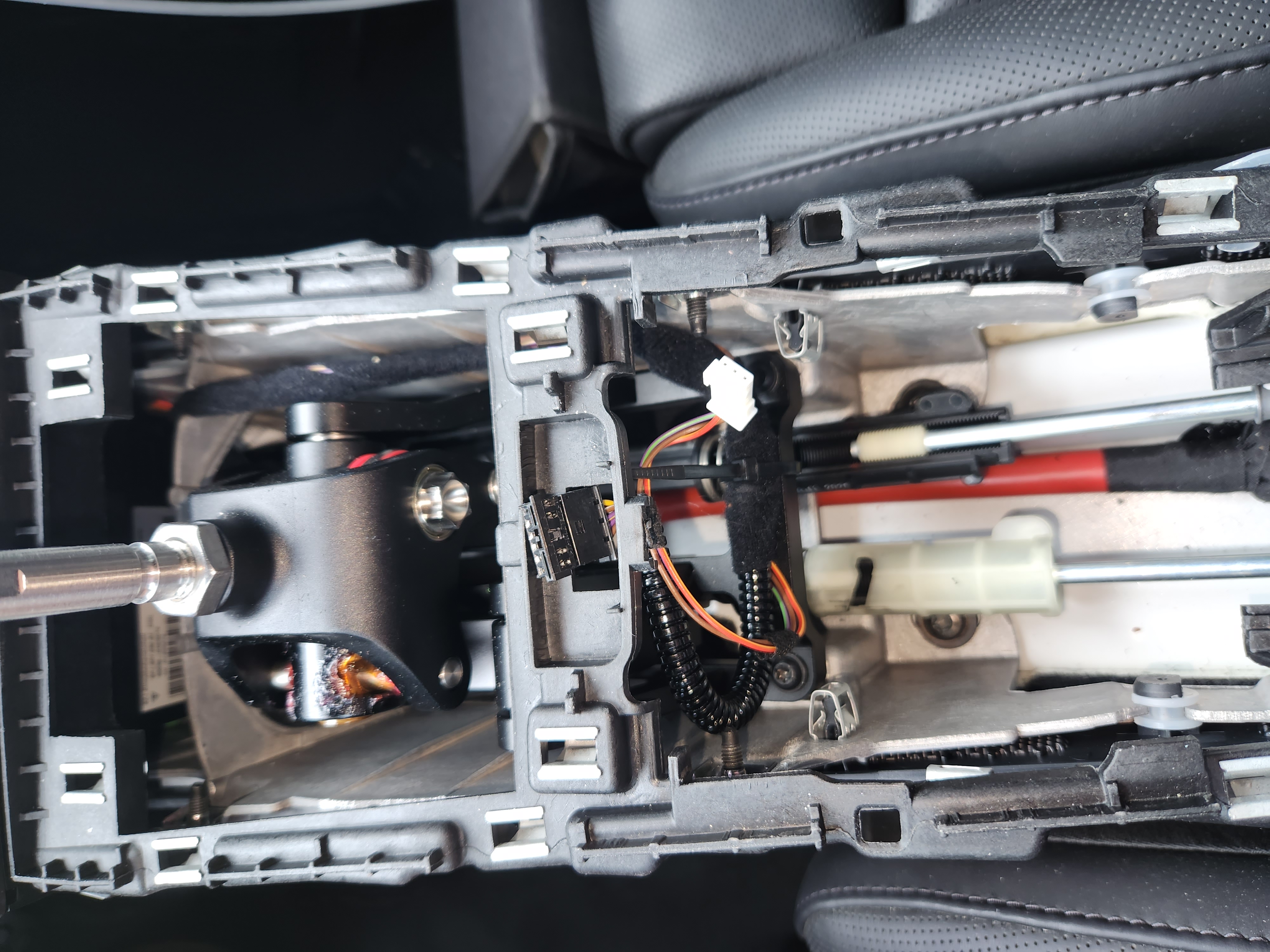

I also adjusted my shifter cables to balance the free play between Front/Rear and Left/Right. The cable tweaks cured a not-quite-right feeling in the shifter. It's an easy job to do, with a real potential benefit, and requires only a trim tool.

I installed the Numeric pedals last year. You are absolutely correct in that there is no comparison between them and the lightweight, barely adequate factory versions. (Your 'diminutive' adjective is perfect.)ReidMcT wrote: Wed Aug 07, 2024 2:14 pm I re-installed my Numeric pedals. I'm pleased with them. Note that they are large and made of metal, not rubber like the diminutive stock units. So, appropriate footwear is a safety consideration.

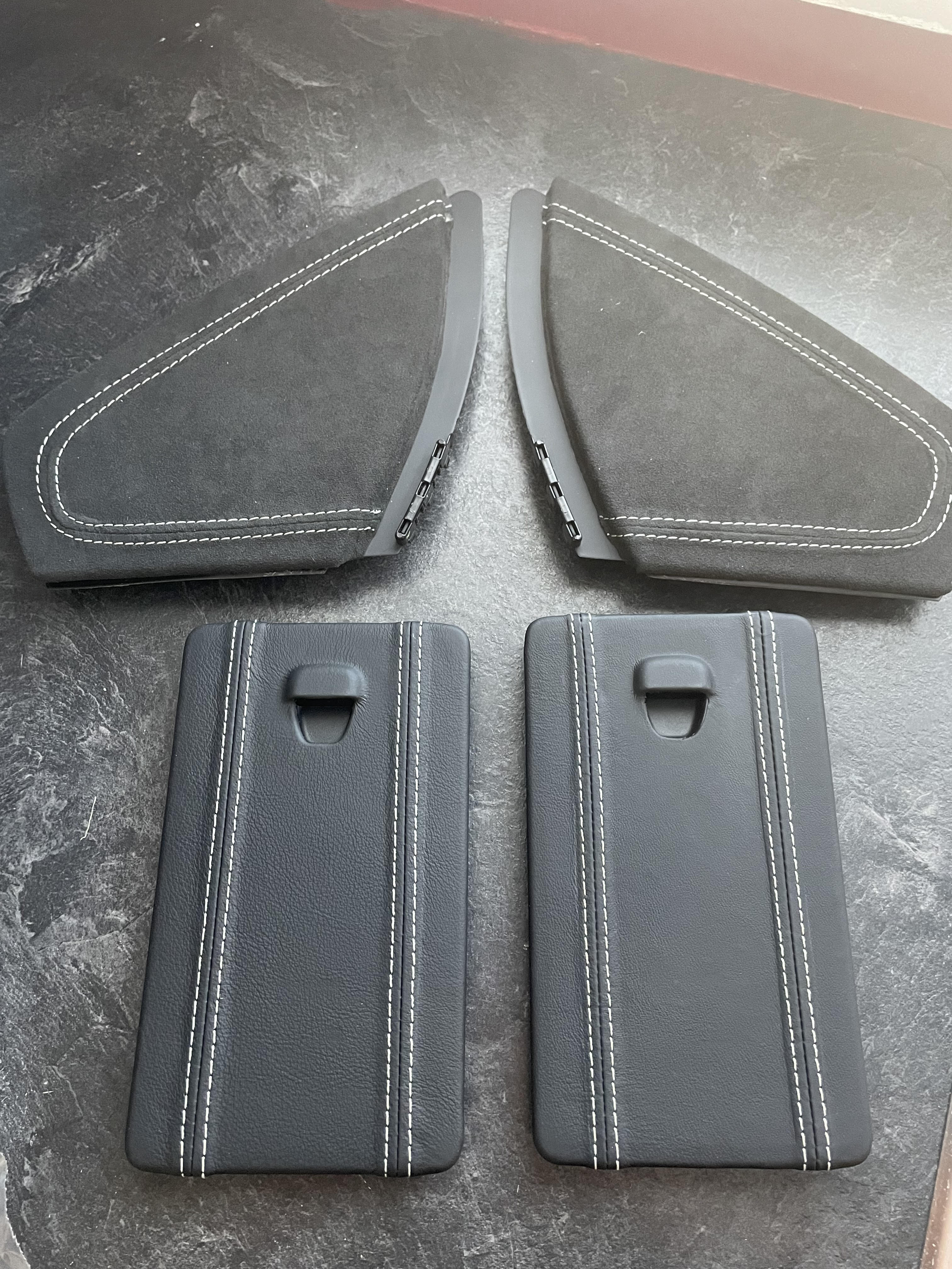

Just in from Crazy Ed.
Alcantara Dash ends & Double Stitch leather fuse box covers.
Will try putting them in this weekend.

They look great!71eh wrote: Wed Aug 07, 2024 3:31 pm Just in from Crazy Ed.
Nice job and hats off to Eddie!!

Could you describe the cable adjustment process a little bit? In another car, my VW R32, I would lock both the shift tower on the transmission and then the shifter into a fixed neutral position then adjust the cables to have the closest to zero tension. How does the Cayman compare? I have not yet seen a way to lock either the shift tower or shifter, maybe the spring tension is enough.ReidMcT wrote: Wed Aug 07, 2024 2:14 pm I also adjusted my shifter cables to balance the free play between Front/Rear and Left/Right. The cable tweaks cured a not-quite-right feeling in the shifter. It's an easy job to do, with a real potential benefit, and requires only a trim tool.

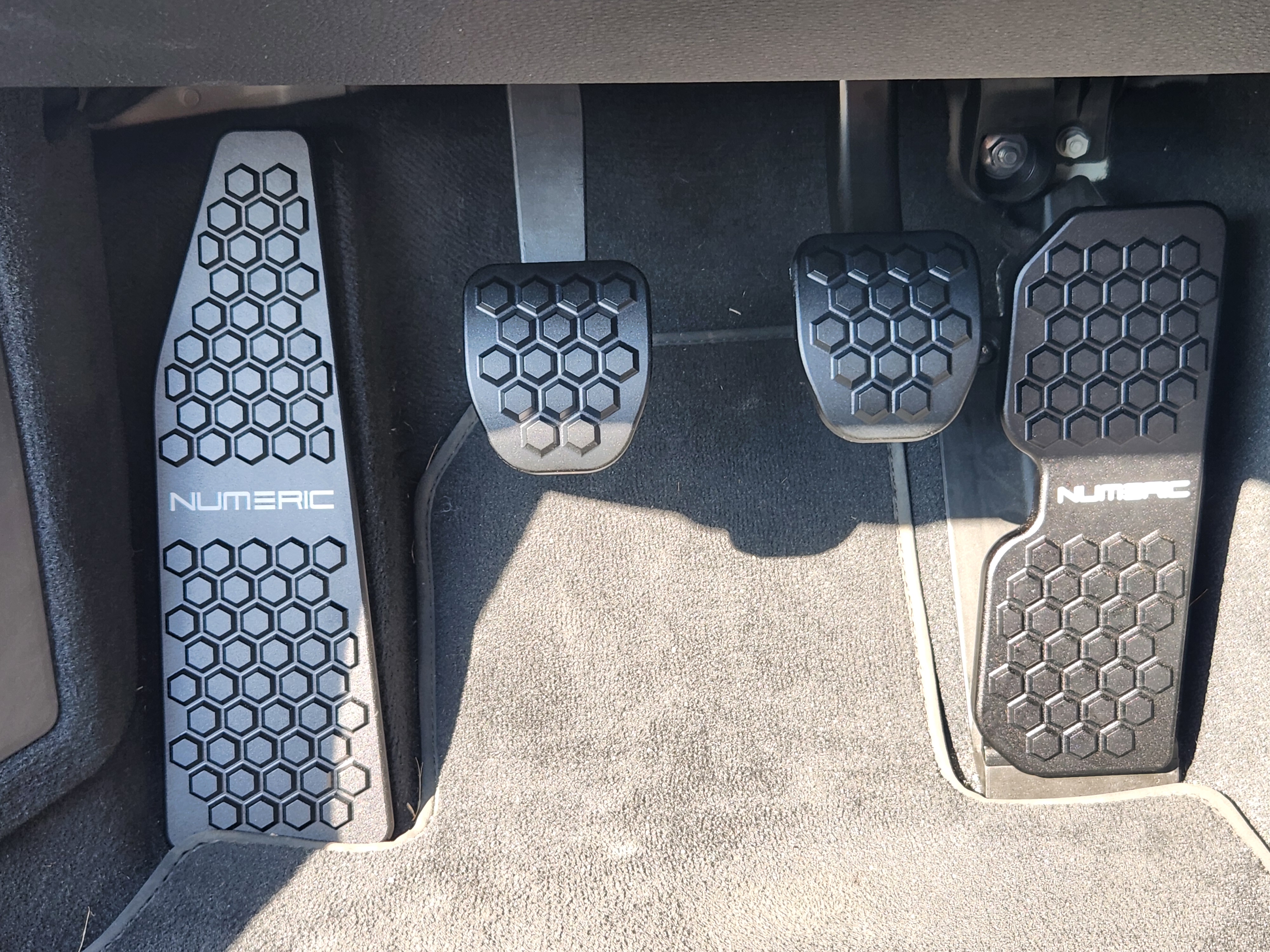

And my pic of Numeric

First, don't overthink or try to visualize it all before starting, because it's a job that you come to understand as you do it, and you will realize it is simple, really.J-Dub wrote: Wed Aug 07, 2024 7:37 pm
Porsche makes a jig to center the shift lever fore/aft, in the official position. It's unnecessary, as you will see. You can pick your own preferred tweaks. As for left/right centering of the shift lever, yes, the spring does that.
All you're doing here is popping each cable end out of its connector, finding the middle ground of free play in the cable, and then popping it back into the connector. You can test/adjust how it all feels before snapping the console back together.
If you're a worrier like me, you mark the starting positions as I did with a red pen (barely discernible in photo of right-side cable end).
