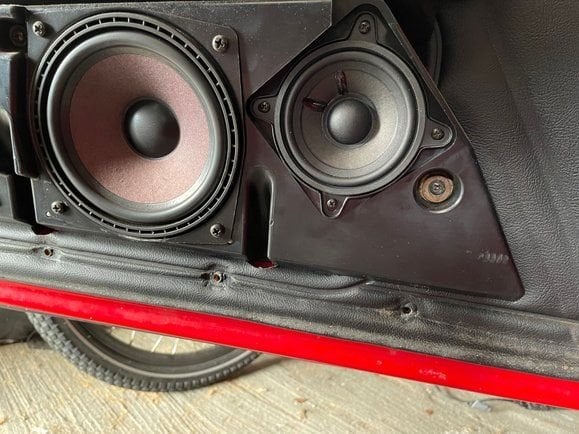

I just picked up a 3D printer for Christmas and printed these out for my '89 Turbo and they worked perfectly! Nothing better than stumbling upon the exact thread you need with a killer solution.
Curious if anyone else has had issues with their 10-speaker tweeter screens? The plastic rhombus looking part that covers the speaker. Both of mine are intact, however, the securing tabs on the back have all given up ages ago. Has anyone attempted to model an STL file on these to print? I'm a complete beginner in the 3D printer space but I have to imagine I'm not the only one who's dealing with this issue.
Thanks again to for everyone's hard work on this thread!

Sorry if this is redundant with other info deeper in the thread. I was able to find an exact fit 3” 4ohm speaker replacement for the midrange. Yes, I know it won’t be perfectly voice and level matched to the woofer and X-over, but it should be higher quality and sounds good enough to me over the wind noise. FaitalPRO 3FE22. Unfortunately, looks like they've about doubled in price since I bought mine.
edit: also the woofer surrounds were refurbed with an amazon 5.25" kit like this one. Can't find my receipt to confirm the exact kit. Really very easy to do.

My driver's side tweeter cover lost its securing tabs as well.eastersm wrote: Sun Jan 04, 2026 8:01 am Curious if anyone else has had issues with their 10-speaker tweeter screens? The plastic rhombus looking part that covers the speaker. Both of mine are intact, however, the securing tabs on the back have all given up ages ago. Has anyone attempted to model an STL file on these to print? I'm a complete beginner in the 3D printer space but I have to imagine I'm not the only one who's dealing with this issue.
I took three small pieces of 3M double sided tape and remounted the cover. When mounted it looks as good, if not better, than before the tabs broke.
I've removed and replaced it a couple of times with no damage to the cover or the vinyl on the door card.
My 944 has burgundy vinyl, so color matching a new printed cover may not be easy.
