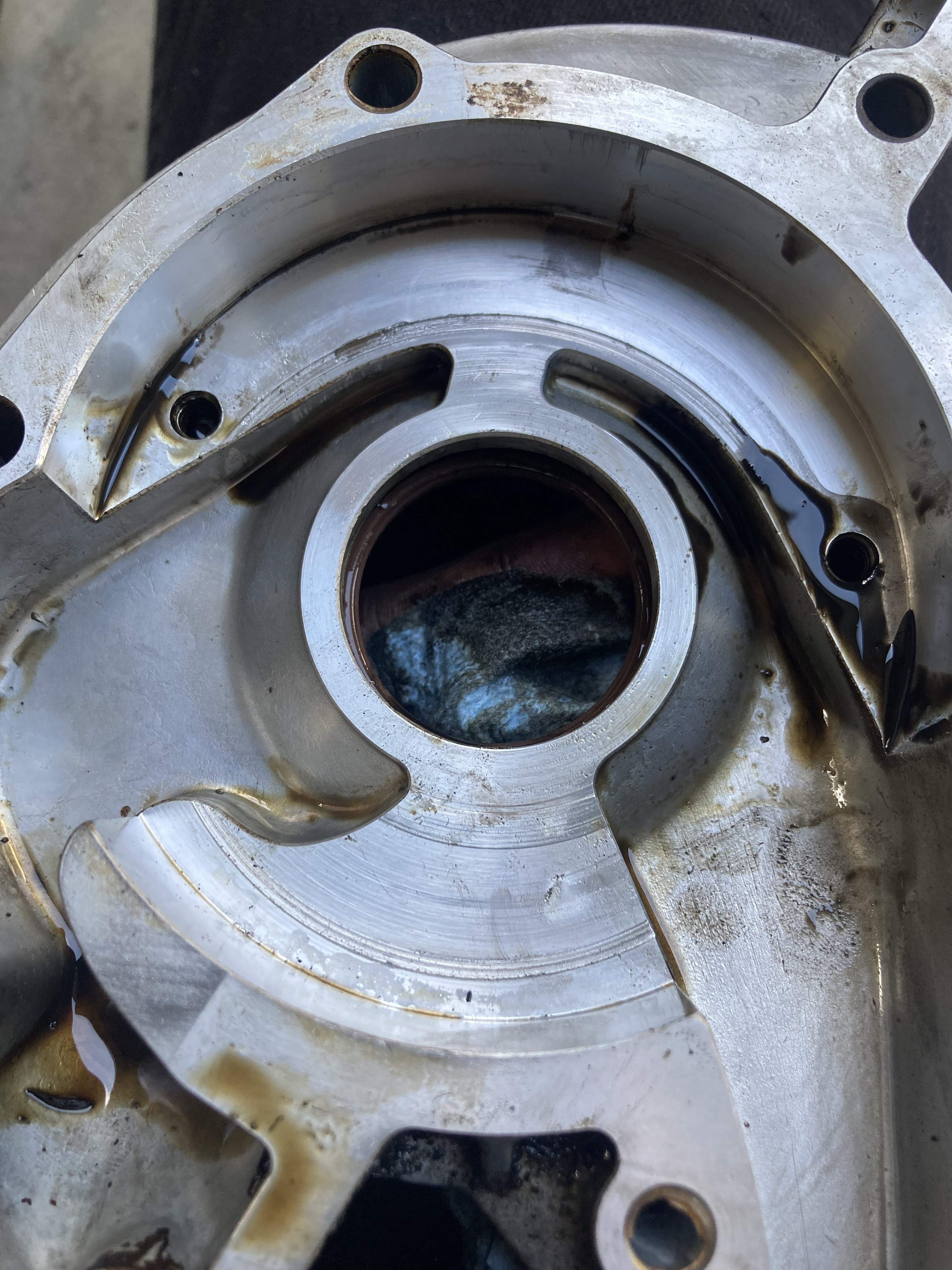

Otherwise...Finally got the oil pump apart, and well. Might get a new-to-me-one:
I think I've mentioned before the car had some kinda front end damage (in the 90s!). Externally looks fine, but the radiator bracketing is off true. There's some nice looking bosses I was planning on mounting an oil cooler to, but now if I'm to do so I need to square them up first. Would've helped if I'd taken pictures, but I was too busy being annoyed!

Any wisdom on that oil pump? it's less clear than I'd like in that picture, but there's a bit of a gouge around the outer race...I don't know if it'd be better to try and clean it up, or gamble on ebay :D
