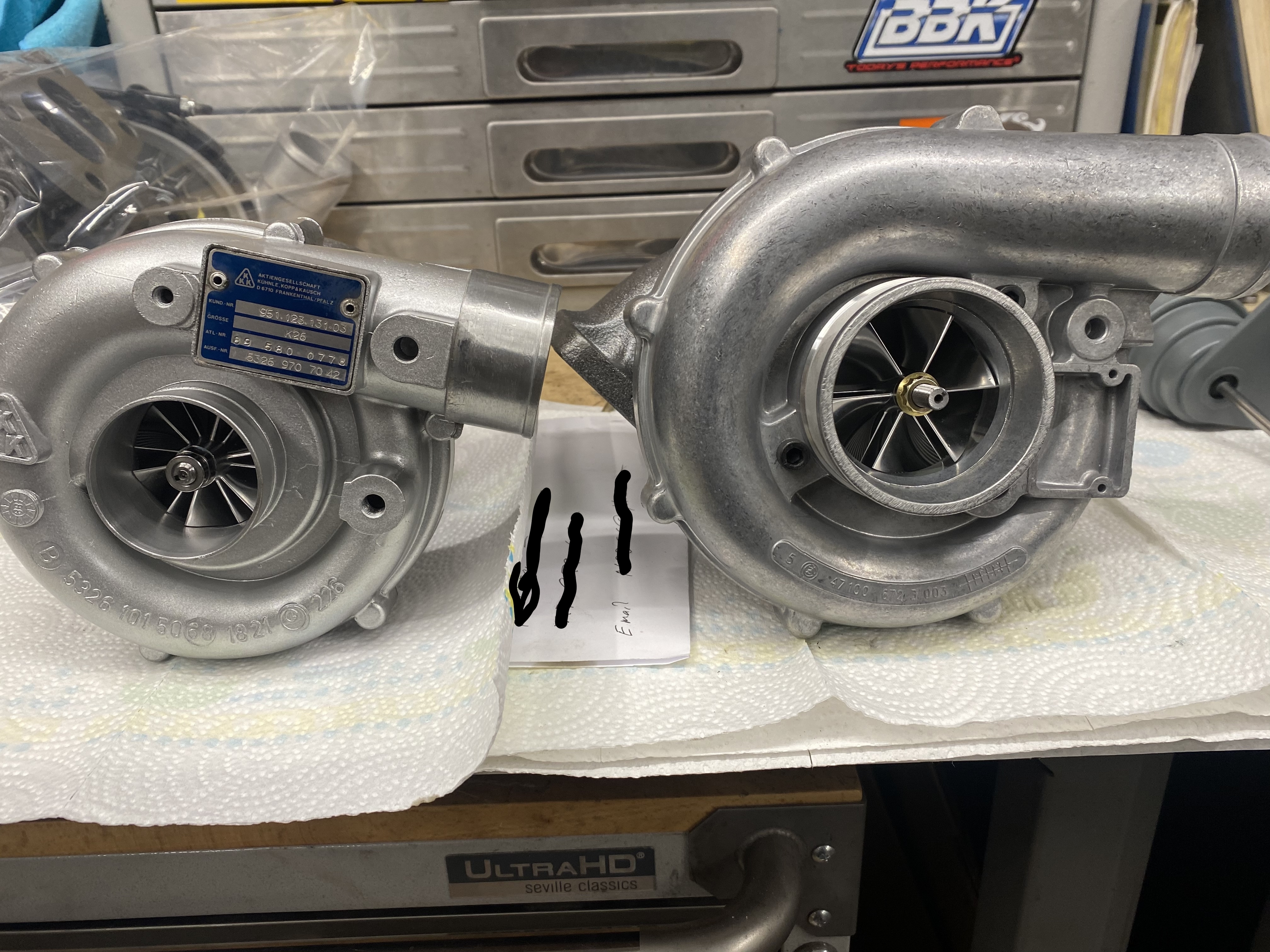

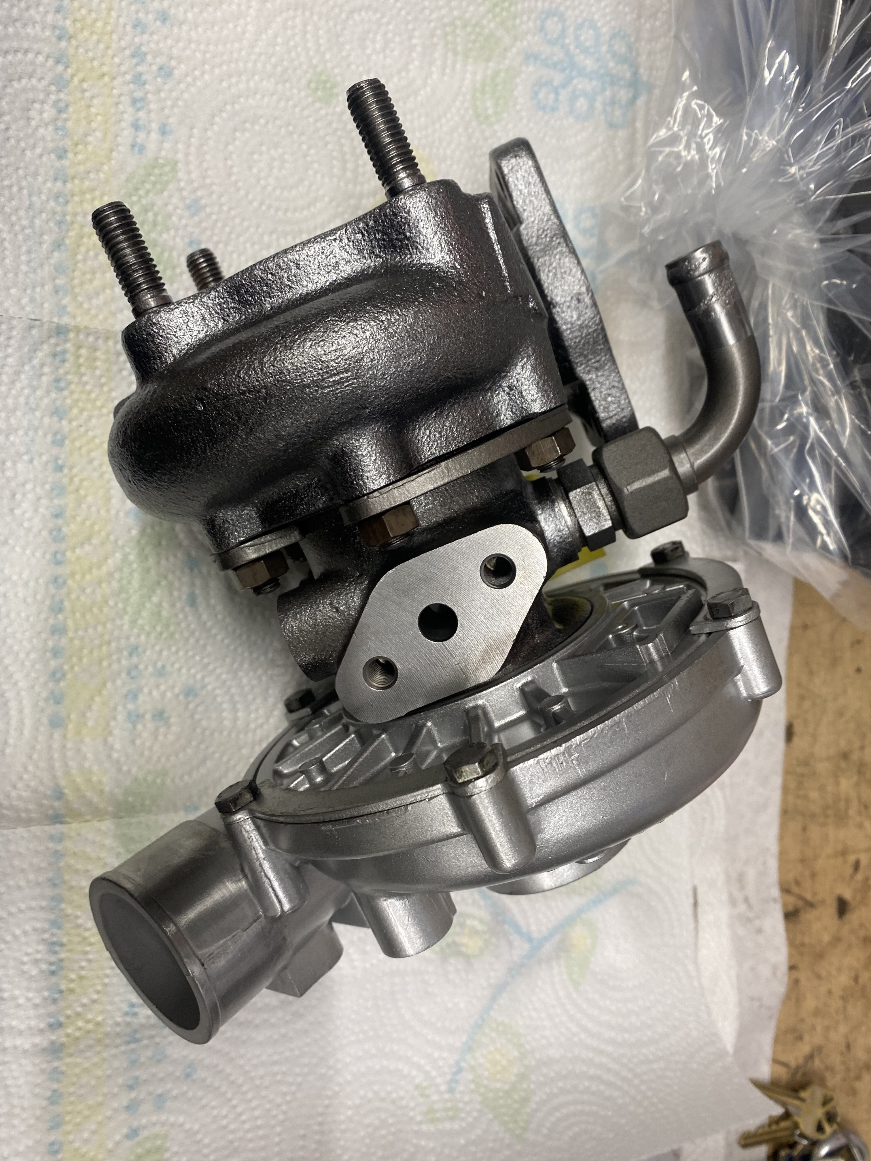

Turbo is at Evergreen getting a rebuild and some minor upgrades.

TBD if LN even has those pistons...Lots of things I've tried to order have resulted in "oh, actually we're out of stock"!
That said, every 951 rebuild thread eventually gets a "pictures from Charlie's shop" post, so here's mine!
Mine's the little guy :)
