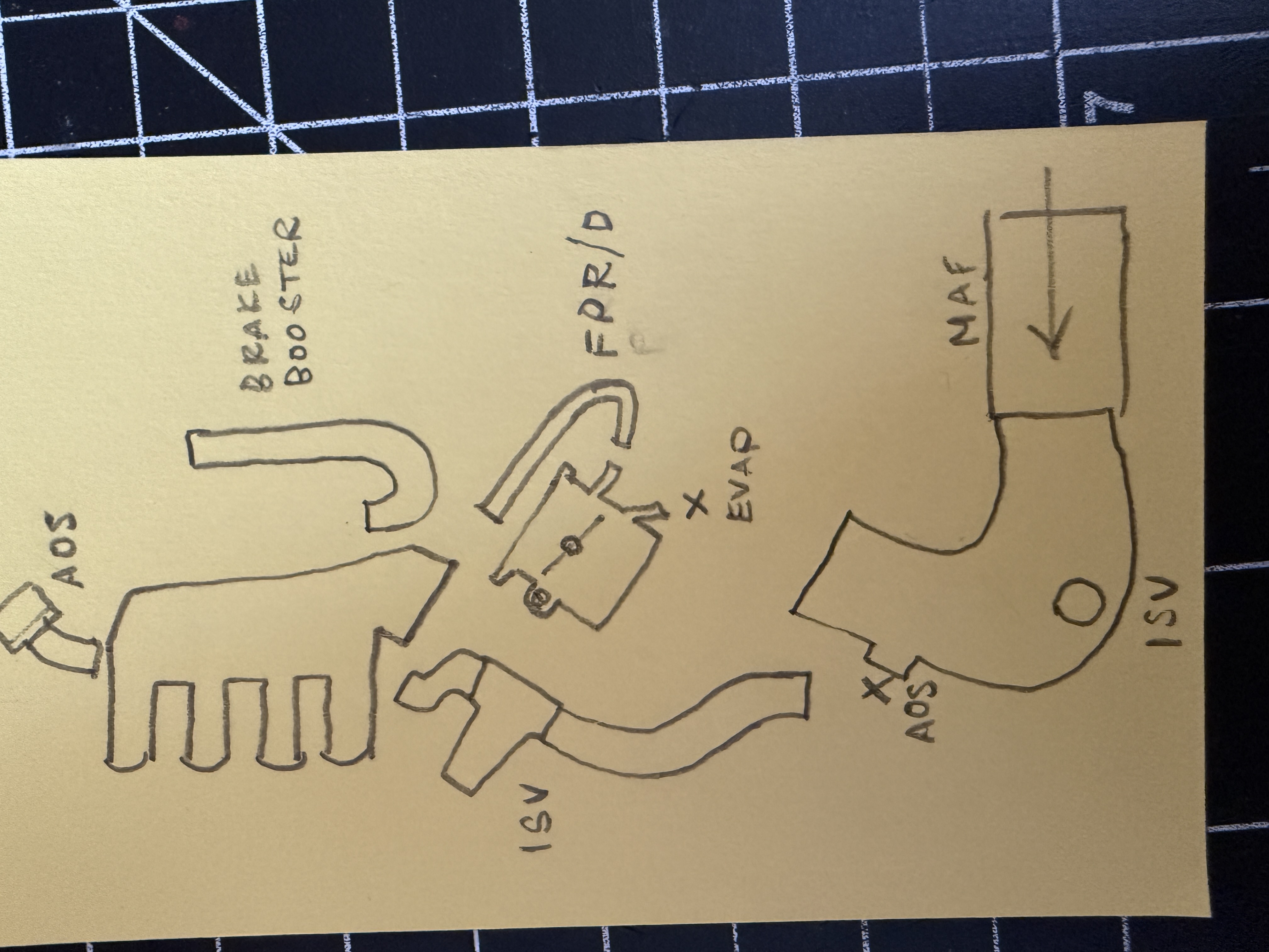

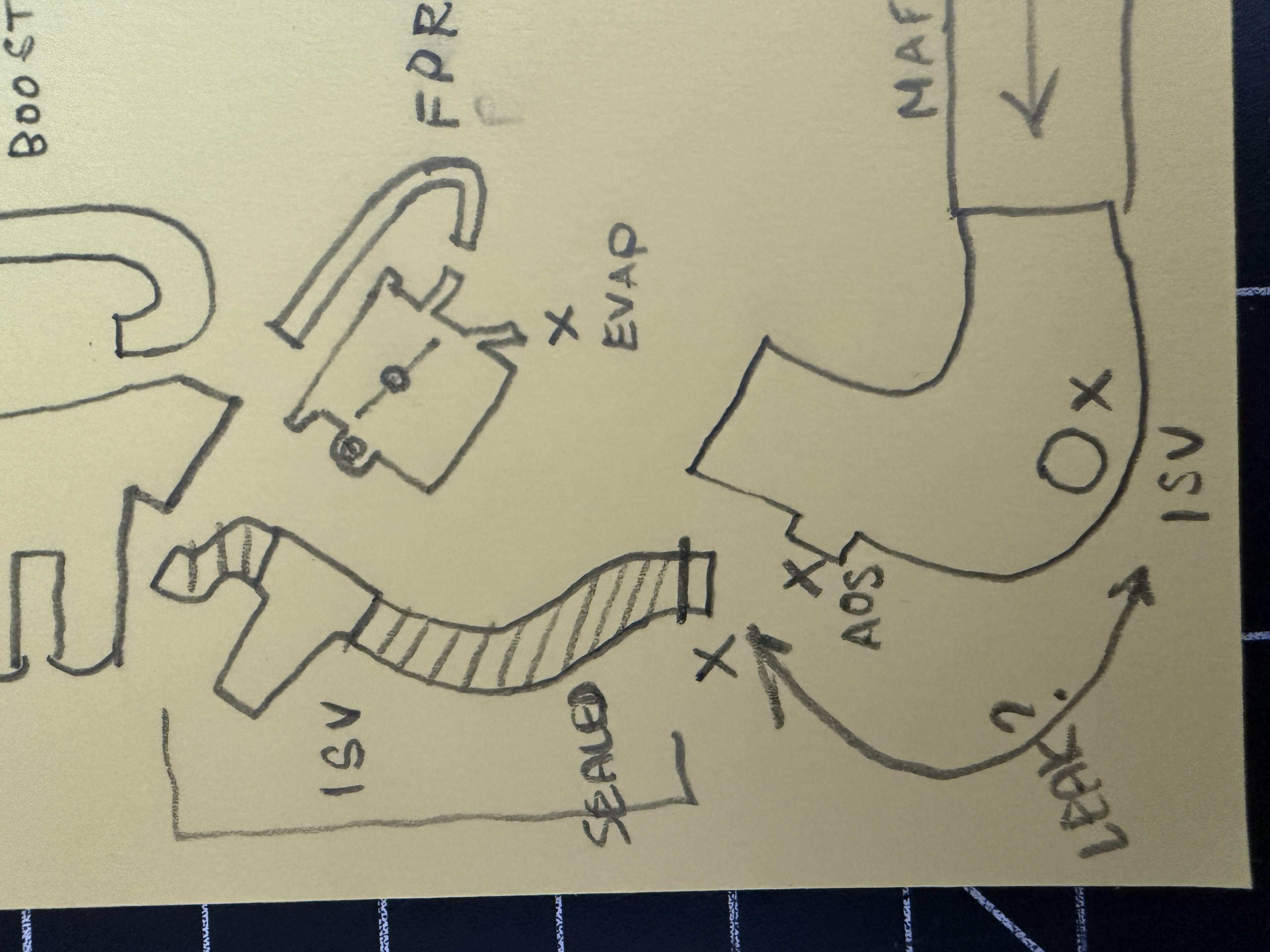

Maybe these will help? These are not lined up like in the engine, but the "X" indicates "capped" or taken out of the loop.
In this one, Im trying to show that with the ISV inlet capped, the line, ISV, and manifold connection seem to be holding and not leaking... So it was leaking from the jboot junction?
I am able to blow on it and feel air leaking! But, I went out and restored the ISV connections with a brass connector, and no change, idling at 1400rpm still. So, to me, it feels like something is commanding the ISV to open too much.

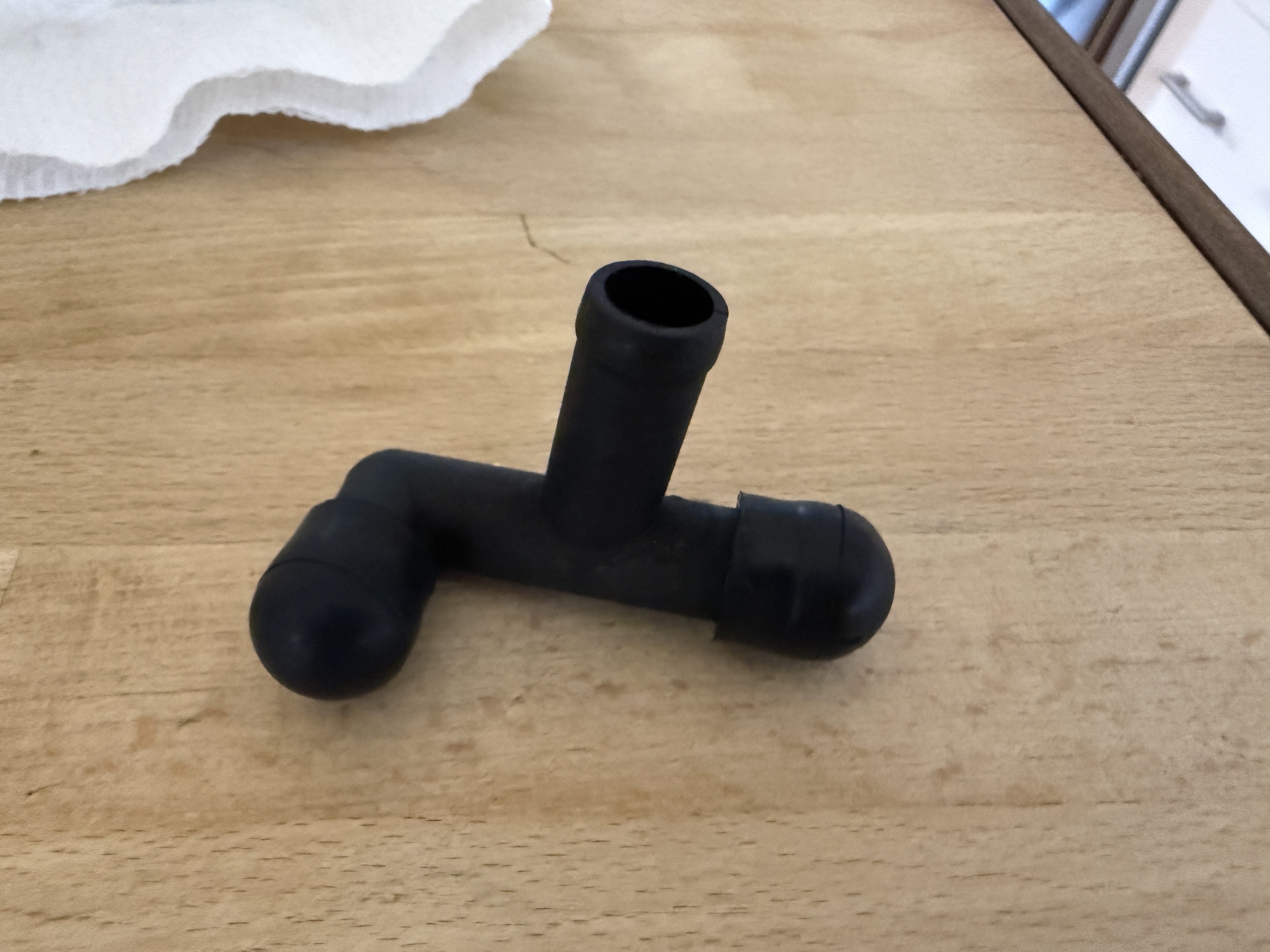

You are able to blow on what and feel it leaking?
Re: Where to look next? Feedback/advice?
Posted: Tue Nov 11, 2025 10:06 am
by spacecad3t
Tom wrote: Tue Nov 11, 2025 9:58 am You are able to blow on what and feel it leaking?
Maybe refresh? I moved the photos inline. The black plastic junction pipe. I think it's OEM, it came with the OEM hoses connected. I capped the 2 ends and blew on one 3rd, the air was coning out of one of the caps, which I had installed. So I introduced that one... but as I mentioned, restoring it all with a brass connector didn't change anything. It would have been awesome if thats all it was.
