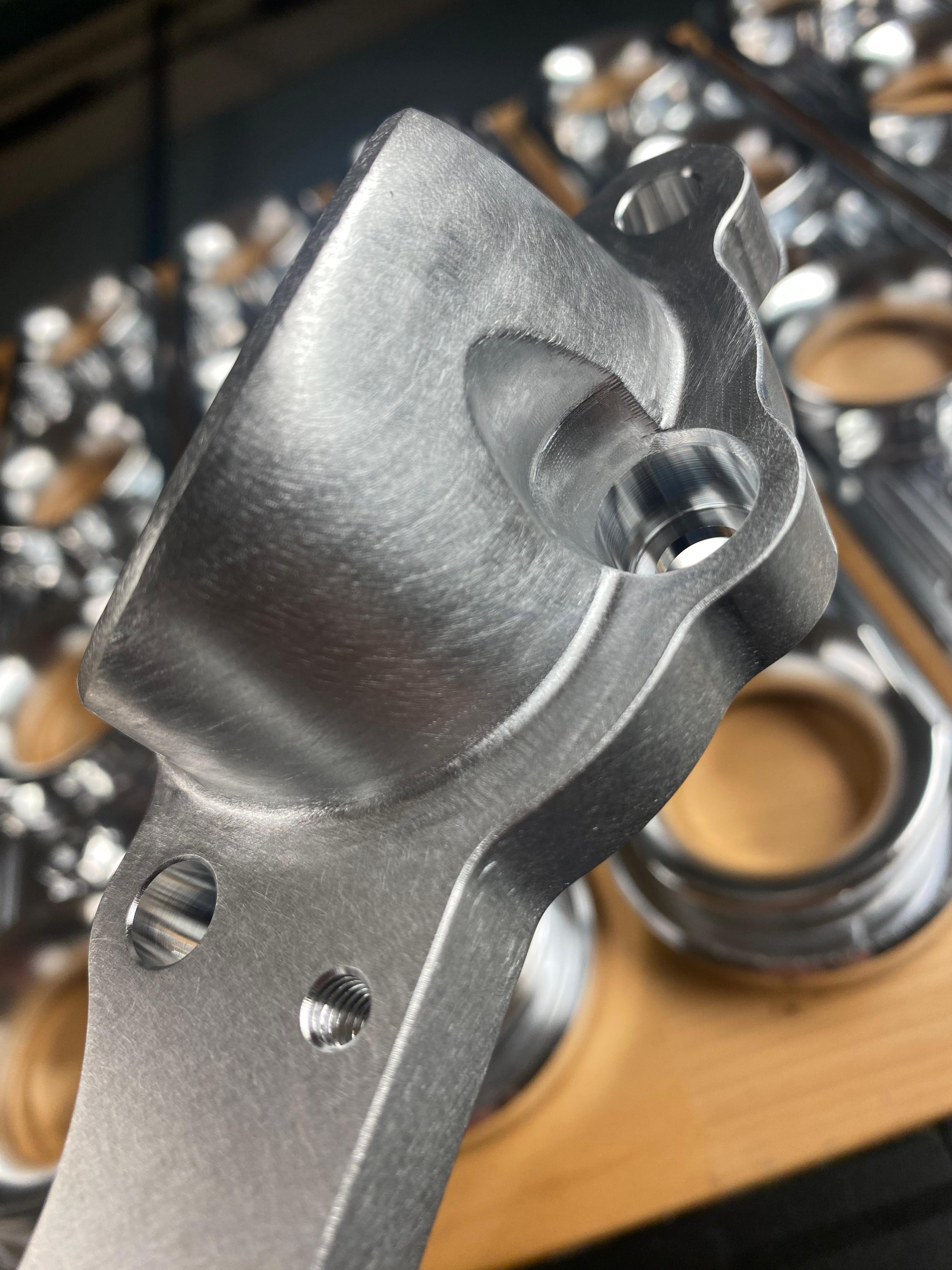

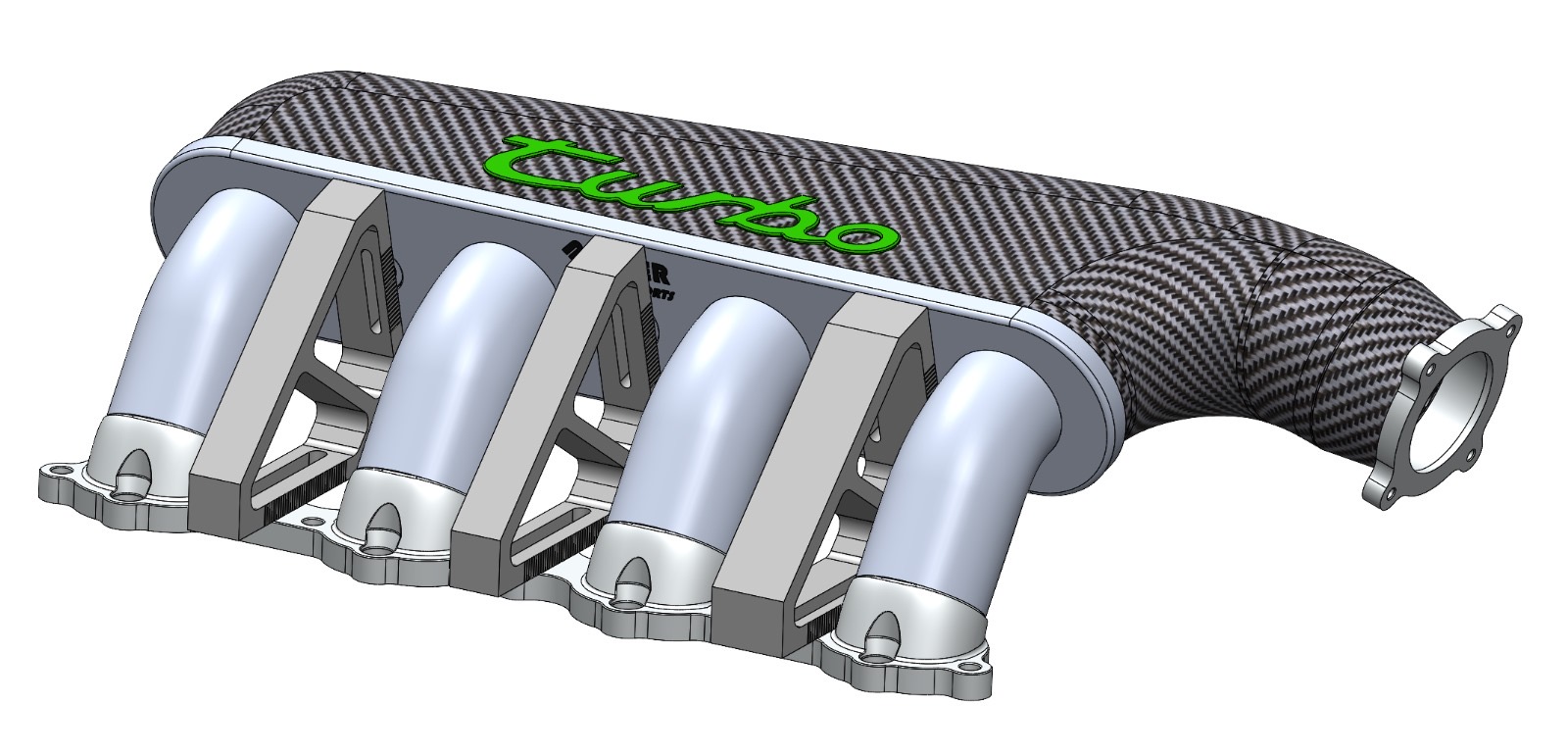

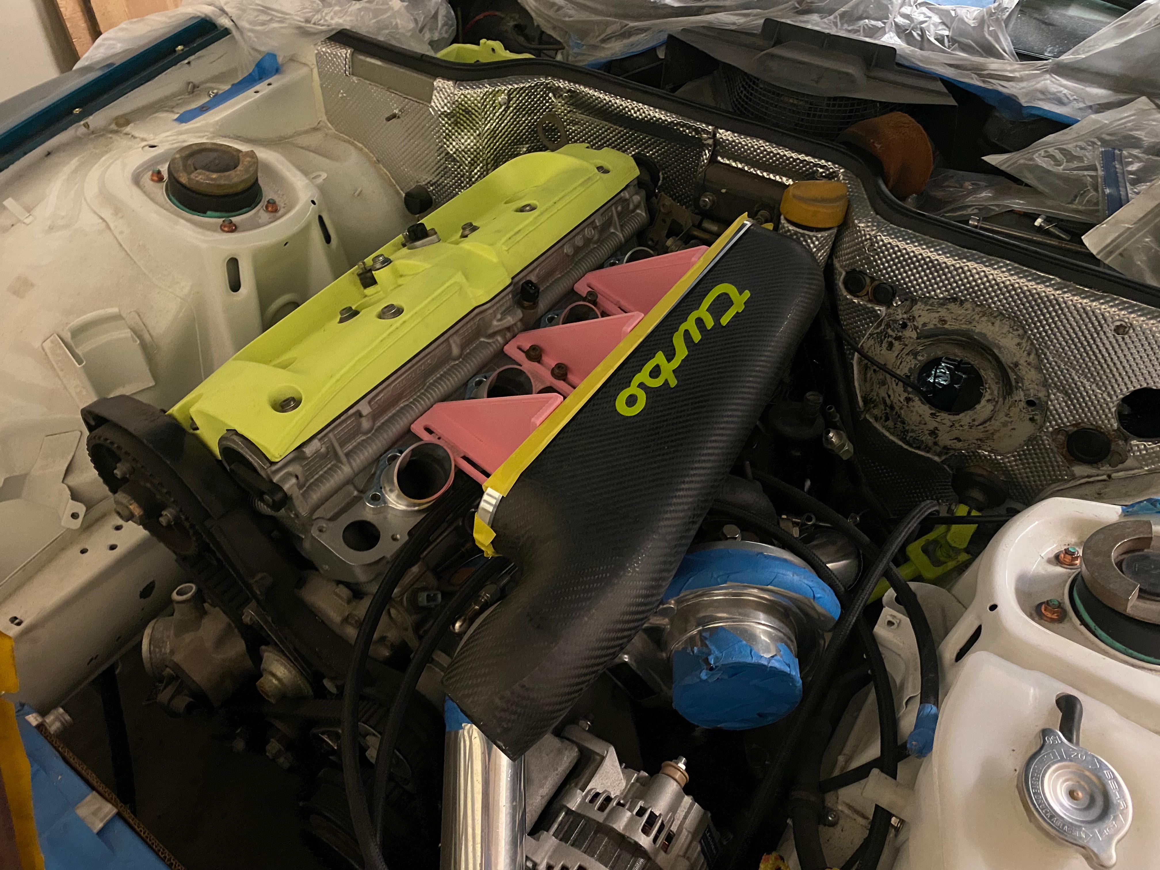

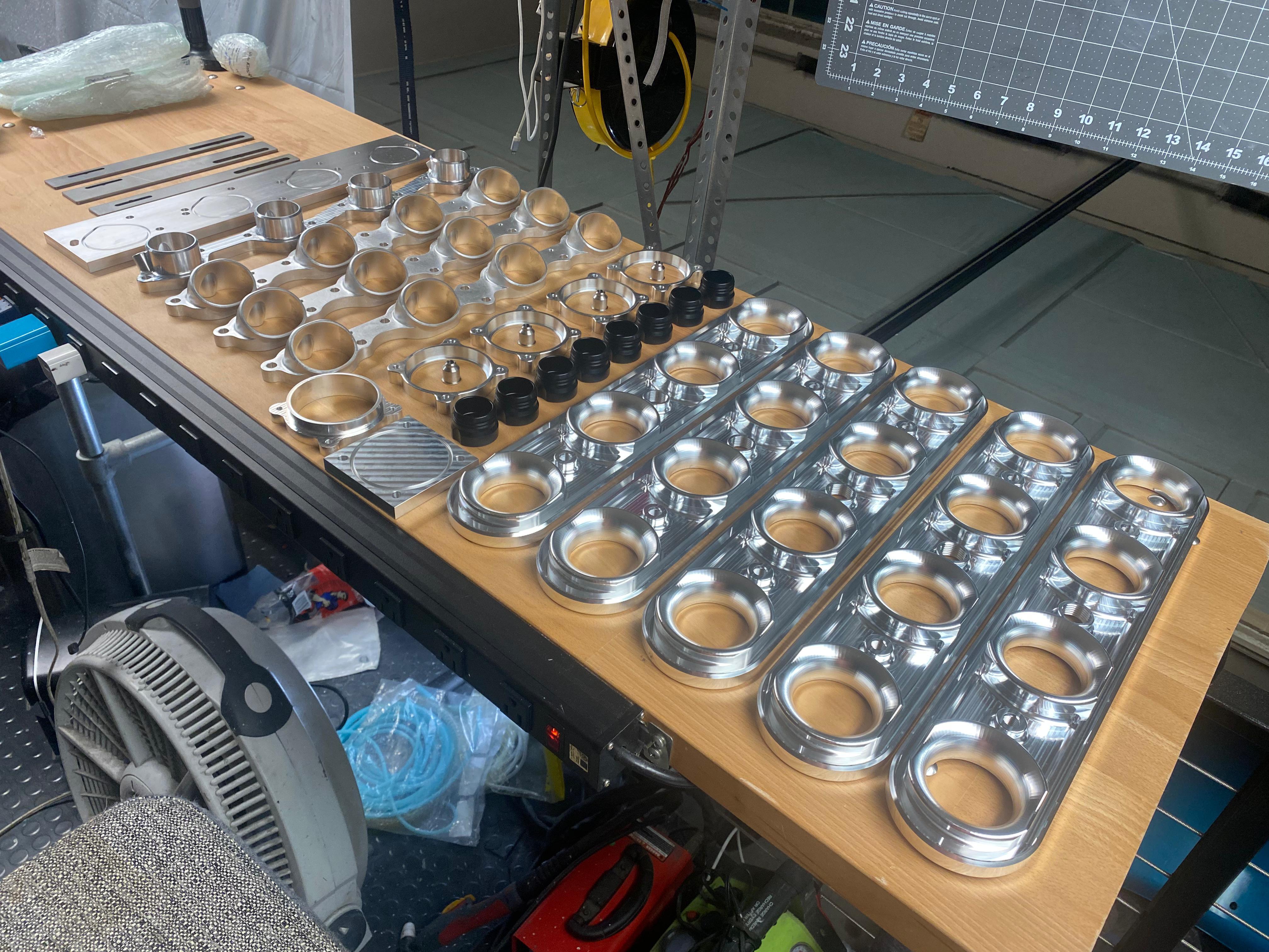

Attached some quick pictures.
First one will be finished in the next weeks!

Very nice! That will fit with the brake booster in place? Will it work with a naturally aspirated 3.Ol motor? Please post more details when you have it done. I’d be interested in the weight too, because my 968 intake weighs a ton. Thanks.
You will need to have a AOS relocate kit, but apart from that it will work.
We can also make changes if you need us to!
